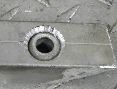

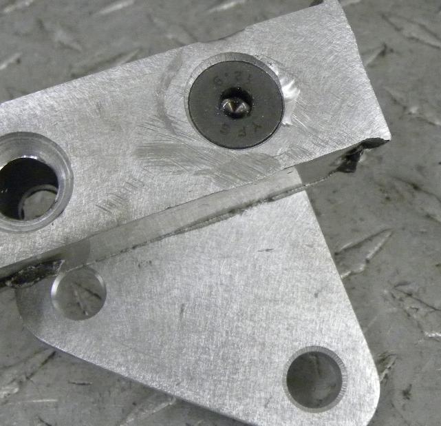

Got it welded and then assembled:
Then I put a torque wrench on it.
Set it for 30lb and started putting pressure on it.
I was never able to get the wrench to click and I started pulling the bolt through :o
Better to find out now then drill out my frame and have it ruined.
I think I will try to use a cap screw.
It will stick out slightly but it will be much stronger as I won't have to counter sink the hole.

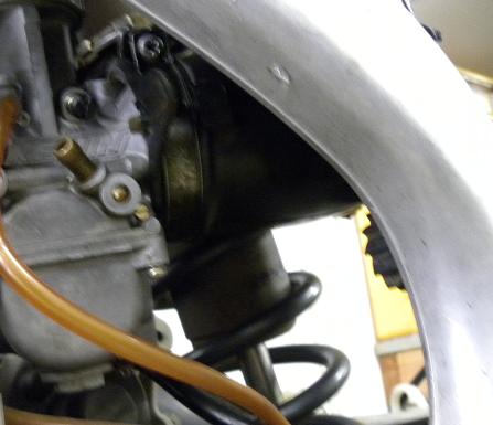

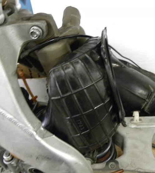

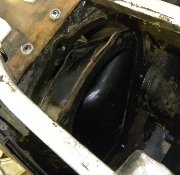

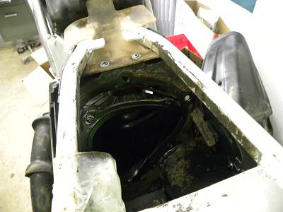

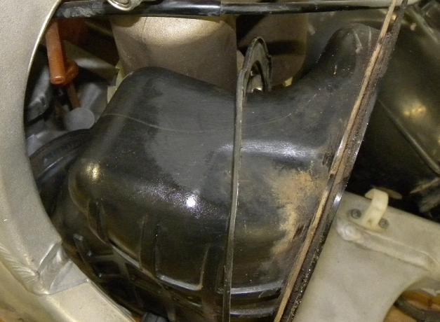

This is the latest, I am needing to adapt a air box to carburetor boot for this conversion.
The 250F air box boot is just too small for the needs of a KX500.
So I have been trying different air box boots from different bikes and so far I like the boot from a 99-02 KX250 - P/N 14073-1743.
I still haven't made up my mind for sure but so far it looks the best out of all the one's I have tried.
Here's what I am working with...
As you can see, I will need to make some sort of adapter plate to go from one to the other :o

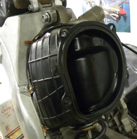

Re: BUILDING A KX500AF with a 2007 KX250F chassis
After trying several other options, I have decided on the 98-99 CR250 boot part number 17253-KZ3-J00.
It will be embossed on the left side with KZ3R.
It is just a little shorter then the 99 KX250 boot and makes the boot a little less squished when installed..
KZ3R - FITS 98-99 CR250 17253-KZ3-J00
92-96 cr250 air boot 1.JPG (38.72 KiB) Viewed 16488 times
92-96 cr250 air boot 2.JPG (39.66 KiB) Viewed 16488 times
92-96 cr250 air boot 3.JPG (47.7 KiB) Viewed 16488 times
92-96 cr250 air boot 4.JPG (42.26 KiB) Viewed 16488 times
It isn't a perfect fit but it is certainly good enough and the best I have found so far...
Of course either will work but you will need to make an adapter..
More on that later.

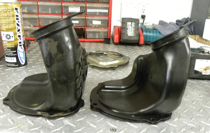

Just received my 2000 CR250 air box boot today and it is very close to the 98-99 CR250 boot but the 2000 is just a little slimmer and a bit more refined.
So that means I will be using the 2000 boot unless I find something better I like.
The 98-99 boot is on the left and the 2000 is on the right.
98-99 VS 2000 cr250 air box to carburetor boot 1.JPG (61 KiB) Viewed 16482 times
98-99 VS 2000 cr250 air box to carburetor boot 2.JPG (51.89 KiB) Viewed 16482 times
98-99 VS 2000 cr250 air box to carburetor boot 3.JPG (49.53 KiB) Viewed 16482 times
98-99 VS 2000 cr250 air box to carburetor boot 4.JPG (40.06 KiB) Viewed 16482 times

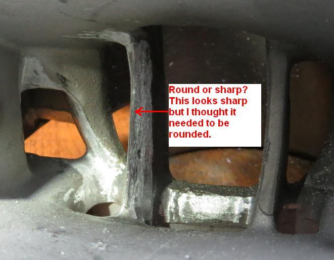

porting 1.JPG (42.44 KiB) Viewed 16390 times
porting 2.JPG (36.31 KiB) Viewed 16390 times

I'm sure you probably know why Mo is wanting the leading edges round. http://www.teachengineering.org/collect ... dl_dwc.pdf
The Idea is to get that Laminar flow we talked about previously over those leading edges, and possibly Mo has info on how to direct that flow to specific spots in the Cyl.. I know it's not the most exiting part of engine work, but stick with it!

Here is some pics I sketched out last week to show what I am attempting to do.
CROSS SECTION A.JPG (16.98 KiB) Viewed 16372 times
CROSS SECTION B.JPG (27.4 KiB) Viewed 16372 times
I use to build and fly RC aircraft.
The P51 Mustang is one of my favorite aircraft and I use to play with laminar designs :D
Back to the cylinder, Motorrad has been helping me and I have been using his pics as a guide.
The problem is that it's hard to see curved or angular surfaces in pics so I have been asking him 1000 questions a day :o
I'll post some of my questions later.
And your right, there is huge rewards in this, so while I am nervous about it and it can be tedious, it's also fun.
And, this is a practice cylinder.
If it looks good when done I'll get it plated.
If not, well someone will want it, or maybe I'll cut it up and use it for demonstration purposes :o
