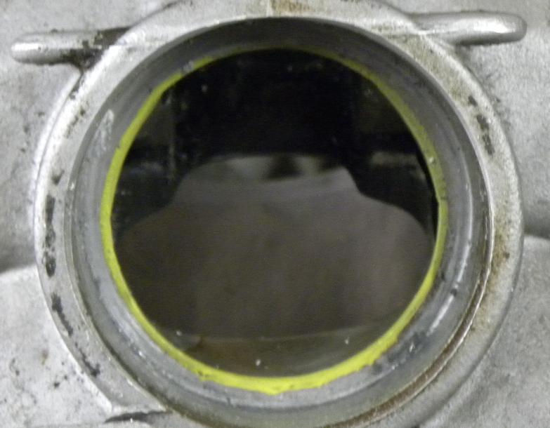

Ok, back on clean up...
This is how much material is blocking off the exhaust port from the exhaust pipe.
What do you think, leave it or remove it?
I'm leaning toward removing it...

You most of the time you want a 2-3mm smaller port then header id size. Most of the headers for the K5 motor is too big the first three inches. for the rpm and spec that most K5 motors run you want are 45-46mm port for great velocity. you can pick up as much as 2-4hp in the middle of curve with that set up and a taper header.
