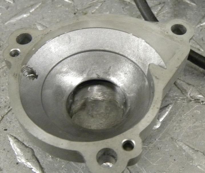

For now here is a pic of the inside of the cover for my sand bike.
Modified.
KX500 WATER PUMP IMPELLER CLEARANCE 7.JPG (56.86 KiB) Viewed 15976 times
Not modified:
It feels a lot smoother then it looks.
And yes, it is a bit harder to do it on a full cover rather then the experimental 1/2 cover but by no means impossible.
It took me 10 or 15 minutes to get it about as good as I can get it.
