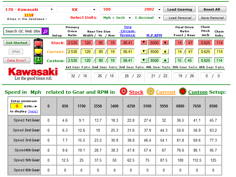

End of next year there's finaly a Beachrace. So I need a Overdrive grin
I want to go faster than 200km/h (125mph).
Dutchiie
Re: KX500 WR or overdrive transmission, is it possible?
Posted: Sun Nov 30, 2014 7:56 pm
If the gearing works out and you can pull 8500 RPM in the new 5th gear, you will need to run a 15/45 sprocket set up.
kx500 over drive transmission oem-cycle.com 103.png (59.58 KiB) Viewed 4643 times
