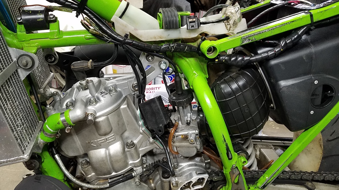

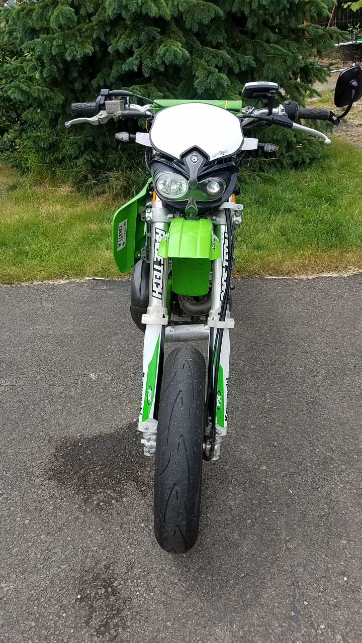

Fired!
Today I ran 3 heat cycles and took her out for a 2 mile and then a 10 mile ride..
To lean for the current compression and fuel but I can fix that 8-)
Ready for some dyno work..

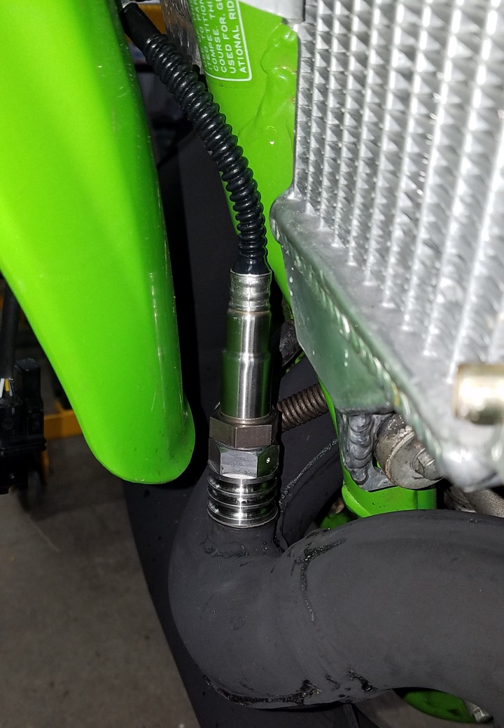

Re: KX Guru Racing JT Engine Works KX500 Turbo Crank testing
Posted: Sun Jun 14, 2020 11:49 pm
Yep... Let's get our jetting dialed in :-)
NO, the 02 Sensor will not be a permanent addition.
It's there to get the jetting dialed in and then the EGT will go in to get the jetting really, really, dialed in... 8-)

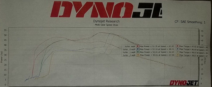

Re: KX Guru Racing JT Engine Works KX500 Induction Crank testing
Posted: Sat Jun 27, 2020 4:58 am
Just back from the dyno.
What did we do?
Stock carb
Stock ignition
Stock reed
Stock pipe
Stock muffler w sparky.
Reduced port timing
Bumped compression

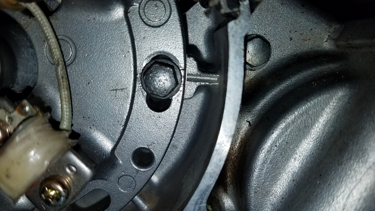

Stock Ignition on the center mark. Turns out that is where we made the most power.
Straight C12 with Motul 800 at 50:1
7-1-20 for posting.jpg (255.16 KiB) Viewed 15403 times
What did we learn?
1. My jetting is still too fat by one or two sizes on the main and that much or more on the needle..
2. The stock ignition makes almost two more hp over the Power D at the timing specs given by the manufacture. So eventually I need to get around to making new Power D timing measurement for the KX500.
3. Ignore the 50 hp... That will do nothing but increase... But look at the power curve.. Do you notice anything interesting?
It looks much more like a 4 stroke :o
So stay tuned as we will be gaining a lot more HP with simple bolt ons...
Then we will advance the port timing in steps...
And at the end of this... Then I will do some port work...
So stay tuned...

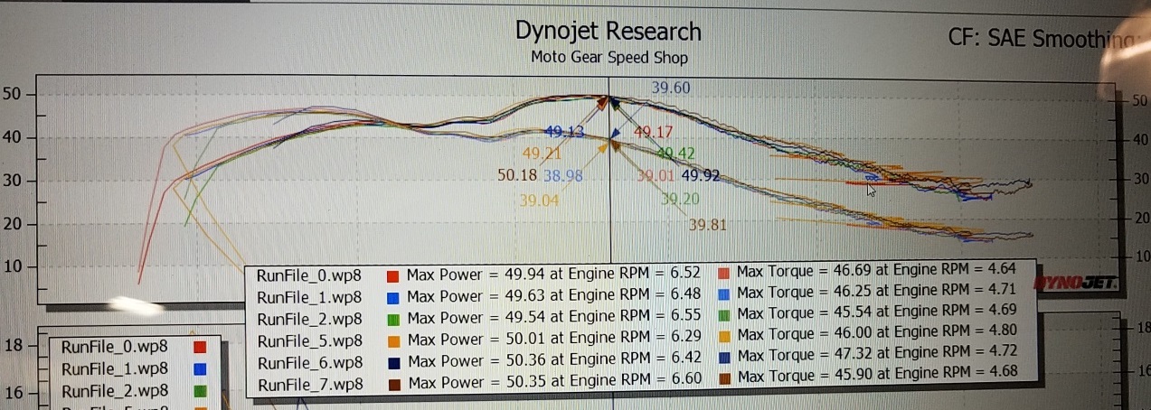

Posted: Thu Jul 09, 2020 4:14 am
Ok, that's it for this port timing.
We did make a few more ponies and I could keep splitting hairs but it is not worth the expense and time..
Time to bump it up to stock timing.
Posted: Sun Jul 12, 2020 1:40 am
by Brute
Fun stuff! It is good to see the bike getting put to good use! Interesting that the stock ignition seems to work better. It will be fun to see the numbers when you test the Power D set up.
Posted: Sun Jul 12, 2020 1:55 am
Yep... Alex is going to play with it and verify the numbers we have to try.
It should be interesting :-)
