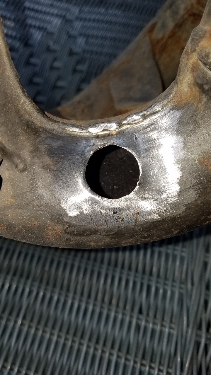

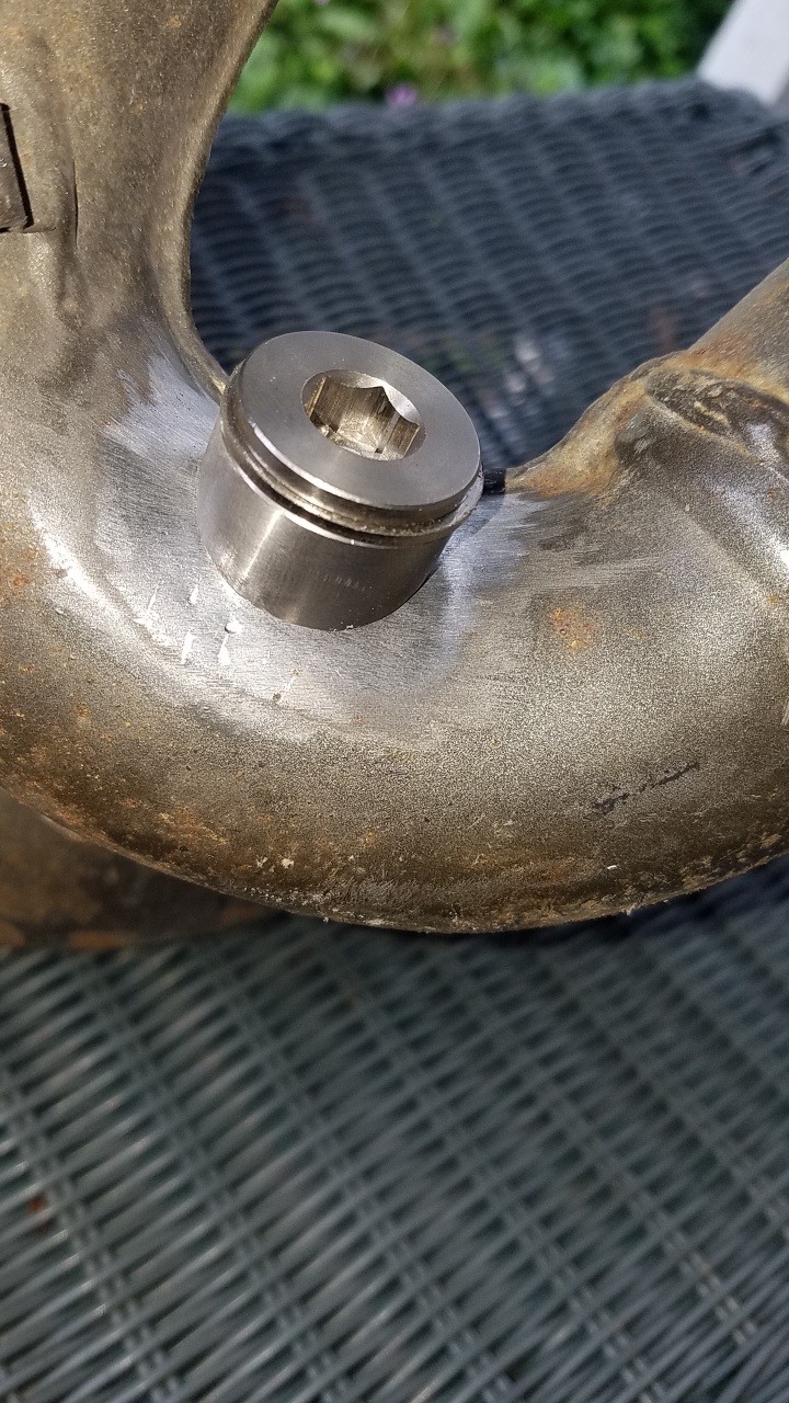

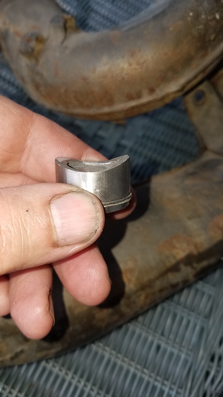

I pulled a stock pipe from inventory and got busy..
Re: KX Guru Racing JT Engine Works KX500 Turbo Crank testing

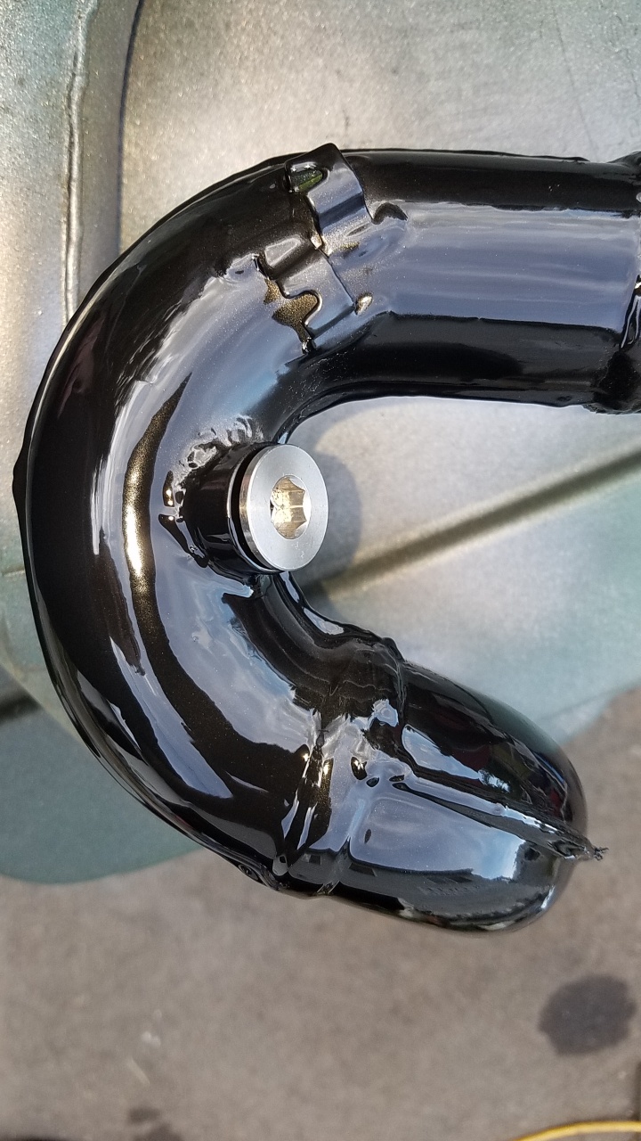

Next I'll get it sandblasted and get some paint.
I'm not sure about the color yet..

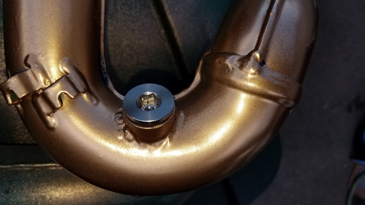

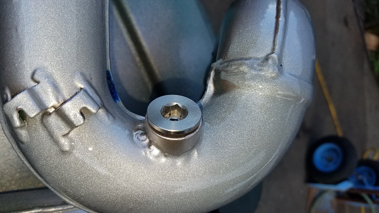

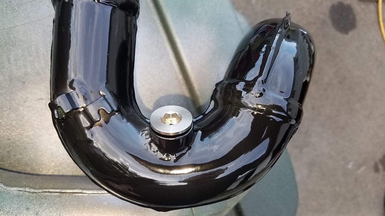

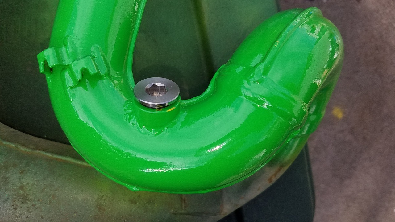

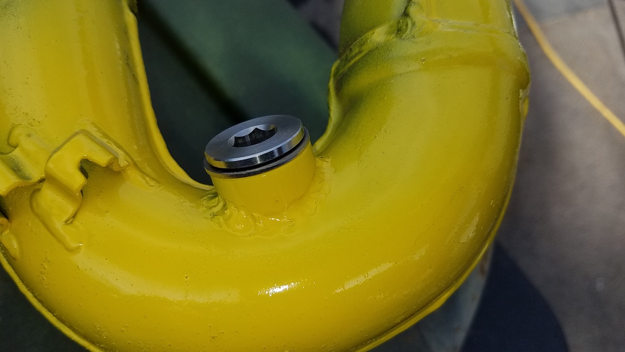

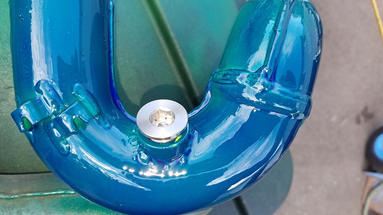

Ok.. sanded and painted the pipe and will call it good for now.
After all the testing and tuning this bike will go through I'll be doing a FULL rebuild from the frame up.
But for now this will work.

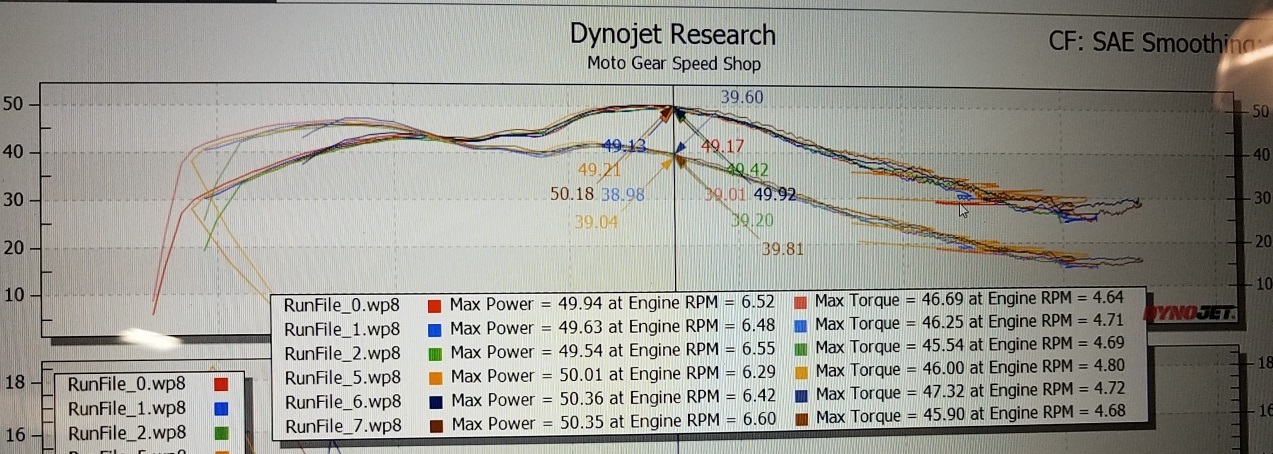

Just back from the dyno.
What did we do?
Stock carb
Stock ignition
Stock reed
Stock pipe
Stock muffler w sparky.
Reduced port timing
Bumped compression

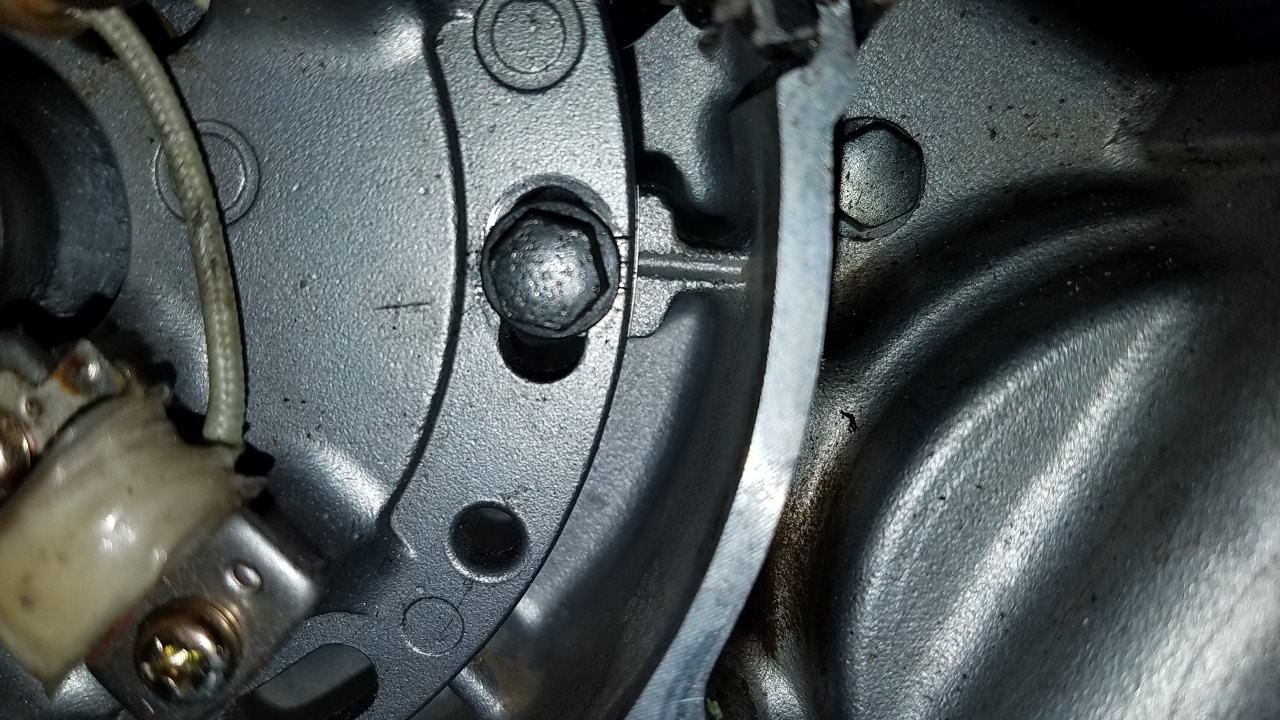

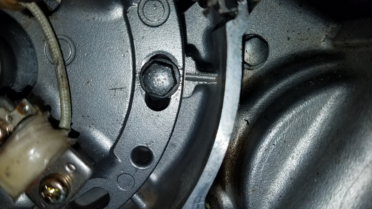

Stock Ignition on the center mark. Turns out that is where we made the most power.
Straight C12 with Motul 800 at 50:1
7-1-20 for posting.jpg (255.16 KiB) Viewed 15393 times
What did we learn?
1. My jetting is still too fat by one or two sizes on the main and that much or more on the needle..
2. The stock ignition makes almost two more hp over the Power D at the timing specs given by the manufacture. So eventually I need to get around to making new Power D timing measurement for the KX500.
3. Ignore the 50 hp... That will do nothing but increase... But look at the power curve.. Do you notice anything interesting?
It looks much more like a 4 stroke :o
So stay tuned as we will be gaining a lot more HP with simple bolt ons...
Then we will advance the port timing in steps...
And at the end of this... Then I will do some port work...
So stay tuned...
