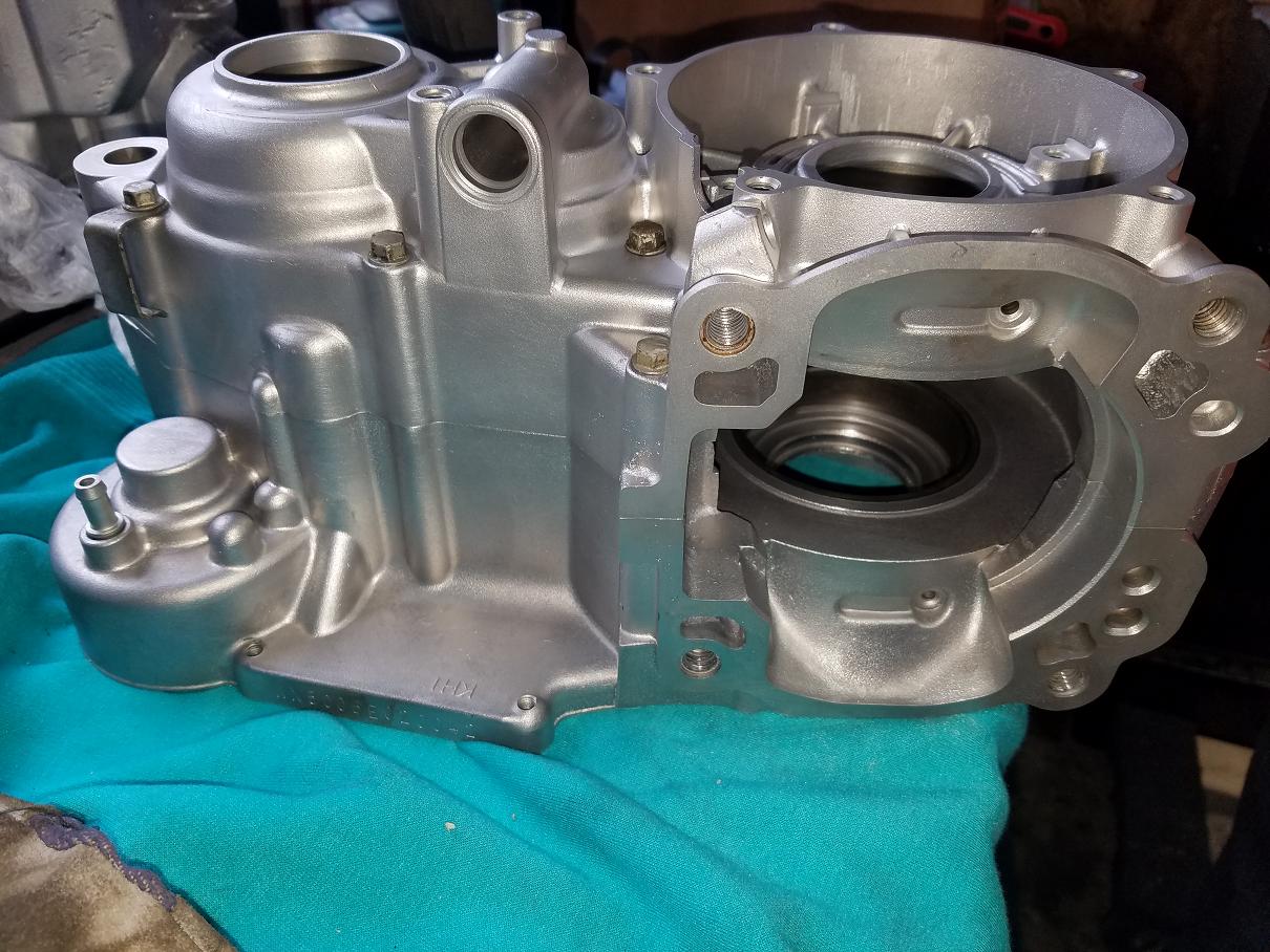

After lapping we installed the alignment pins and mated the cases together.
KX GURU RACING SEAN COLLIER KX500 204.JPG (190.41 KiB) Viewed 16321 times
Jason is holding the cases up to some light so he can check the cases for any air gaps... NONE :ugeek:
KX GURU RACING SEAN COLLIER KX500 205.JPG (82.26 KiB) Viewed 16321 times

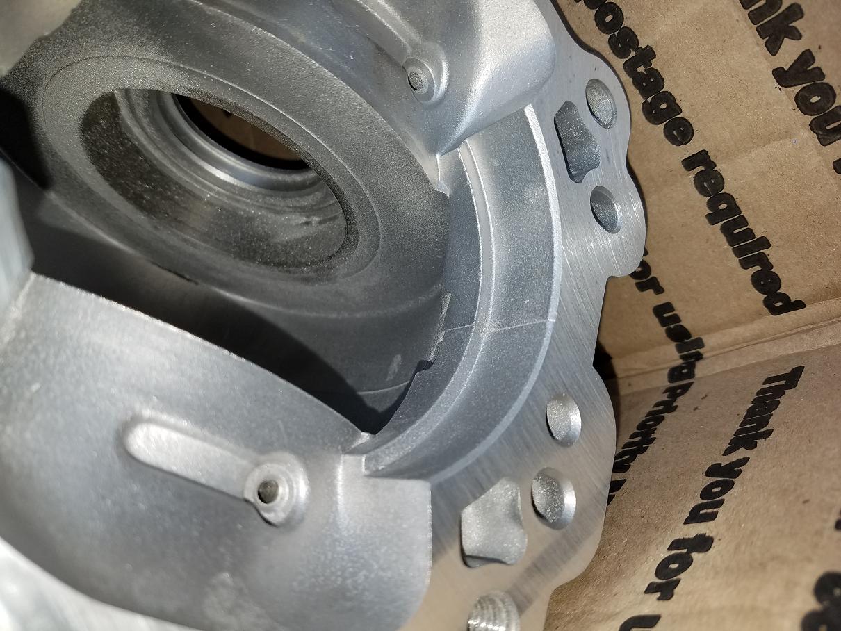

Since the deck was off from one case to another about .001" I went ahead and made sure they were the same height..
After cleaning these cases up again we will finally be ready for assembly.
KX GURU RACING SEAN COLLIER KX500 206.JPG (178.79 KiB) Viewed 16321 times

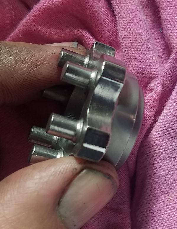

Spent a bit of time cleaning and polishing..
Yeah, there's a bit of wear on these but they will work just fine for a while longer.
KX GURU RACING SEAN COLLIER KX500 207.JPG (153.16 KiB) Viewed 16317 times

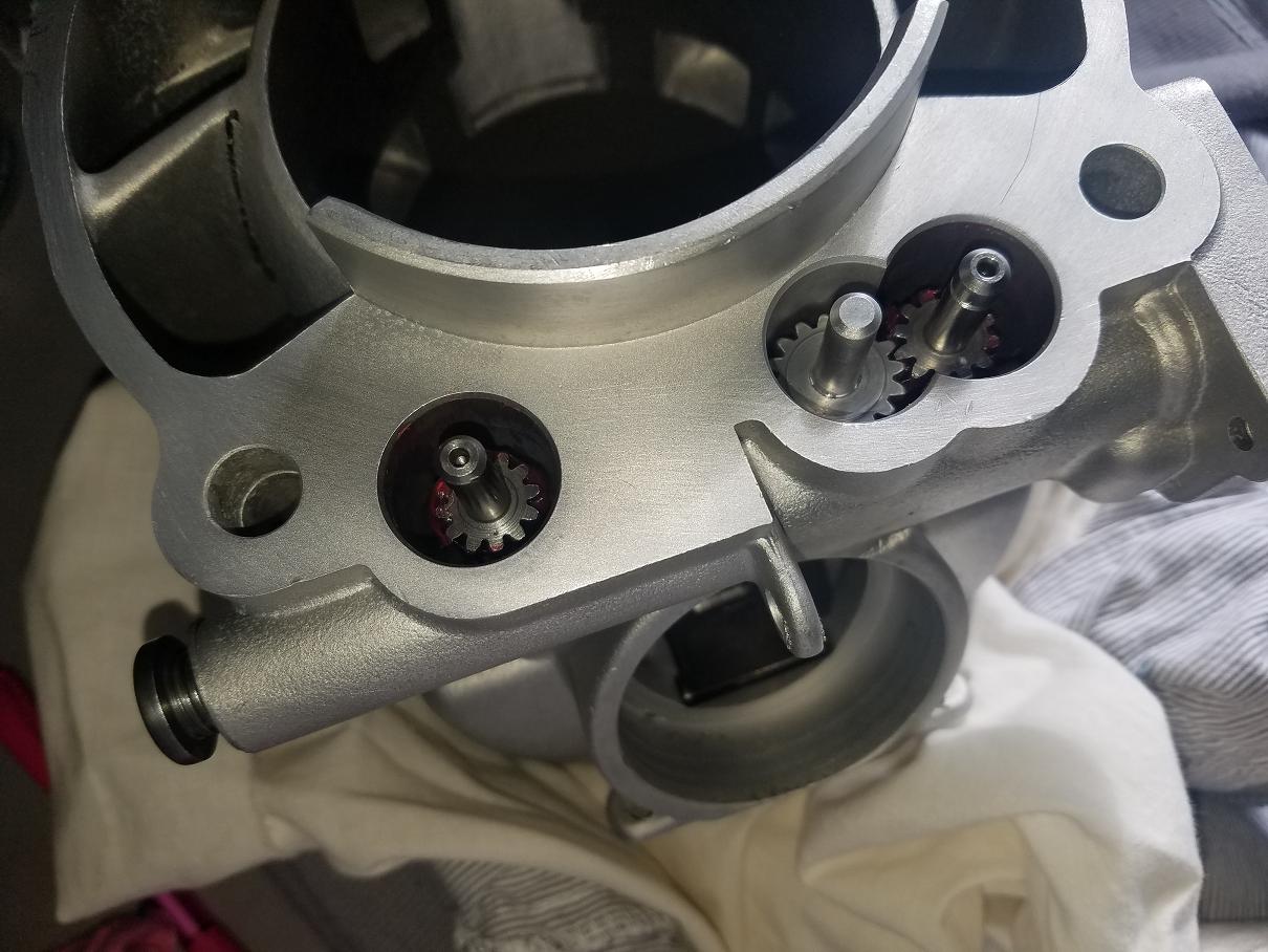

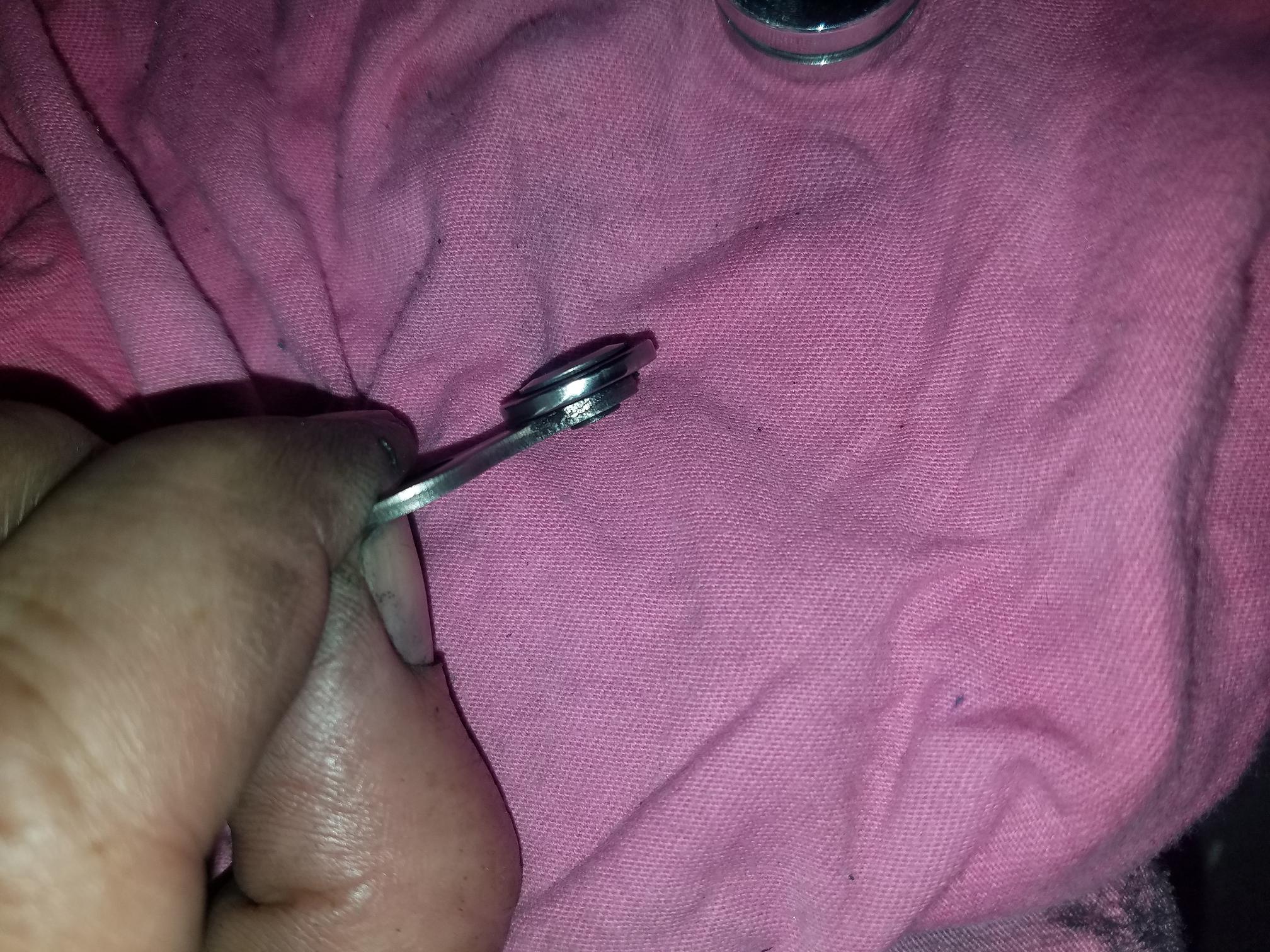

I was going to give the reed a quick clean up but then decided to go all out and disassemble it.
It's a good thing I did because I found a crack in it.. :o
KX GURU RACING SEAN COLLIER KX500 213.JPG (83.12 KiB) Viewed 16315 times

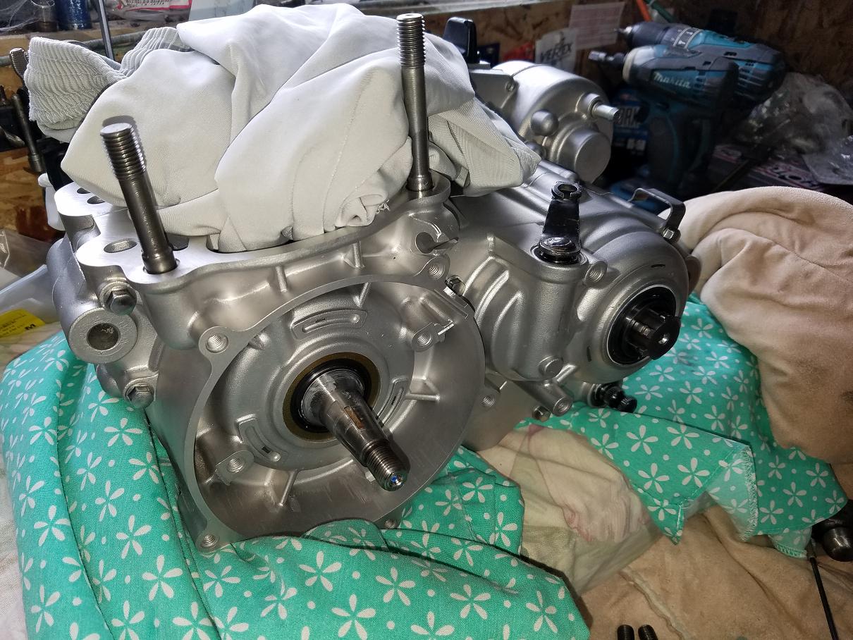

Posted: Wed Oct 12, 2016 3:06 am

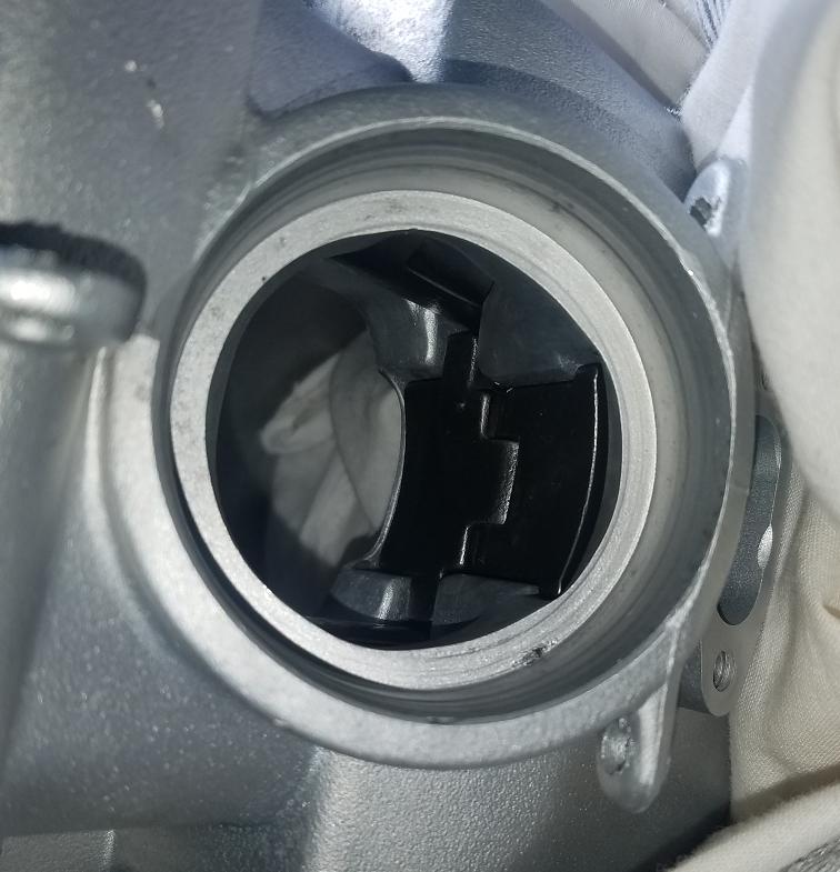

I had to run into town late this afternoon as the cases were heating up.
When I got back Jason was locking up.
I had to sneak in and see what he got finished..
KX GURU RACING SEAN COLLIER KX500 214.JPG (268.62 KiB) Viewed 16314 times
KX GURU RACING SEAN COLLIER KX500 215.JPG (233.53 KiB) Viewed 16314 times
Hopefully tomorrow we can get this thing buttoned up, boxed, and shipped back on Thursday..

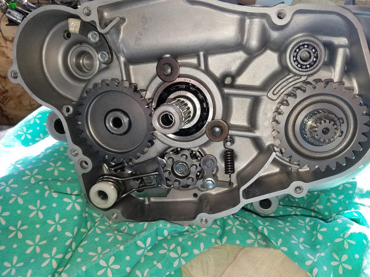

Posted: Thu Oct 13, 2016 12:32 am

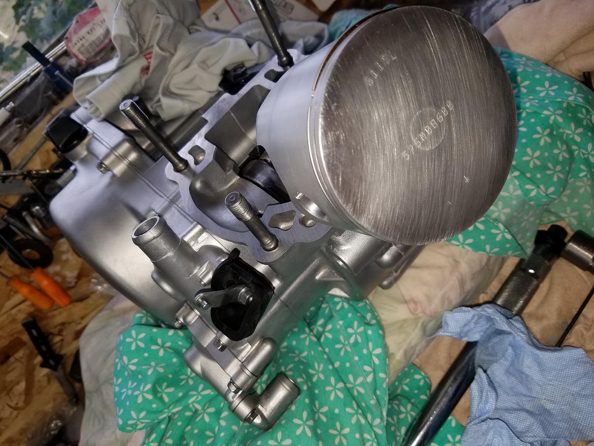

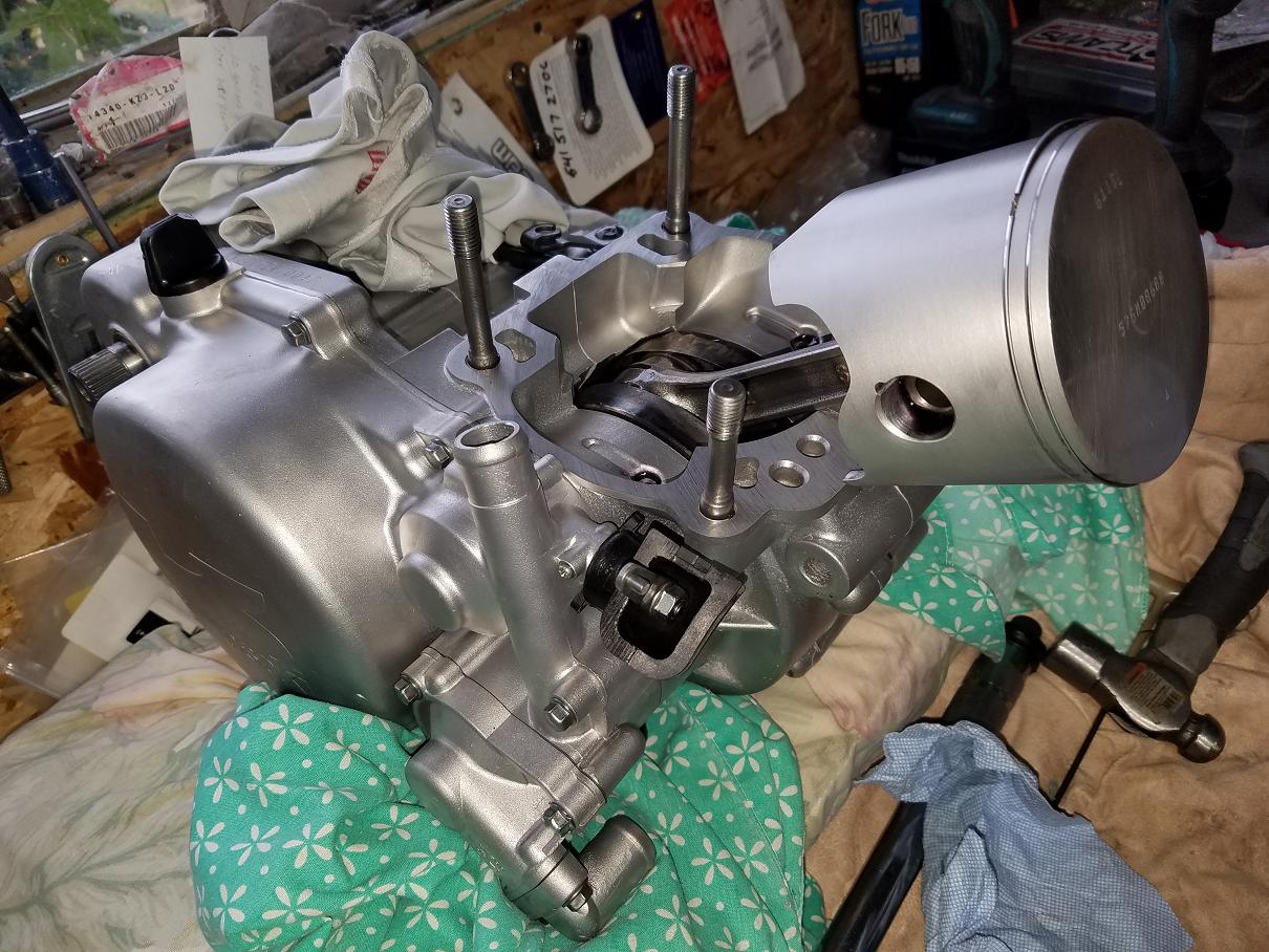

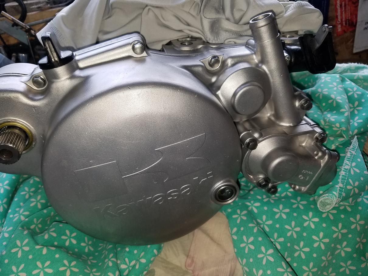

Remember... the only new parts on this is the bearings and seals.
Everything else is used...
KX GURU RACING SEAN COLLIER KX500 217.JPG (281.09 KiB) Viewed 16310 times
KX GURU RACING SEAN COLLIER KX500 218.JPG (223.75 KiB) Viewed 16310 times
KX GURU RACING SEAN COLLIER KX500 219.JPG (197.7 KiB) Viewed 16310 times

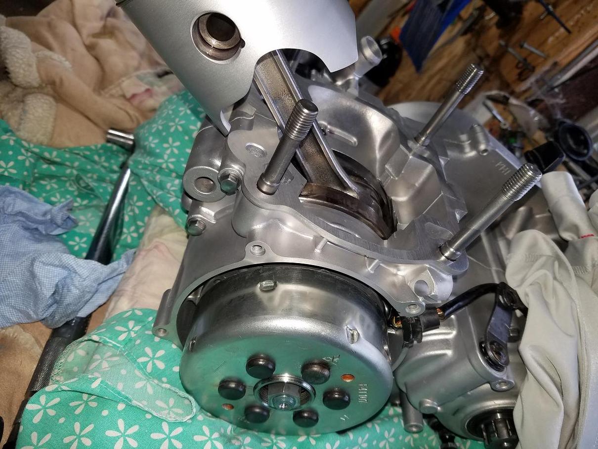

Posted: Thu Oct 13, 2016 12:33 am
KX GURU RACING SEAN COLLIER KX500 220.JPG (215.82 KiB) Viewed 16309 times
KX GURU RACING SEAN COLLIER KX500 221.JPG (184.96 KiB) Viewed 16309 times
KX GURU RACING SEAN COLLIER KX500 222.JPG (196.68 KiB) Viewed 16309 times
