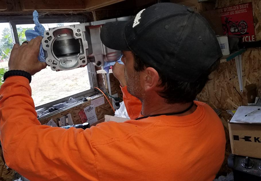

Jason is holding the cases up to some light so he can check the cases for any air gaps... NONE :ugeek:

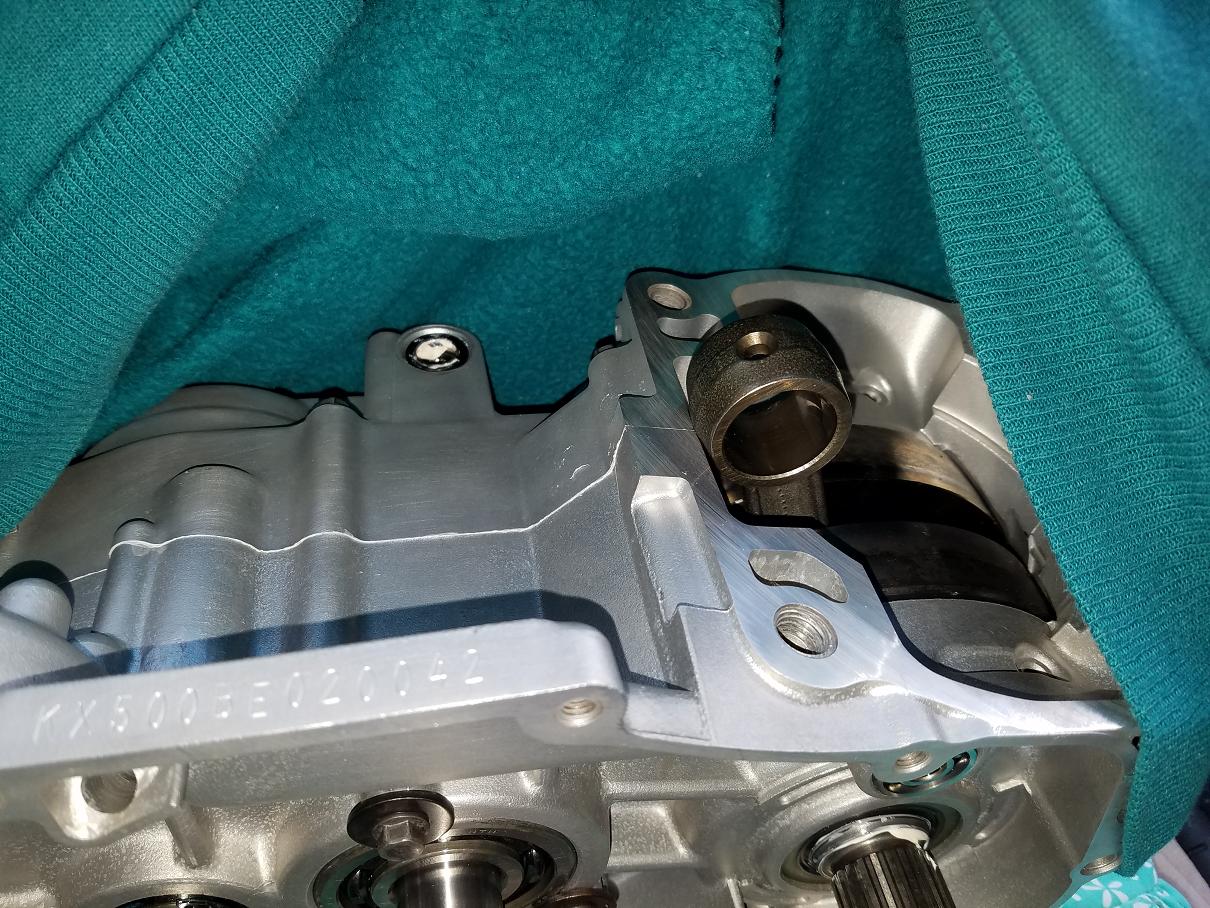

Since the deck was off from one case to another about .001" I went ahead and made sure they were the same height..
After cleaning these cases up again we will finally be ready for assembly.

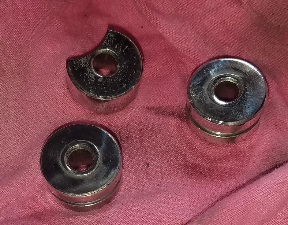

Spent a bit of time cleaning and polishing..
Yeah, there's a bit of wear on these but they will work just fine for a while longer.

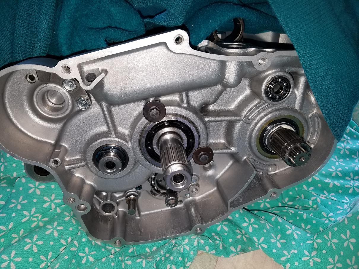

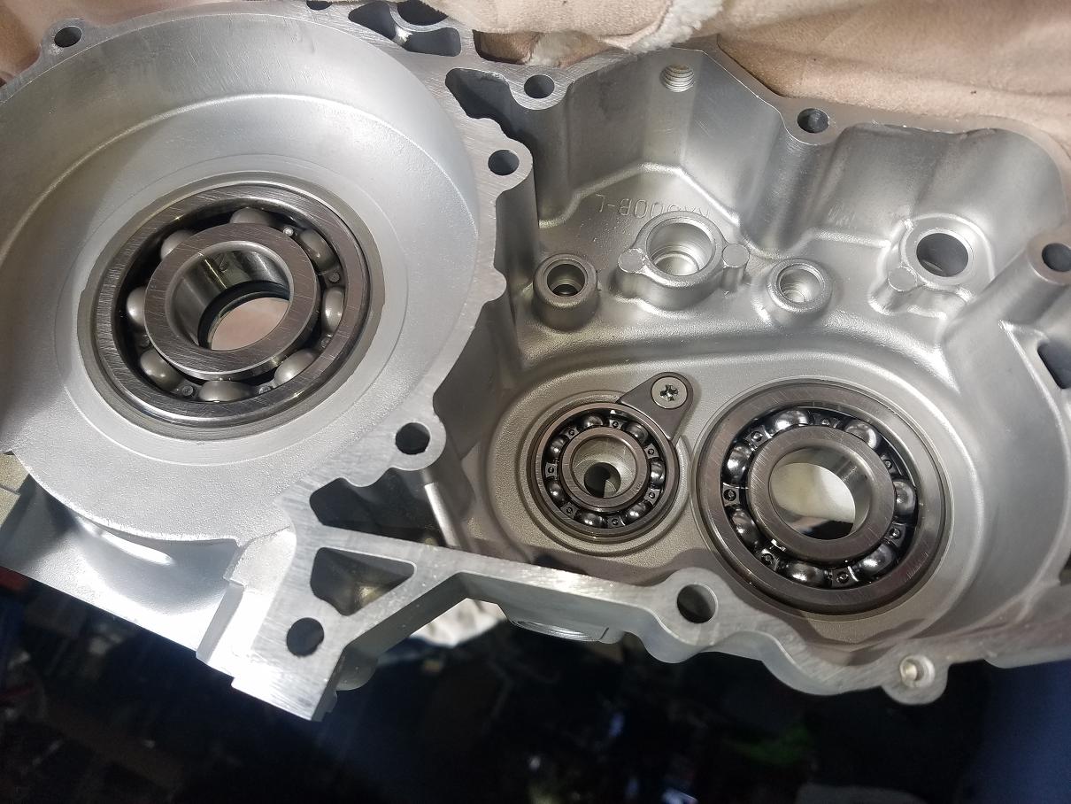

Into the oven... New bearings and seals installed..

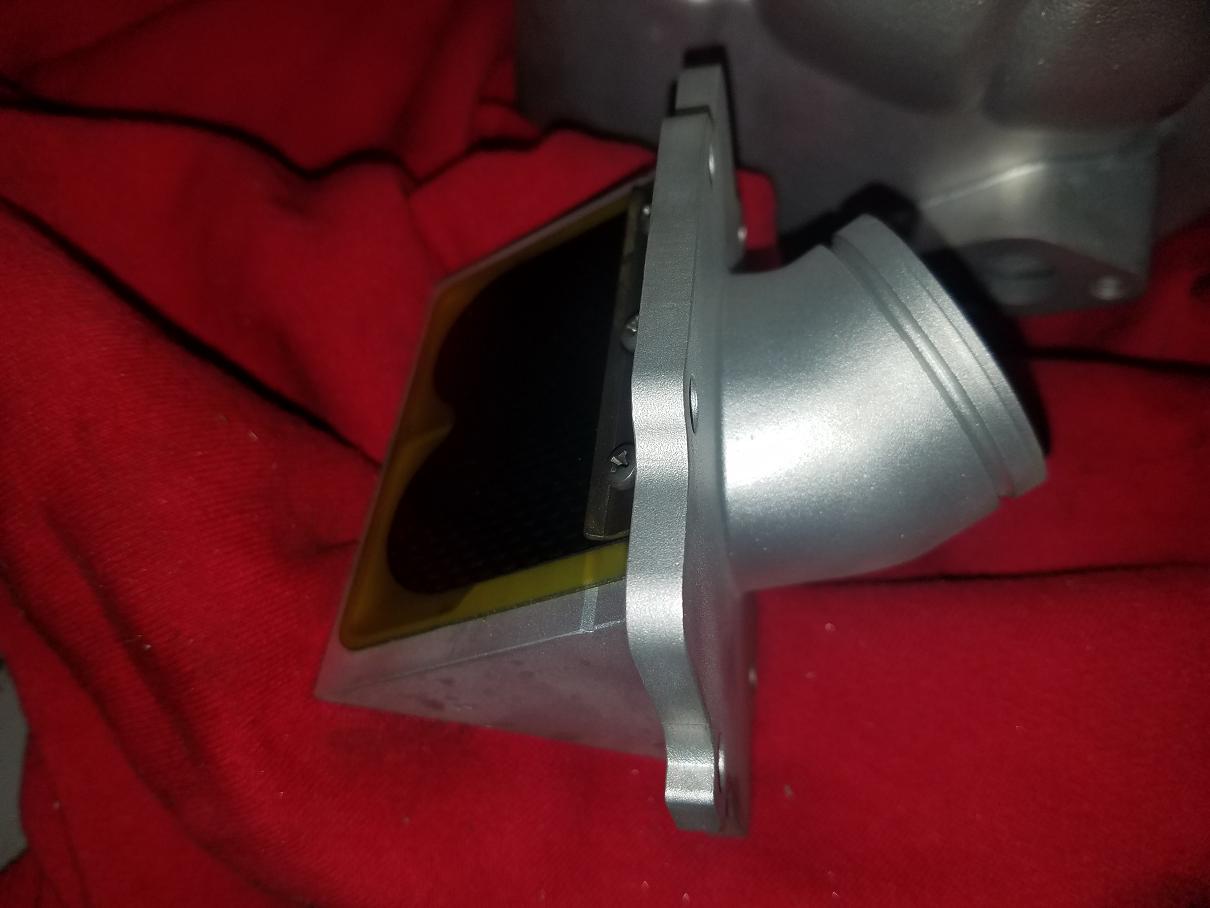

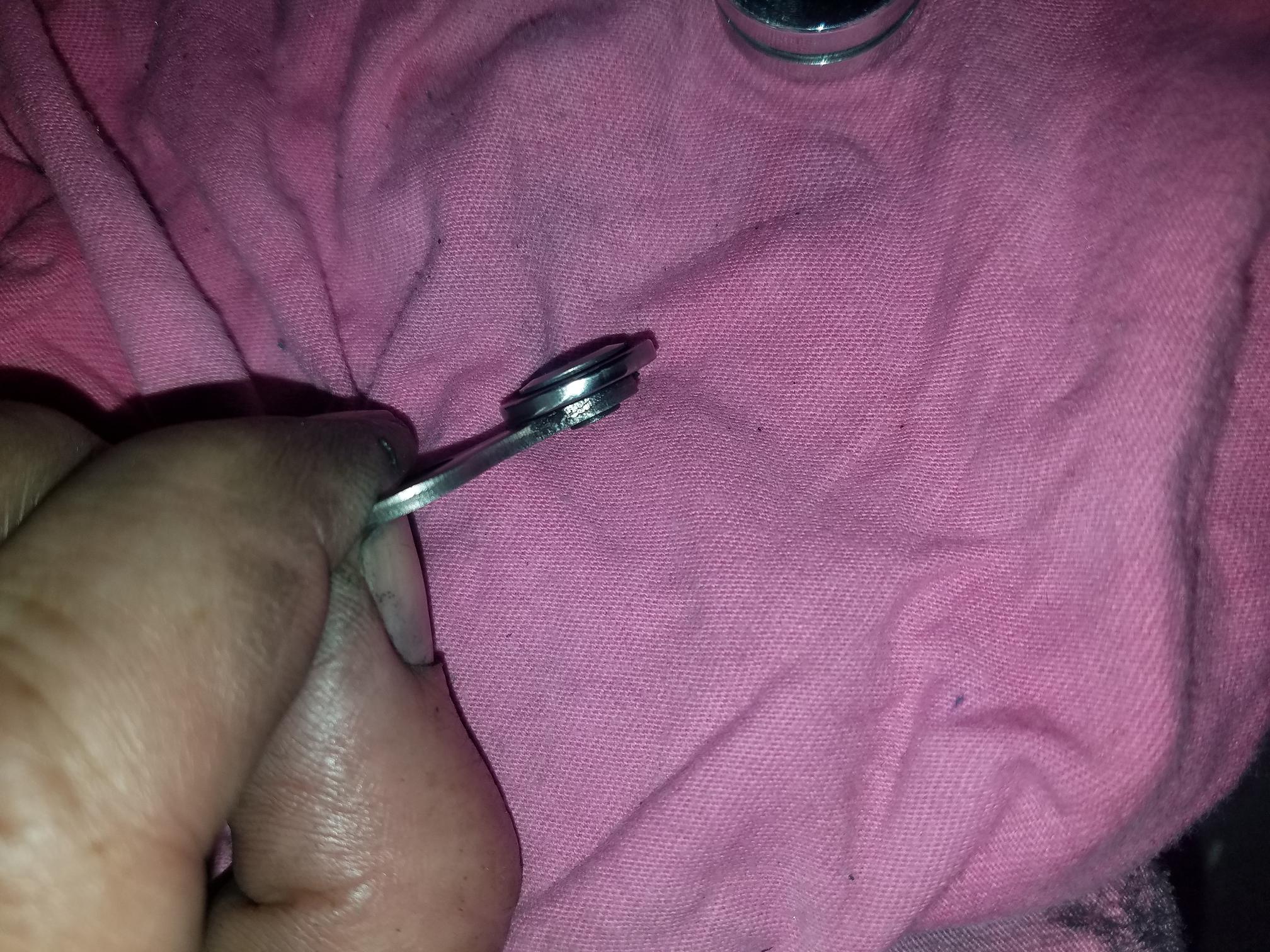

I was going to give the reed a quick clean up but then decided to go all out and disassemble it.
It's a good thing I did because I found a crack in it.. :o
KX GURU RACING SEAN COLLIER KX500 213.JPG (83.12 KiB) Viewed 16311 times
