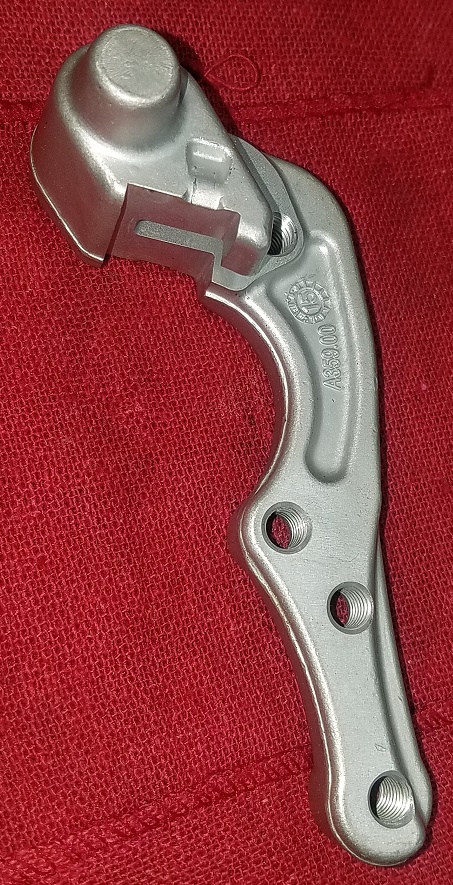

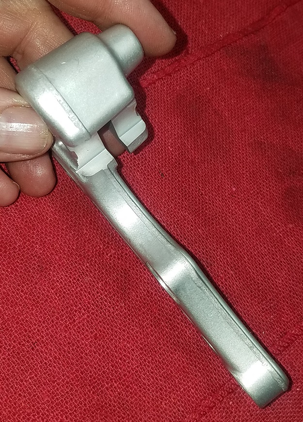

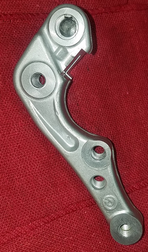

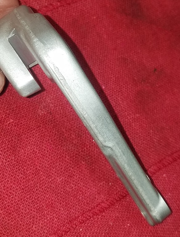

This is the front brake caliper mount as removed from the bike.
And when you think about it, removing the casting flash would cost a lot more money for the manufacture.
But for me.... I can clean and polish while watching the tube.. :lol:

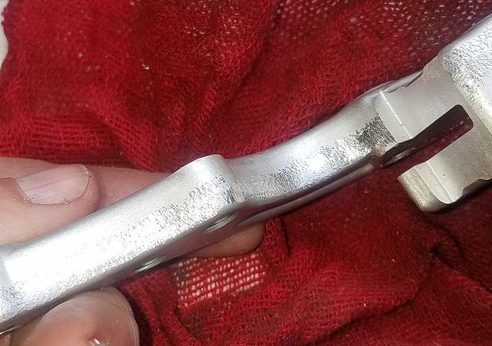

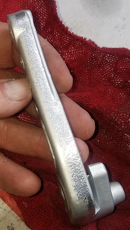

This is after I removed the casting flash..
KX GURU RACING 2016 KTM 250SXF KX500 CONVERSION 147.jpg (190.47 KiB) Viewed 10071 times
KX GURU RACING 2016 KTM 250SXF KX500 CONVERSION 148.jpg (179.39 KiB) Viewed 10071 times
Pretty rough

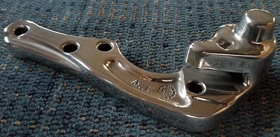

Time for some polishing...
KX GURU RACING 2016 KTM 250SXF KX500 CONVERSION 152.jpg (229.92 KiB) Viewed 10070 times
KX GURU RACING 2016 KTM 250SXF KX500 CONVERSION 151.jpg (390.82 KiB) Viewed 10070 times
KX GURU RACING 2016 KTM 250SXF KX500 CONVERSION 150.jpg (253.55 KiB) Viewed 10070 times
KX GURU RACING 2016 KTM 250SXF KX500 CONVERSION 149.jpg (362.93 KiB) Viewed 10070 times

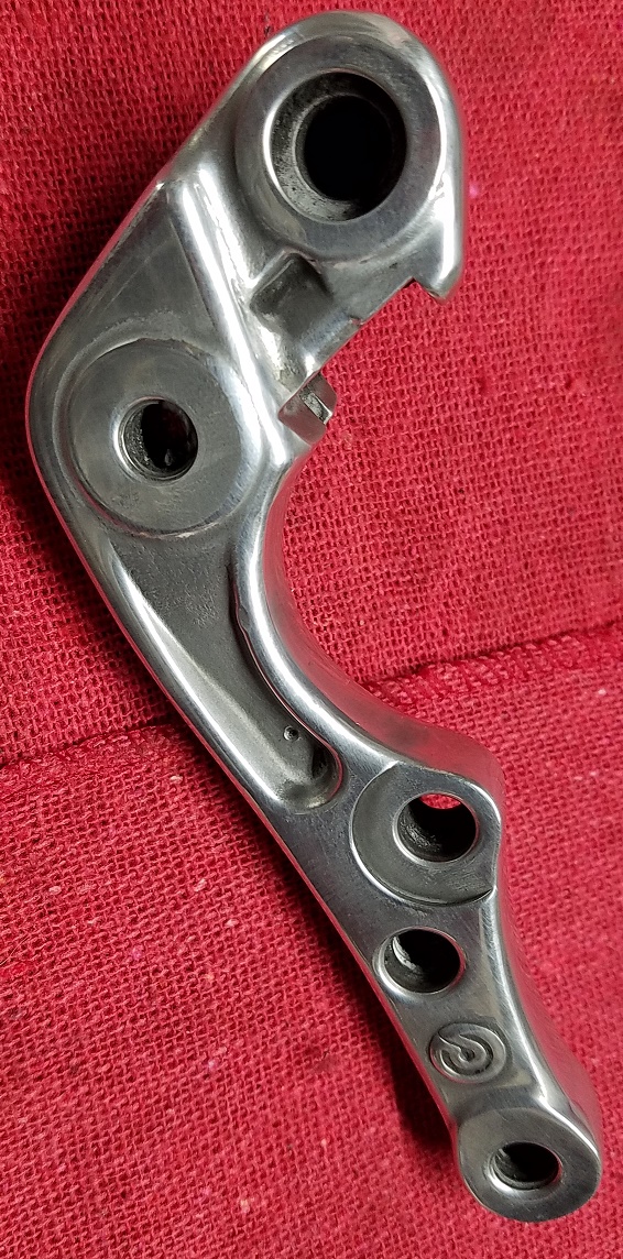

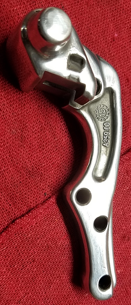

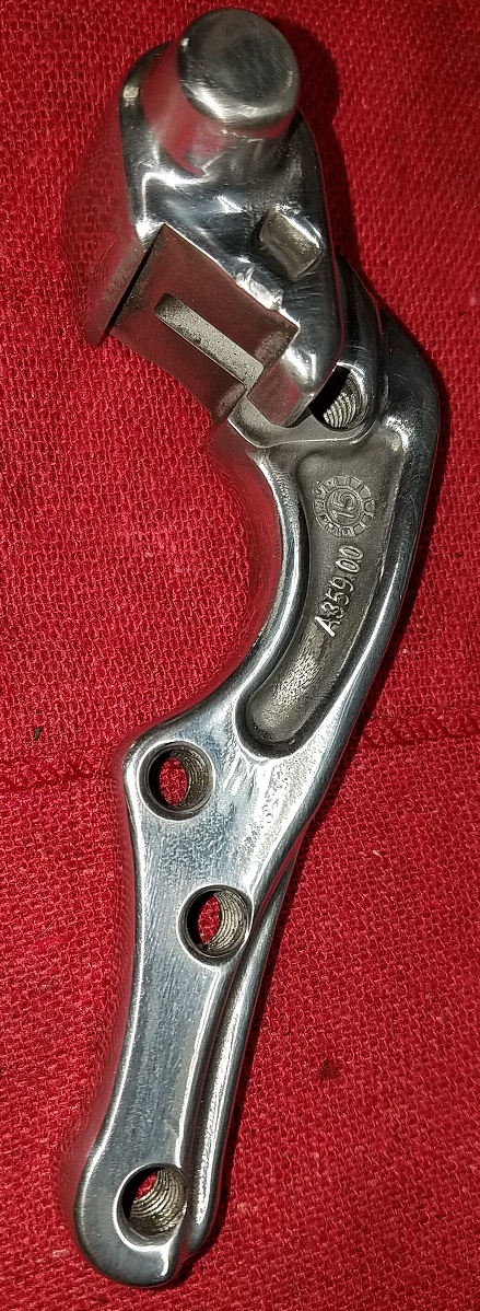

Obviously I have a bit more work to do.. :(
Getting there.... But why so much work for a caliper mount?
I'm going to anodize it :shock:
The guy doing the work said the smoother I get it the better the job will turn out so....
Gettin closer..

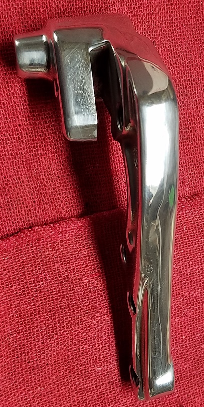

Just a wee bit more progress.

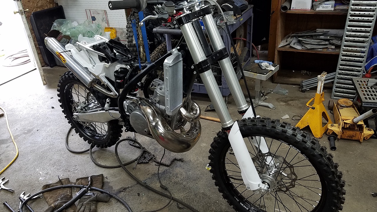

One of the things about doing a conversion is taking things apart and putting them back together several times...
It doesn't pay to be impatient.
Since I want this bike to be right I'll take it apart as many times as it takes :shock:

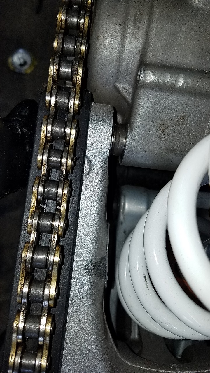

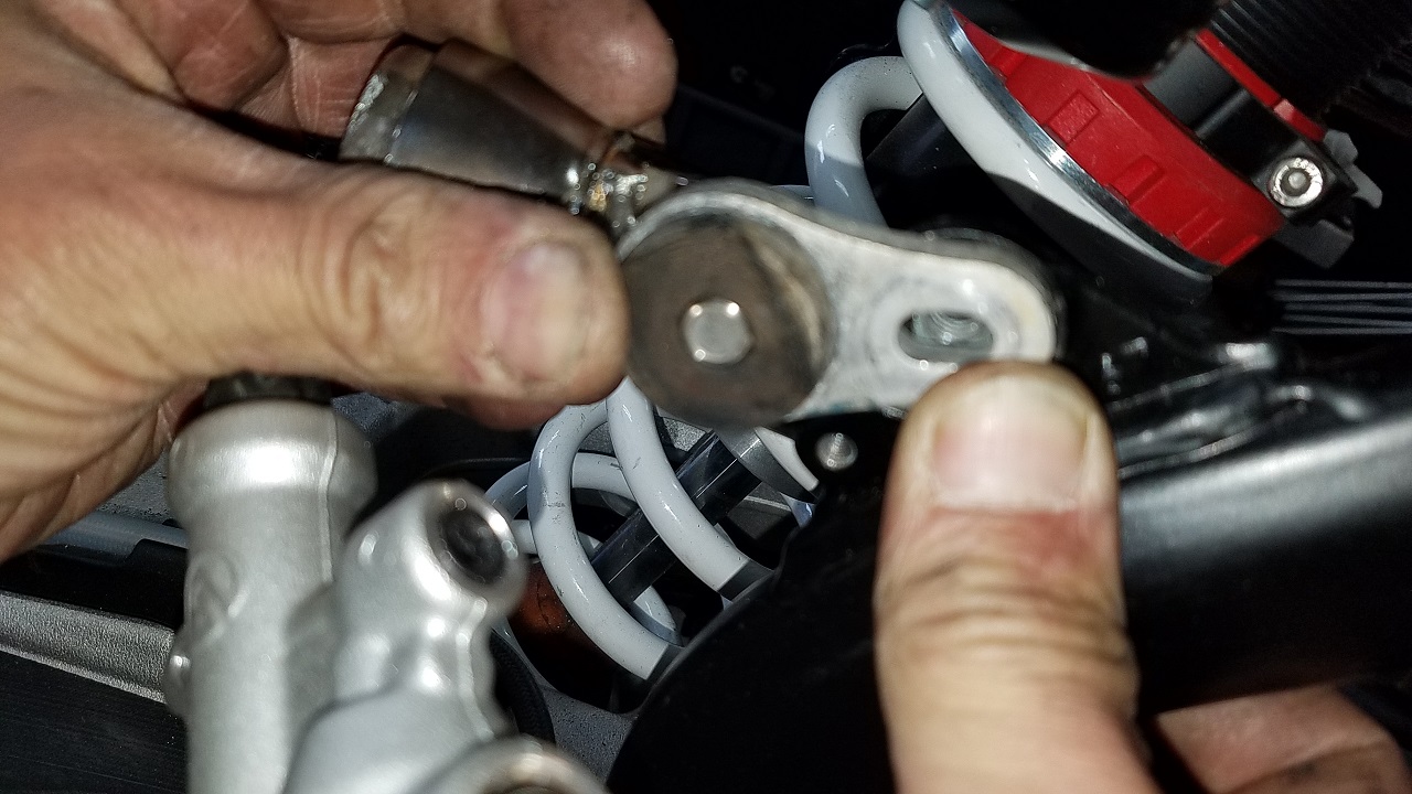

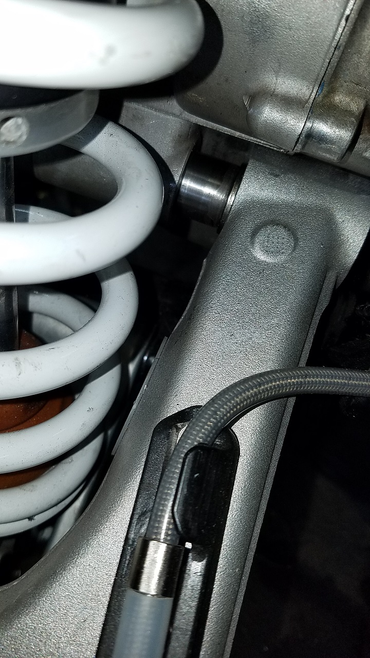

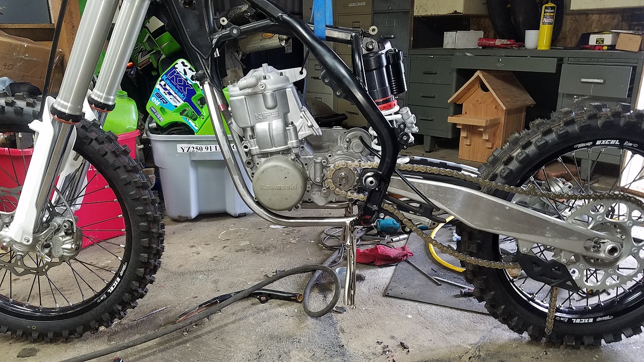

Today we started off by getting some temp rear engine spacers made..
KX GURU RACING 2016 KTM 250SXF KX500 CONVERSION 156.jpg (426.6 KiB) Viewed 10061 times
KX GURU RACING 2016 KTM 250SXF KX500 CONVERSION 157.jpg (383.71 KiB) Viewed 10061 times
The idea was to get the chain running true to the slider and the rear sprocket...
Mission accomplished.
Once we get it torn down again I will measure them and get some nice ones made..

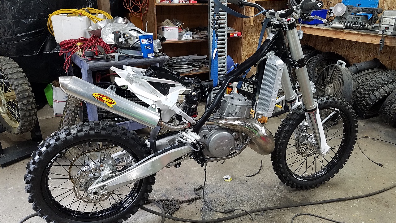

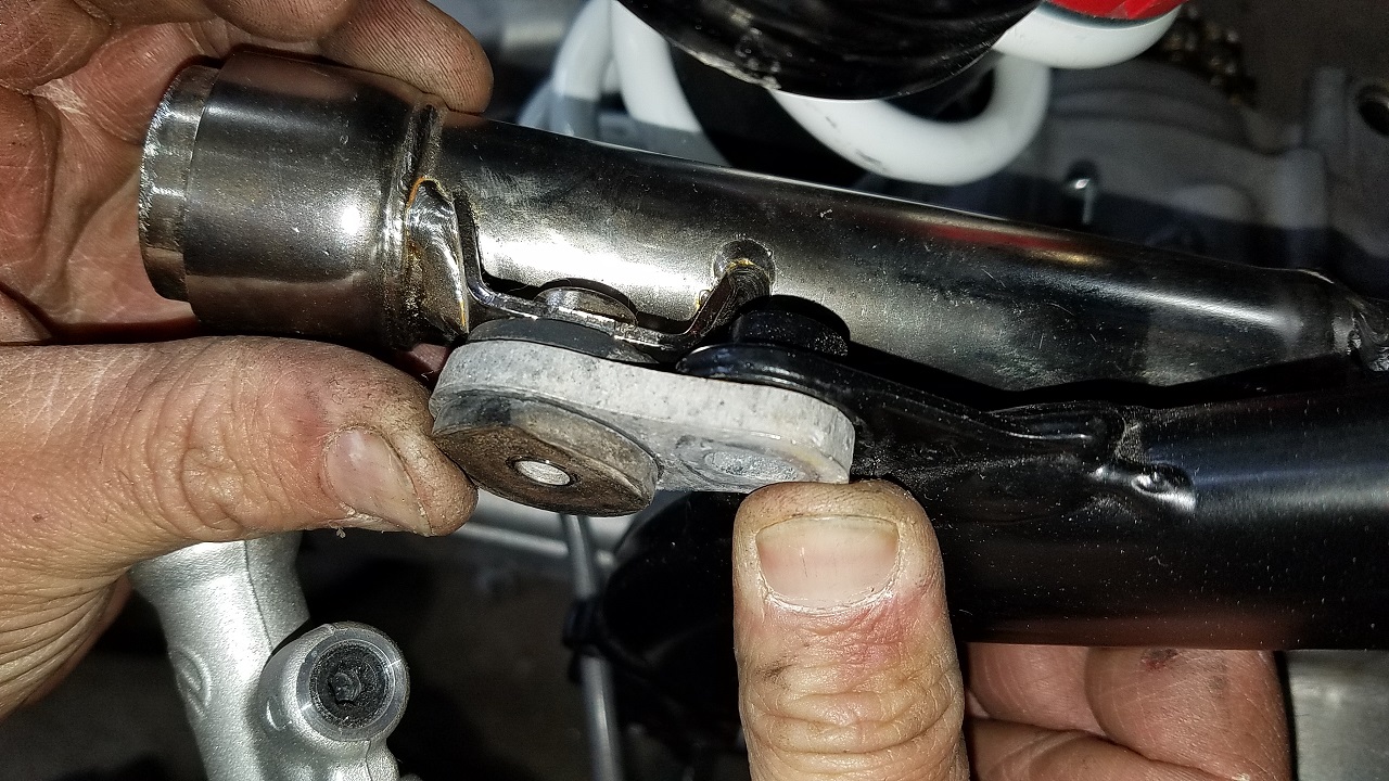

Next, we put the exhaust back on so we could see what the muffler was going to require..
KX GURU RACING 2016 KTM 250SXF KX500 CONVERSION 158.jpg (392.88 KiB) Viewed 10059 times
KX GURU RACING 2016 KTM 250SXF KX500 CONVERSION 159.jpg (270.1 KiB) Viewed 10059 times
If it wasn't for having to mount the sub frame that hole position is perfect..

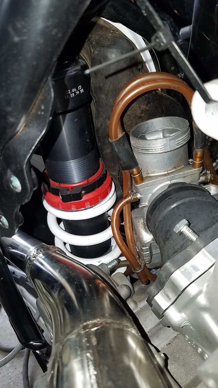

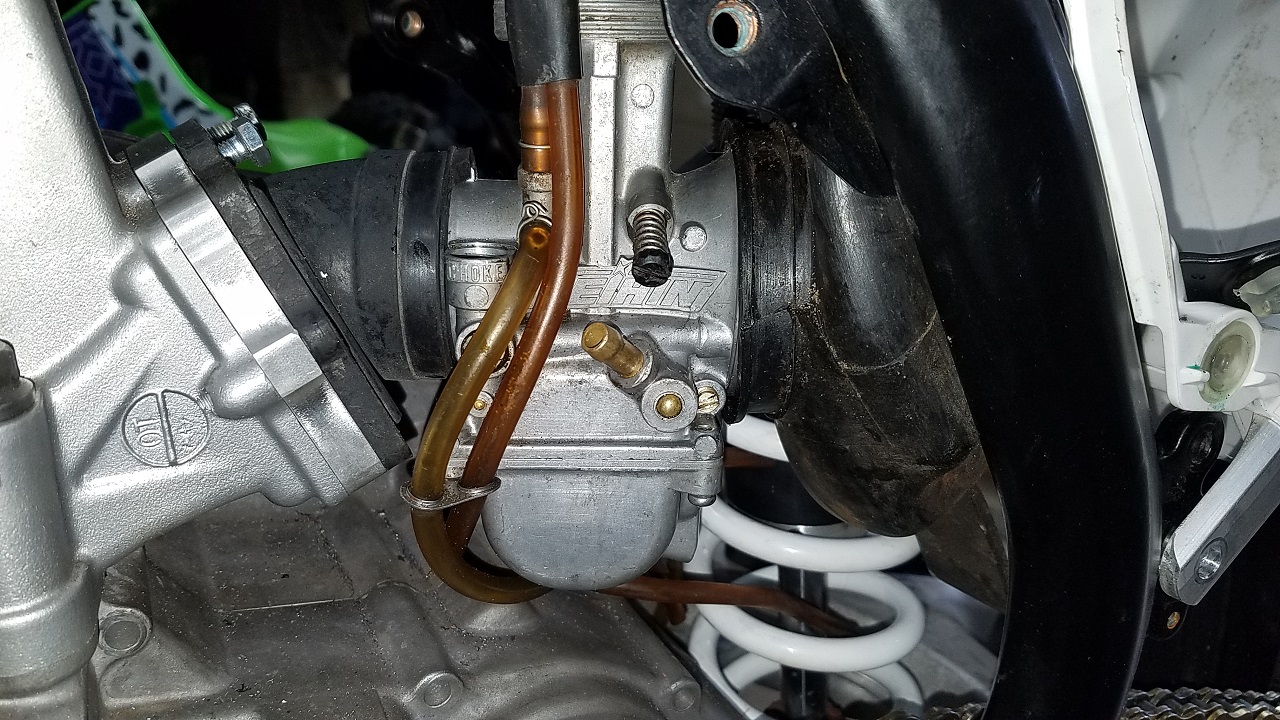

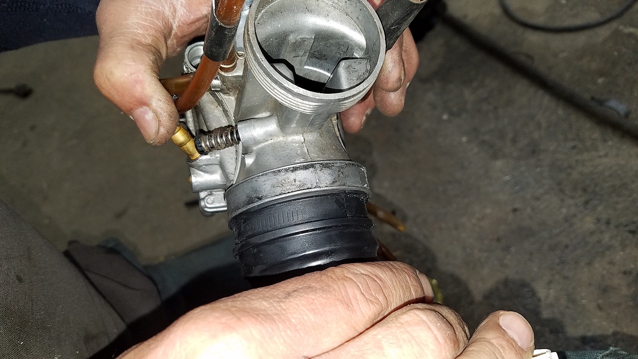

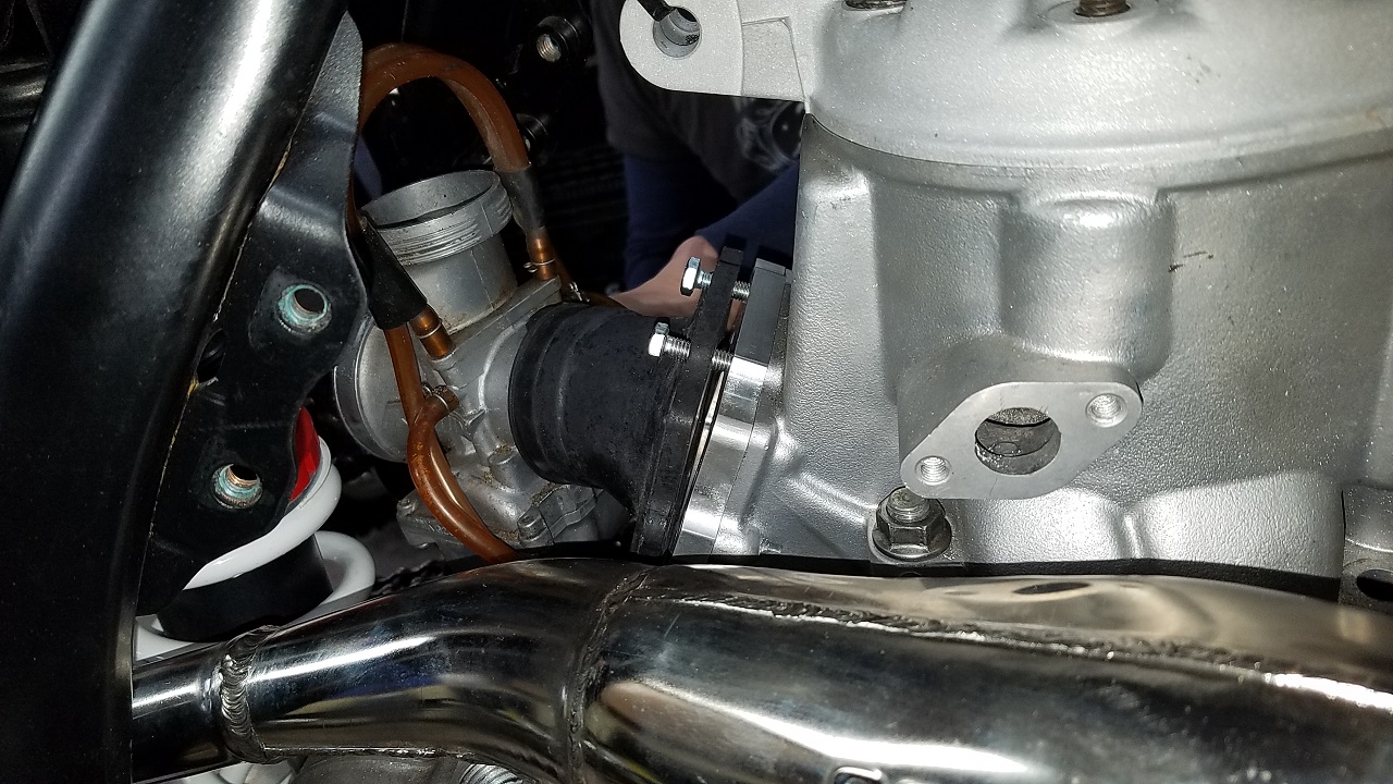

Next we set up the custom Adam Millar billet VF2 reed with built in spacer..
We needed to figure out the air box situation..
KX GURU RACING 2016 KTM 250SXF KX500 CONVERSION 162.jpg (365.46 KiB) Viewed 10058 times
Everything is looking good so far..
KX GURU RACING 2016 KTM 250SXF KX500 CONVERSION 163.jpg (406.2 KiB) Viewed 10057 times

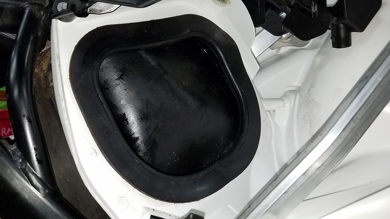

But here is the first real issue...
Yeah, that stinks..
KX GURU RACING 2016 KTM 250SXF KX500 CONVERSION 164.jpg (328.49 KiB) Viewed 10057 times
About a week ago Jason told me to look at a 1998 KTM 380 air box I had in inventory.
I pulled it out thinking no way is that going to be even close...
Guess what...
KX GURU RACING 2016 KTM 250SXF KX500 CONVERSION 165.jpg (277.3 KiB) Viewed 10054 times
