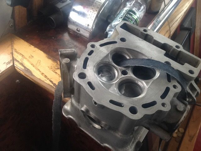

So for one of the future dyno runs I am preparing a cylinder head.
I have 3 spare cylinder heads but this one was the best for this mod, it's cam journals are good but the exhaust valve seats are well worn. It's really difficult to guess how this could have run in this condition but, ?, it must have. The plan here is to get the head fitted with 1mm oversize exhaust valves, the seats will be re cut to accept the valves by the import company for the valves who specialise in this. The valves are on order from a company called Manley, they will be of some kind of stainless steel made to handle high heat.
So I started by pressing out the valve guides, the exhaust guides were in poor condition, a bit crumbled at the end so there will be new ones fitted there and the inlet guides can go back in they were ok.

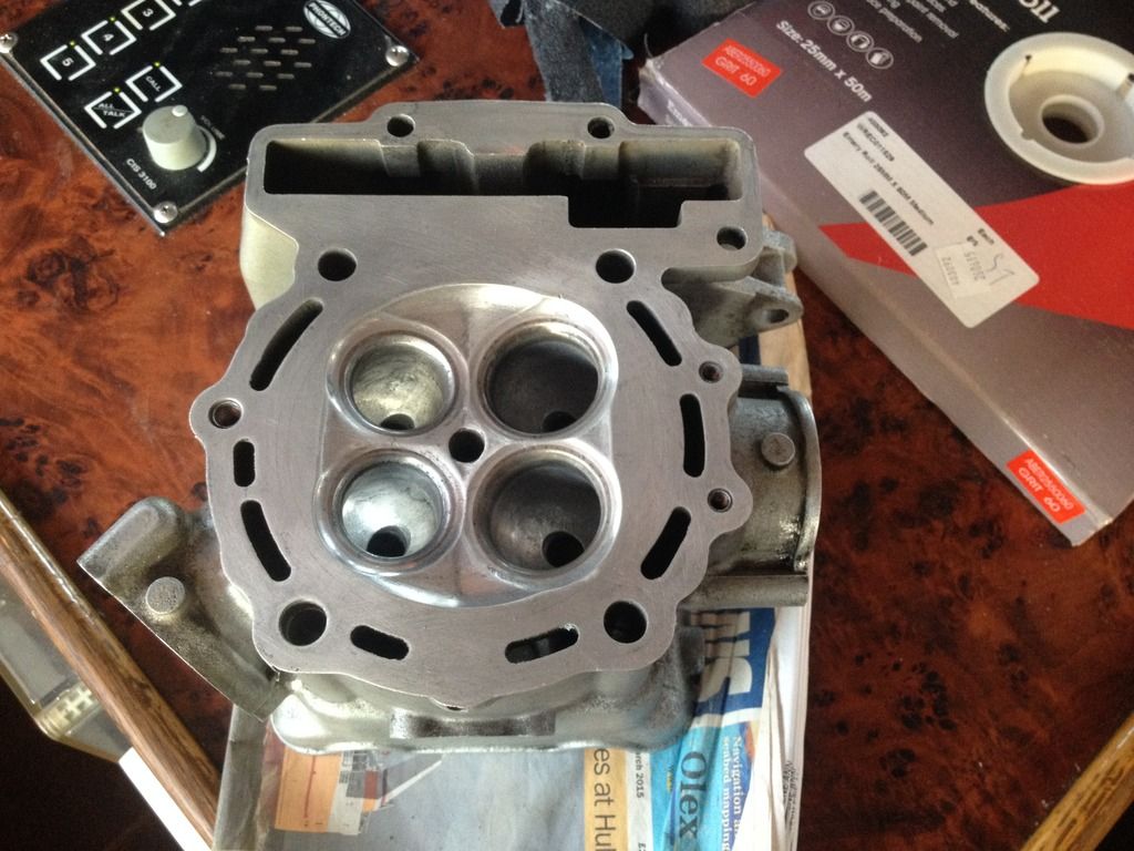

Then I went in with a knife and started scraping carbon out of the exhaust, then the emery tape after.
I didn't really count how many hours it took to get it as clean as this but my fingers were some sore and I luckily found a new toothbrush so I used my old one for the harder to reach bits.

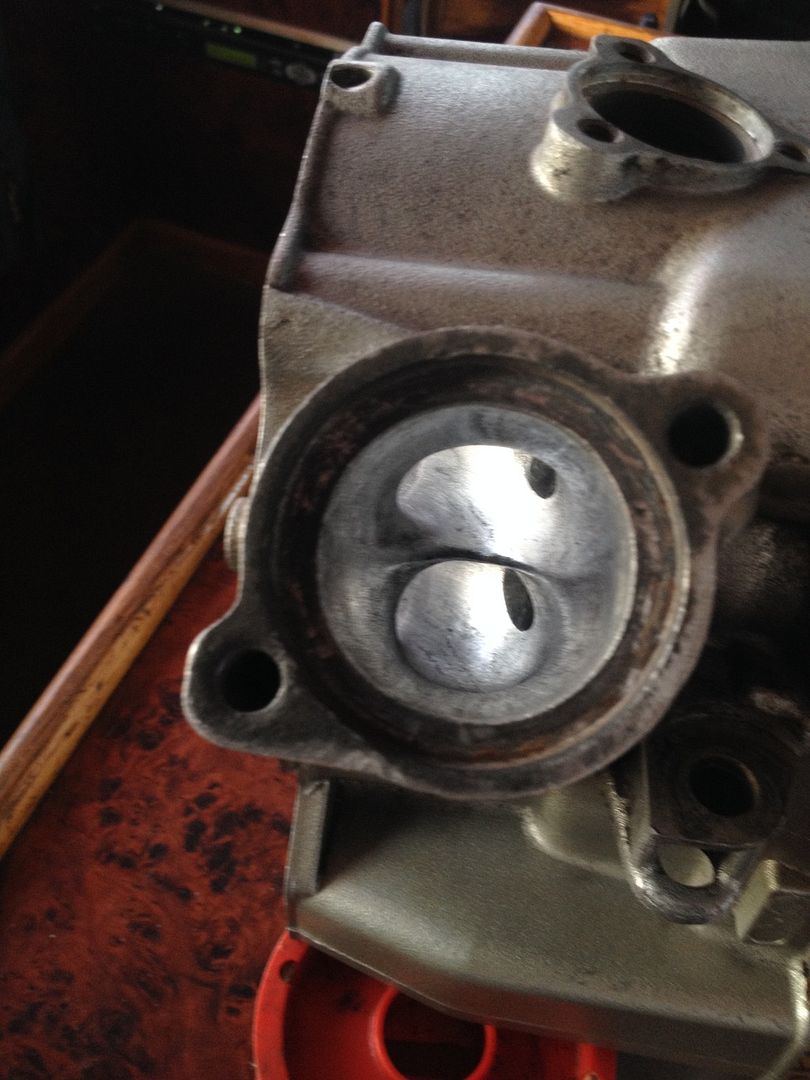

It's come nice and clean now, I would like to think the volumetric efficiency would be better by this work but I think only a very small amount. If you look very closely at the bridge between the exhaust valves you will see a small crack, it is actually on all the heads I have, it must be a design flaw, the alloy between the valve seats seems to lift and crack. I sanded the bridge down to try to eliminate the possibility of it becoming a hot spot where detonation could come from. One way to get away from this would be to put bigger valve seats in to eliminate the alloy of the bridge, could be a direction to go in, in the future. There was some casting and machining steps I have smoothed out, so all that will help but I think it will give a good indication of the merits of the bigger valves. And of course it will be run on the dyno before and after.
Yes DYNO!!!!
That separates the "I think it's faster" to "I know it's faster :D

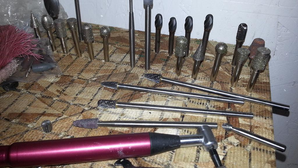

You need to get a dremel tool or a porting tool.
It makes cleaning up those ports so much easier..
On the intakes I like to use 120 grit sandpaper first then 220.

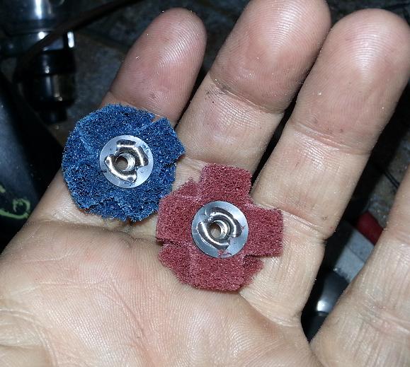

On the exhaust I do the same thing but after the 220 grit I use a blue cross buff wheel and then red cross buff wheel..
Get's that exhaust shiny!
Won't give you a penny's worth of horsepower doing the polishing but it will keep carbon from building up and hopefully keeping your starting HP longer.

I've never seen that crossbuff wheels. It would have saved me a bit of time, also I don't think the exhaust port is as clean as it would need to be for say a ceramic coating. I tried a company for the dynamic balancing, sent them an email, no reply as yet.

Yeah, I was going over all of the video's at CC Specialties and ran into to one where he was using the cross buffs...
I'm so glad I found them.
Saves hours of diddling around :geek:

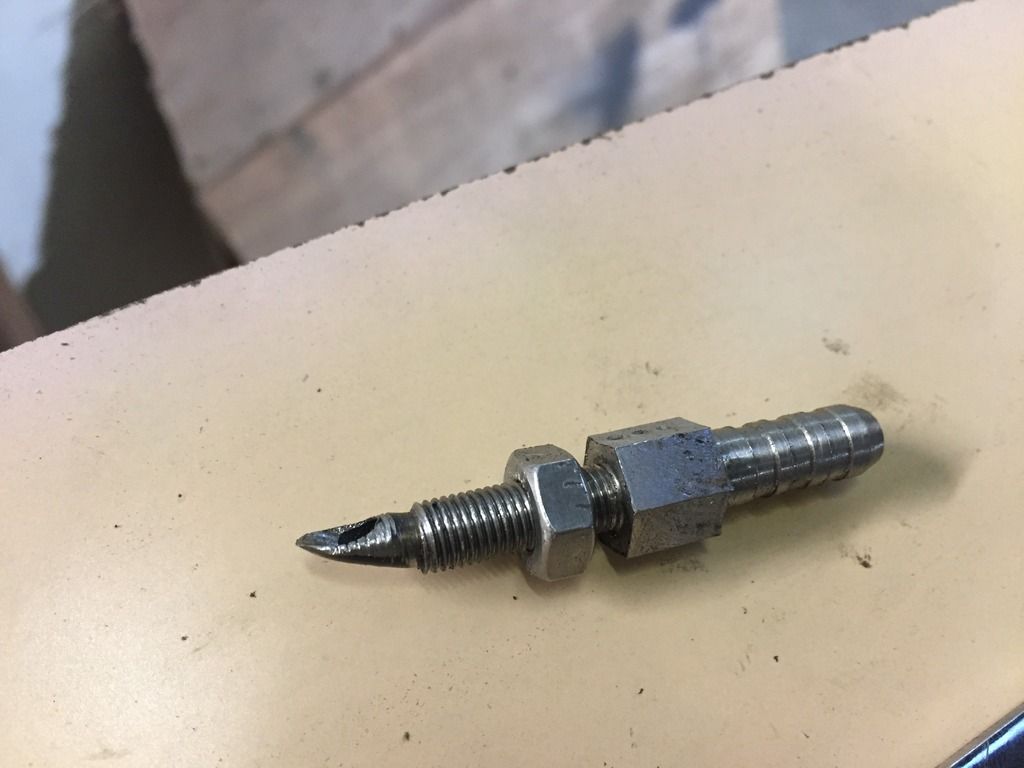

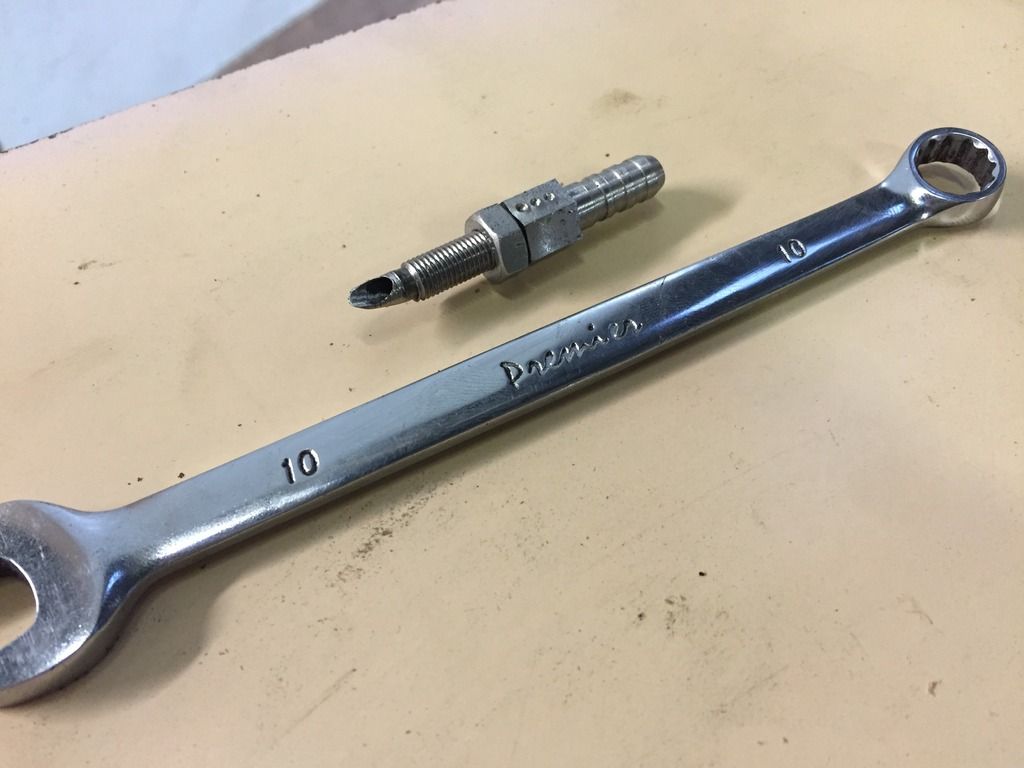

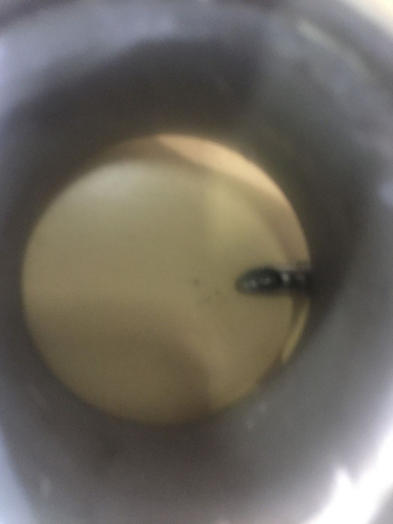

This is my pitot tube. Made out of a bit of 14mm stainless bar.
The three centre punch marks are for lining up the point if the tube into the airflow. The thread is 6mm metric fine.
It will protrude into the inlet tract like so. Sorry for the poor pictures, low temps here again, my phone does not like it.
Nice that you put the wrench in there for size reference.
