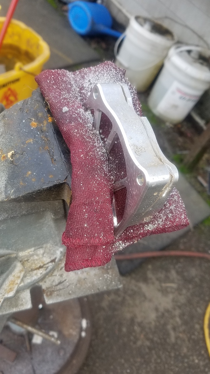

Then I discovered that that the custom mounting bracket for the E-start would not fit stock cases.
Nothing could be done but to build another bracket.
