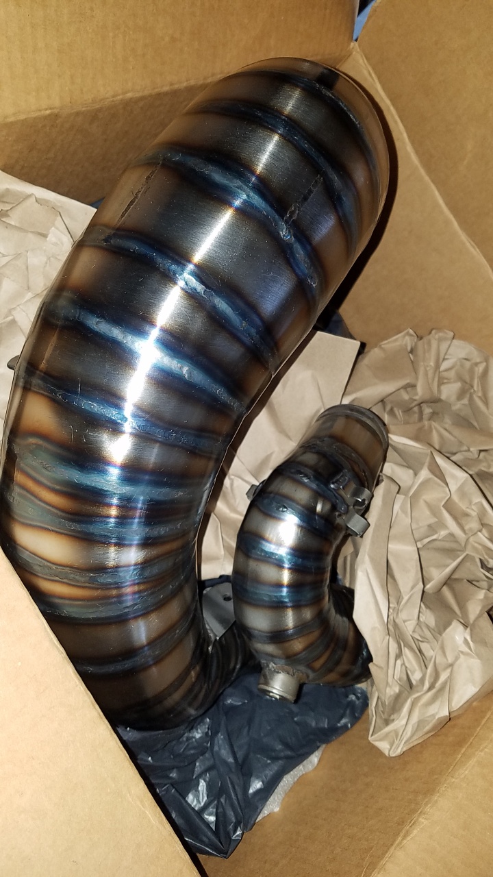

My pipe was a bit trashed after Glen Helen so I sent it out to Pacific Crest Pipe Repair in Medford Oregon and had him do some work.
It came back BEAUTIFUL!!
I wish I had sent it out BEFORE the shootout.
Oh well..

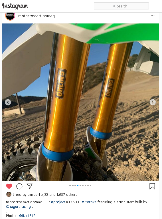

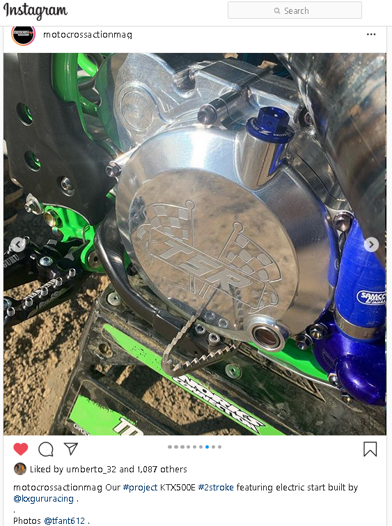

instagram 4-26-20-2.png (591.41 KiB) Viewed 15260 times
instagram 4-26-20-1.png (841.81 KiB) Viewed 15259 times
instagram 4-26-20-3.png (672.62 KiB) Viewed 15260 times
instagram 4-26-20-4.png (529.23 KiB) Viewed 15260 times
instagram 4-26-20-5.png (612.62 KiB) Viewed 15260 times
instagram 4-26-20-6.png (507.9 KiB) Viewed 15260 times
instagram 4-26-20-7.png (600.4 KiB) Viewed 15260 times
instagram 4-26-20-8.png (527.92 KiB) Viewed 15260 times
instagram 4-26-20-9.png (669.31 KiB) Viewed 15260 times

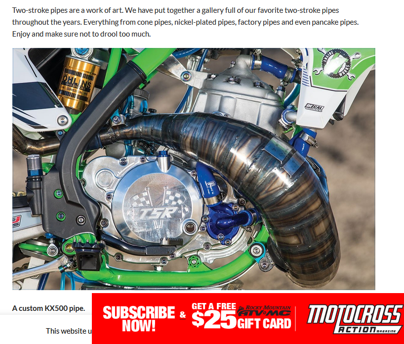

MXA: TWO-STROKE TUESDAY | THE ART OF PIPES
https://motocrossactionmag.com/two-stro ... -of-pipes/

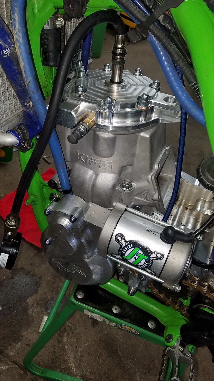

I figured that it would be a while before he would be ready to race it, so I started building a new top end.
Jason Tanner (JT EngineWorks) and I tested and tuned to dial the new top end in.
It is making more power everywhere and the RPM range starts even lower.
This thing is a torque monster and yet has more top end.

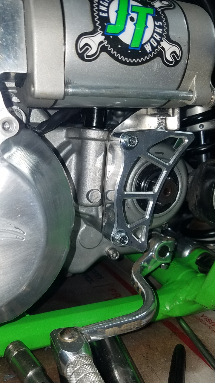

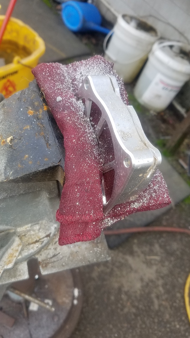

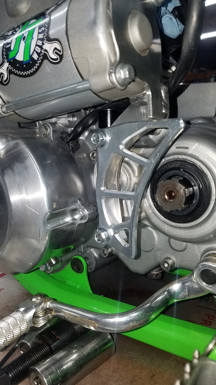

Then I discovered that that the custom mounting bracket for the E-start would not fit stock cases.
Nothing could be done but to build another bracket.
