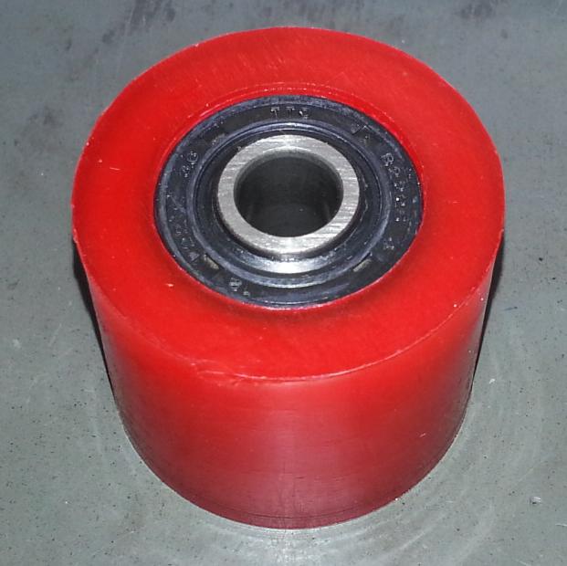

Old chain rollers were... well.... old
First thing I did was pop the seals and grease them good...

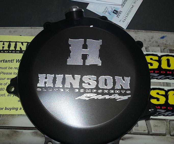

Look what came in today.
And it will fit 89-04 KX500 if you have the correct adapter

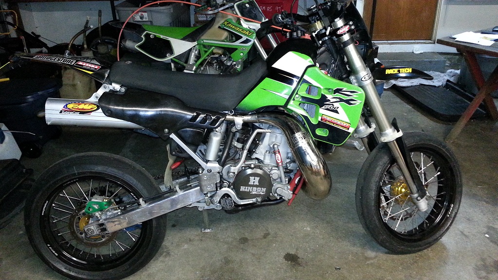

Now for a quick recap.
I did the water pump impeller clearance mod.
I cleaned up all the water passages.
Cleaned up oil passages in the cases.
I have a re-cut head.
Chinese Rads.
Stock port timing.
Cleaned up cylinder transfers, ports, and bridges.
Balanced crank.
Wossner windowed piston.
VF2 Reed with modded boot.
41mm carb jetted a bit rich at the moment.
Running 1 qt of distilled waterper 2 oz of Royal Purple's Purple Ice (Bought it at Napa).
MZB ignition with a flywheel that is 1lb lighter then stock.
My bike has never ran so cool and with so much smooth power.
Time to start another build with some advanced port timing

According to gearing commander.com I should be able to hit 88 mph in 4th at 8500 rpms.
I can hit 90 if I flog it hard. Now to find some place I can do it in 5th. Will I hit 105?
I'll need to hit 8500 RPM's to do it.
