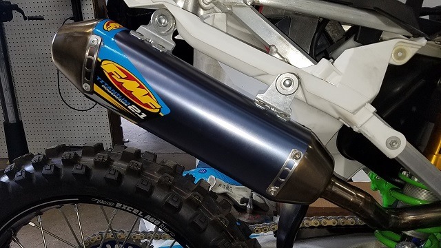

Muffler assembly..
Got the outlet cap on...

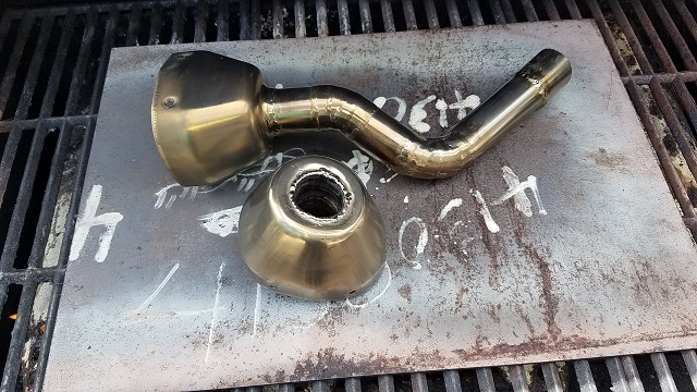

When it comes to coloring Ti you can use all sorts of things to do it.
I chose to use very even heat to get the color I was after.
Just don't tell your wife that you are using the BBQ for things other than meat
- 20190717_123325_resized.jpg (126.81 KiB) Viewed 11314 times
Heat coloring of titanium:
pale gold straw-385 C or 725F
purple-412 C or 774F
deep blue-440 C or 824F
red purple-565 C or 1049F
brown gray-648 C or 1199F
green blue-925 C or 1697F
Posted: Fri Jul 19, 2019 4:55 pm
As soon as the Ti reaches temp, it colors.
You don't have to keep it at that temp.
In fact, keeping it at temp will not change the color at all...
Only going up in temp will change the color.

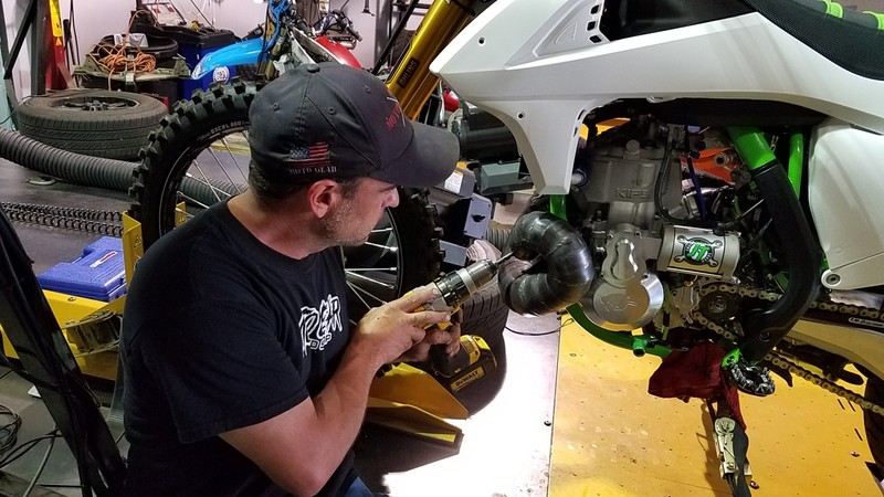

Posted: Wed Aug 07, 2019 5:23 am
Nothing says Commitment like drilling a hole through your custom one off pipe...

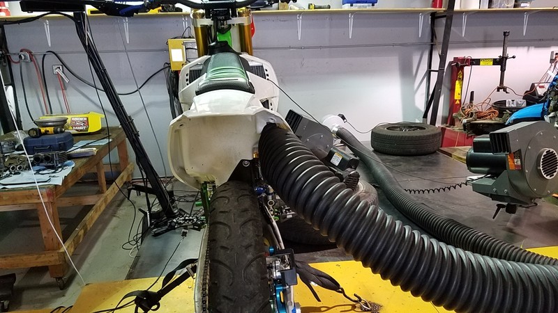

Posted: Wed Aug 07, 2019 5:24 am
Smoke sucker!!
