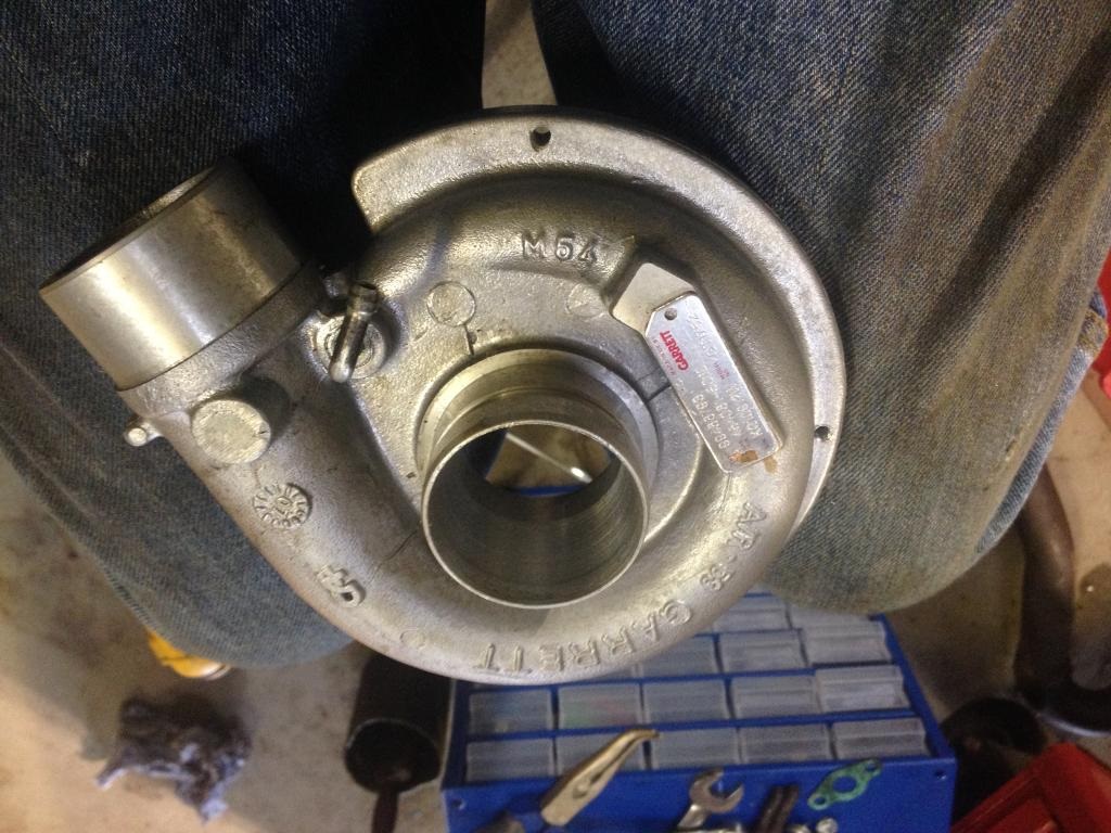

Did you use a pitot tube for boost reference?

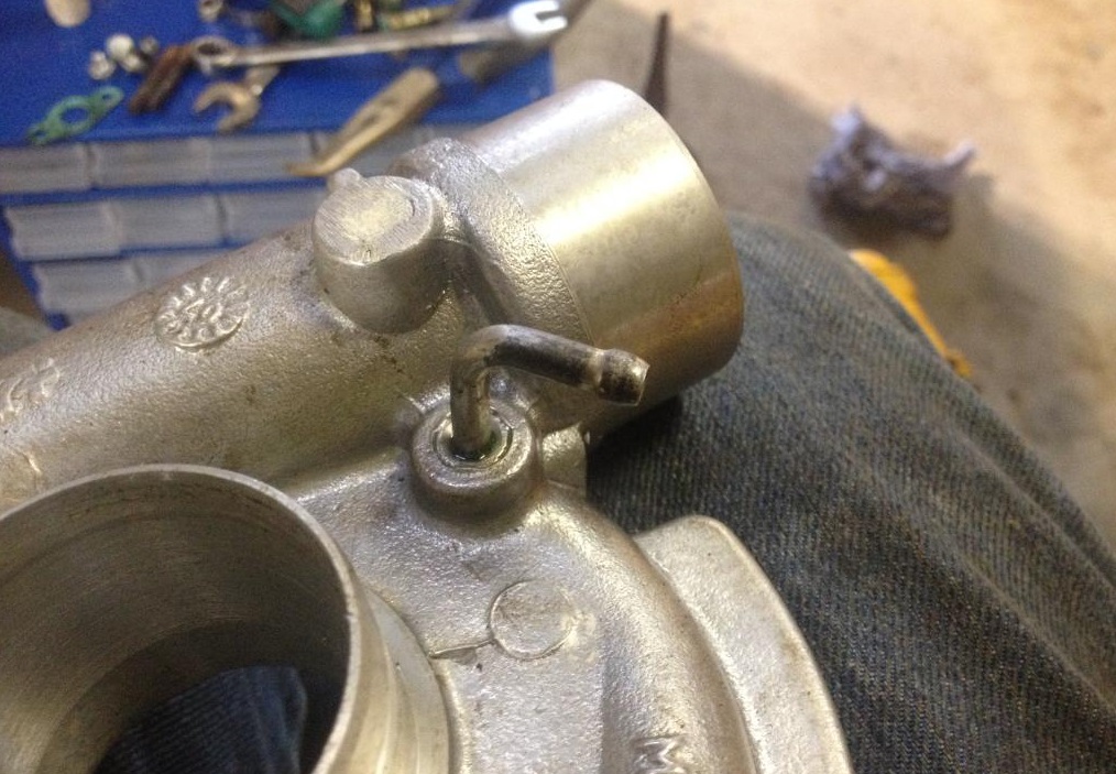

Is this like a pitot tube? It is bored through to the beginning of the "snail" of the compressor exit, I mean where the tube is at its smallest and goes on to widen out to the outlet aperture.
Not that I've been and seen everything but I've never seen this pressure take off used for anything other than the waste gate actuator pressure reference. Does anyone know if it's boost pressure or boost + or boost -???

on my turbo tdo04 12t i dont have this pitot tube ,but i have made a pitot tube on a similiar area on my turbo. This is the place to use for preferece to the fuelregulator and the waste actuator. I have also a pitot tube for presure to the vacumechamber on the carb.

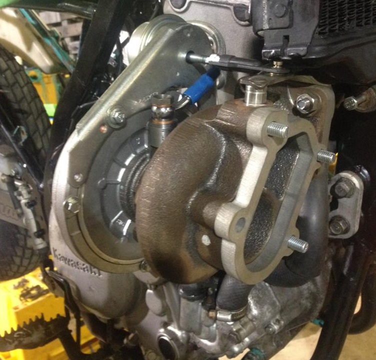

Sorted a couple of bits on the turbo today.
Crofter985 klx650c supermoto build 121.jpeg (169.5 KiB) Viewed 11080 times
That's the oil feed adaptor (m12x1.5 to m10x1.25) shortened and you can also see the turbine outlet adaptor plate that my pal cut out of stainless on a CNC water jet cutter bed.
Crofter985 klx650c supermoto build 122.jpeg (152.53 KiB) Viewed 11080 times
Drilled and tapped two new holes.
There is 5bolts holding the compressor housing on now instead of four.
Crofter985 klx650c supermoto build 123.jpeg (232.2 KiB) Viewed 11080 times
This is in glorious upsidedown-o-vision, I thought the chamfer on the turbo inlet was a bit crap, hardly any, so I got the housing in the lathe and turned a 7 degree taper on the intake, that will perhaps fool a little more air into going into the engine.
Trouble is the compressor exit is probably worse and it's not easy to get in the lathe.

Thanks HP, I think I will just go with that for boost reference then. :) :) :) I love a easy answer!!!!!!!
I am also going to take a boost/vacume reference off between the head and the carb for the blow off valve

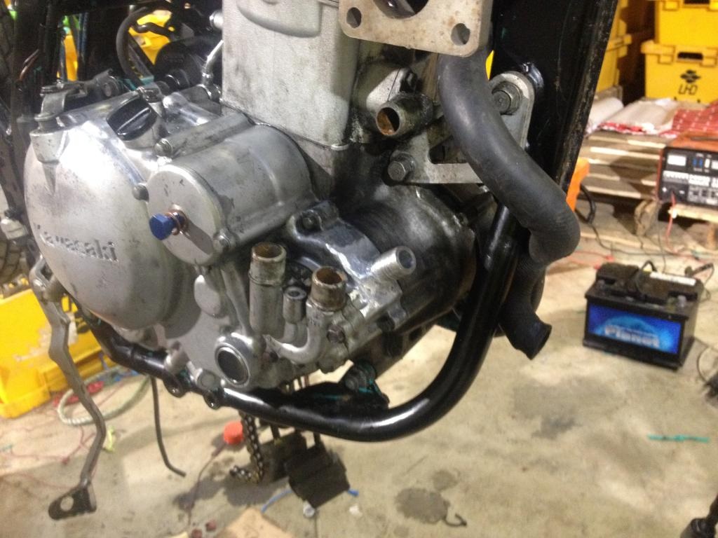

I've decided to put oil return into the clutch housing, it's not so easy to weld the pipe in but it's going to make the piping easy and neat. So here goes.....

The flat bit just inboard of the water pump is where I think it's going to be handiest, slipped off the cover and I took out the water pump drive. But I left every thing else alone.
Crofter985 klx650c supermoto build 126.jpeg (208.24 KiB) Viewed 11080 times
Then I turned a little stub of pipe out of a bit of bar. Drilled it, put recesses to get the hose to grip it better and then parted it off.
Crofter985 klx650c supermoto build 127.jpeg (188.83 KiB) Viewed 11080 times
Then I welded it on, I put a big bit of stainless steel flatbar up against the gasket mating surface to act as a heat sink, to help save the surface, if I had blown through there with the welder it would have been a real f-up. The welding was a disgrace, but as someone invented abrasive flap wheels for grinders I got it to look presentable instead of something out of a nursery school art exhibit.
Crofter985 klx650c supermoto build 128.jpeg (175.67 KiB) Viewed 11080 times
There we go, I raided the engine bay of a old car outside and found a bit of pipe with clips that when cut down fitted like it had always meant to be there.
Now it's all plumbed in for lube anyway, time for a test start, I can't resist it.
