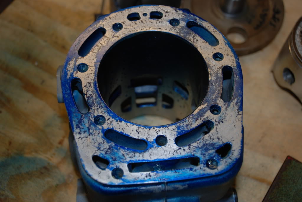

I have looked at filing on it.. and dont see much to be gained..

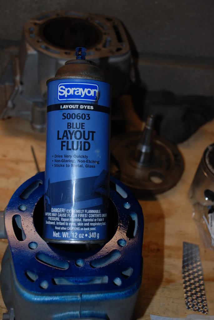

I am going to lay out fluid the intake tomarrow and see if there is anything else that can be done..

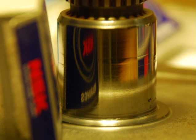

Pics of differant sides (all I have right now and crank is out being rebuilt now) But every inch of my bearing journals had spun marks like this.. On both sides.
Crank journals Before sent off to hardchrome (cant see, but the ignitino side was undersized and the main bearing could be put on and taken off by hand.... (both at room temp)..
Motorrads Jeff Wards Engine build round 2 4-7.jpg (22.9 KiB) Viewed 7223 times
And After hardchrome (yes that is a spot of dirt on lower right corner) and center streek is a reflection

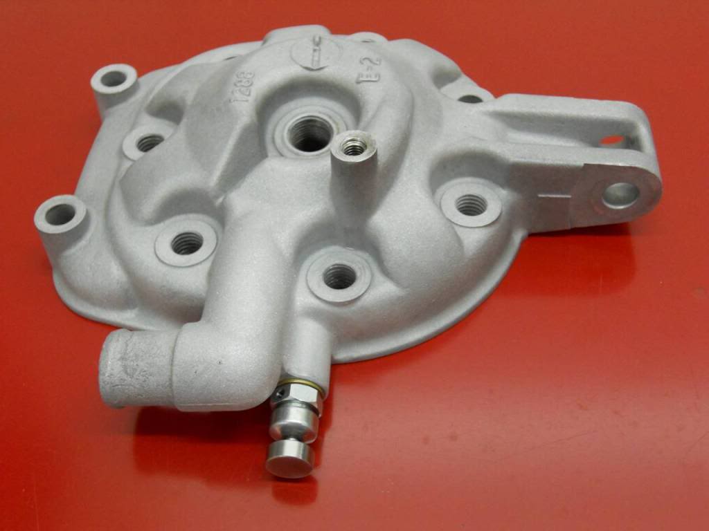

Got my goodie package from Larry..

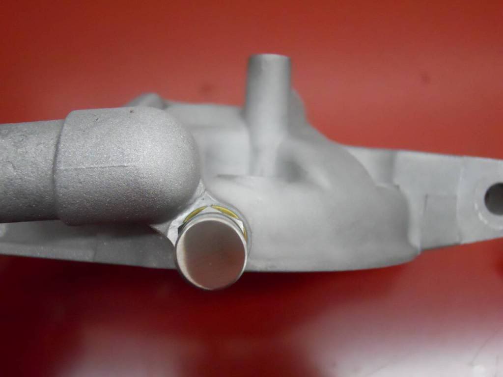

I had to show a good friend of mine a stock head to convince him it wasn't a factory item!
Also.. when Larry says he can fix heads... HE MEANS IT.
I sent him my Old one for measurement reasons.
He tells me "I can fix that"...
Now that I see it... WOW..

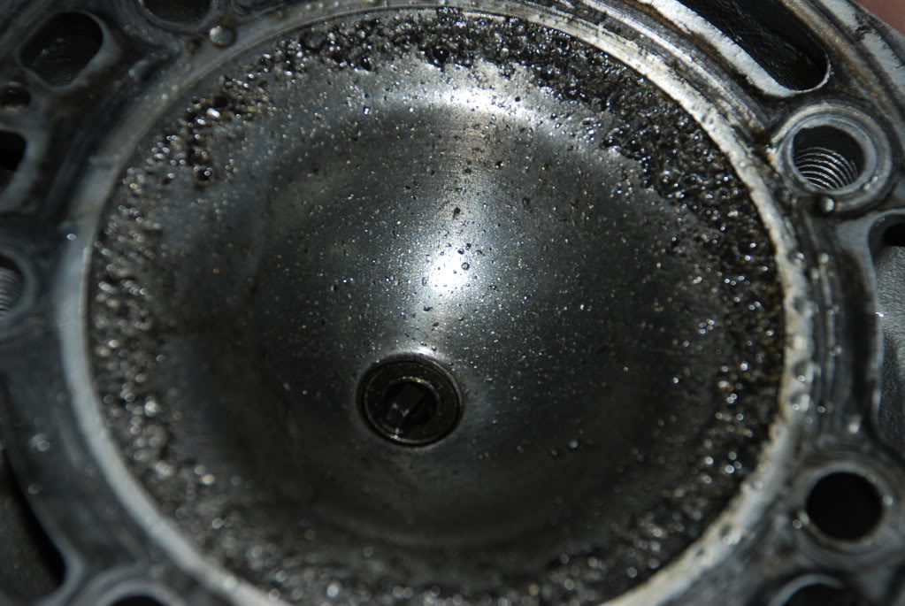

Here is how it was before
Motorrads Jeff Wards Engine build round 2 5-1.jpg (119.88 KiB) Viewed 7223 times
I was pulling pieces of small end bearing out of it like this!
Motorrads Jeff Wards Engine build round 2 5-2.jpg (24.04 KiB) Viewed 7223 times
And here it is after a visit to Larry. Our resident miracle worker.
Motorrads Jeff Wards Engine build round 2 5-3.jpg (70.86 KiB) Viewed 7223 times

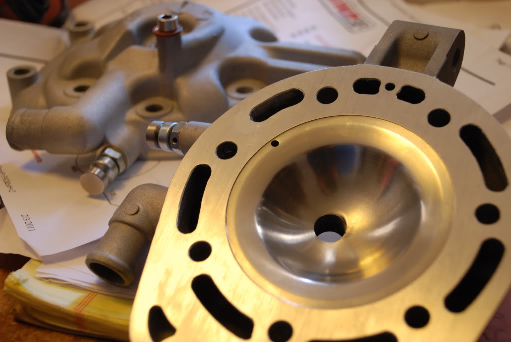

Nothing "special" happened today so far..
Checked the fit of the head to barrel... (while waiting for crank to get cold in the freezer, and sockets to get hot in the oven)
Motorrads Jeff Wards Engine build round 2 5-4.jpg (82.42 KiB) Viewed 7218 times
Motorrads Jeff Wards Engine build round 2 5-5.jpg (96.76 KiB) Viewed 7218 times
Which resulted in
Lapping the head to the barrel..
Motorrads Jeff Wards Engine build round 2 5-6.jpg (69.97 KiB) Viewed 7218 times

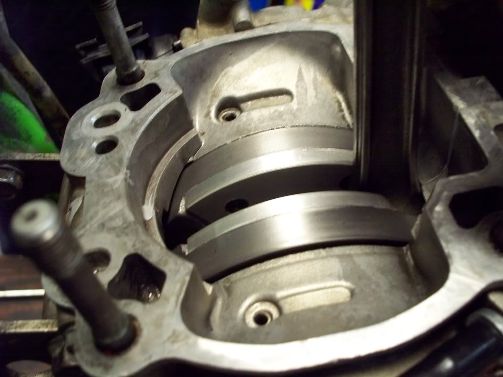

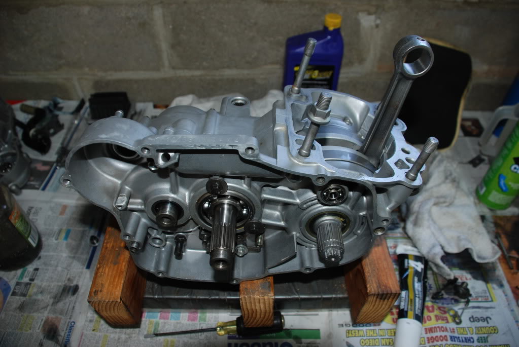

And put the crank in the cases... (Hoooray, bottom end is DONE).
Motorrads Jeff Wards Engine build round 2 5-7.jpg (104.54 KiB) Viewed 7218 times
The crank was at a 58% balance factor...
But after talking to my crank guy. and taking alot of weight out of the piston assembly.( Thank you Kaw Rider) I am now at 60.4%..
which that number (if you play with the program, etc I posted up). has the LEAST amount of forces on the rod. and also the least up and down vibe.
Crank guy said it should be really good, as long as the chassis harmonics play nice.. as alot of balance has to do with chassis...
we shall see...

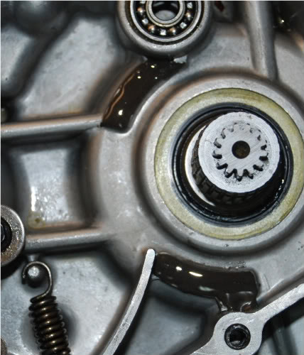

Stuck for the night.

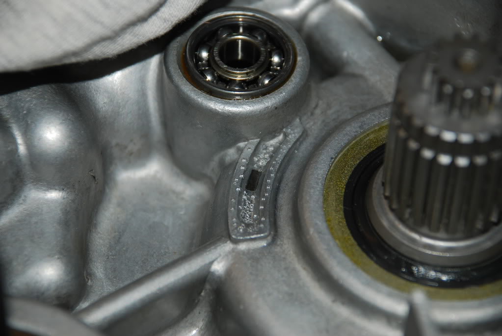

put in all the oil seals..
and took a tip from Kaw Rider.
http://www.kxriders.com/forums/index.ph ... 534.0.html
Used a center punch and a SMALL hamer to Peen up the area, so the JB has somthing to stick to.. (NOTE my cases have been in the Hot parts washer for about 8hrs.. Then sprayed down with 2 cans of brake cleen, then I wirebrushed the areas that were going to be JB'ed, with Acetone... If yours are OILY... JB wont stick..)
Motorrads Jeff Wards Engine build round 2 5-8.jpg (76.64 KiB) Viewed 7218 times
Motorrads Jeff Wards Engine build round 2 5-9.jpg (47.19 KiB) Viewed 7218 times
Okay I lied... I wasnt stuck for the night.. :D
Motorrads Jeff Wards Engine build round 2 6-0.jpg (123.83 KiB) Viewed 7218 times

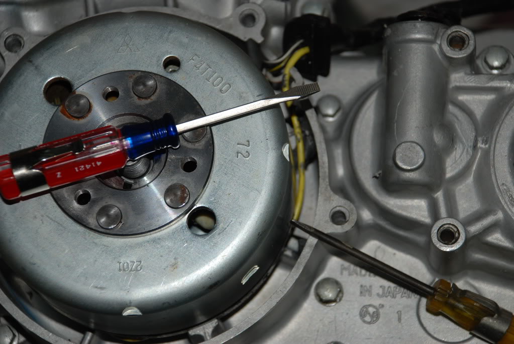

A buddy of mine has a blown up Kdx 220 .. So I snagged his flywheel to look at. As the one sandblaster posted up is NEARLY identical to mine..
interesting thing..
the KDX magnet strength is TONS stronger than my 91 flywheel.. (better magnets? or loss of magnetism) you decide... But the KDX one does weigh 3.5oz more... I contribute it to magnets..
If one was to use the woodrif key, it would be out of time.. (as seen here)
The red screwdriver is where OEM timing mark should be (when using key), yellow is where it ends up on the KDX flywheel.
Motorrads Jeff Wards Engine build round 2 6-1.jpg (111.6 KiB) Viewed 7218 times
Also the HUb is on the wrong side of the flywheel.. causing rub issues on the stator screws...
Going to play with it as much as I can, without cutting on it (cant talk my buddy out of it, as I originaly started the CDI swap idea on here because of this bike..).. the KDX's rev much better than the 500...and have the same weight flywheel.. tells me to look at cdi..
But if one was to not use the key to time it... stronger magnets are a good thing..
anyone ever rivet flywheels back together? if one was to cut it, move plate to inside, and re-rivit closer in clock of 500 flywheel ... Hmmm..
