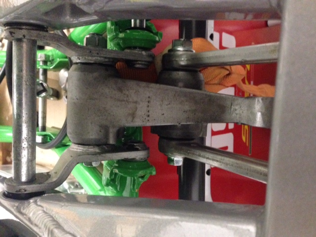

I've solved the problems with link
The bracketa was wrong!
Now without space!"
Re: Lukas 1990 Kawasaki KX500 rebuild in Italy
Looking good!
I knew you would figure out the bracket situation :D

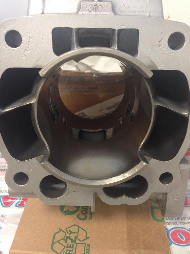

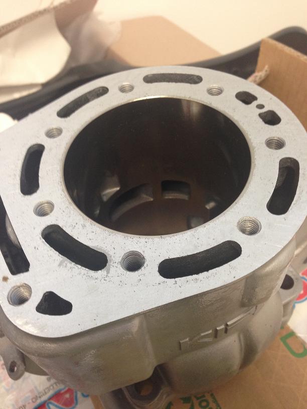

Freshly plated cylinder
1990 kx500 lukas italy build 1.JPG (60.36 KiB) Viewed 10612 times
1990 kx500 lukas italy build 2.JPG (76.11 KiB) Viewed 10612 times
Nice clean up on the transfers and the floor ports :D
1990 kx500 lukas italy build 3.JPG (62.14 KiB) Viewed 10612 times
Take a look at the boost ports and floor ports.
Also note the rough surface of the intake area... Nice...
1990 kx500 lukas italy build 4.JPG (73.25 KiB) Viewed 10612 times
New plating is always so nice...
1990 kx500 lukas italy build 5.JPG (59.9 KiB) Viewed 10612 times

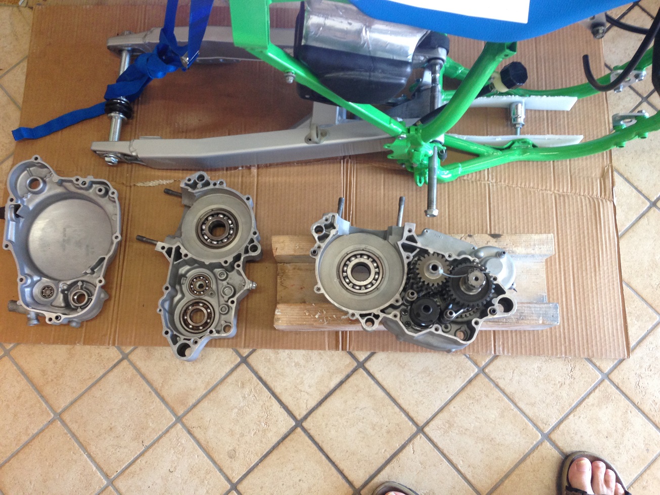

last weekend I started the reassembly of the bike.
With a lot of patience and calm and a cold beer of course!
put the cylinder head bolts just do not lose them
a few hours in the refrigerator and also the bearings are installed!

also the gear selector is wrong, this is for models after 1993 (larger diameter) and it is wrong on the clutch housing. Maybe it's a CR125

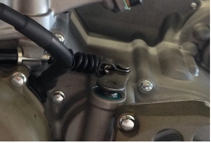

If you want to use a after market shift shaft, You can replace the shift shaft with the newer larger shift shaft and you can use a shift lever from a KX450F.
You can also make your own clutch actuator arm with a longer lever so your clutch pull is easier like this..
As always your work is excellent.

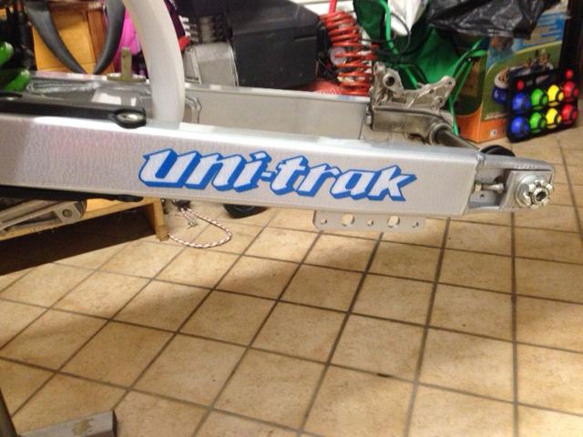

Nice swing arm build.

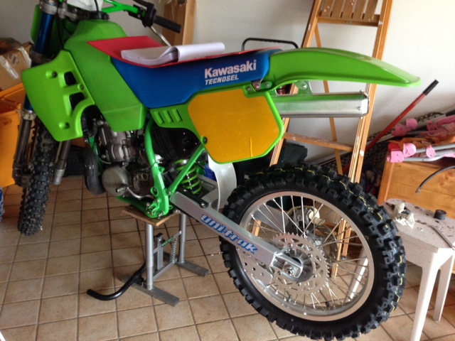

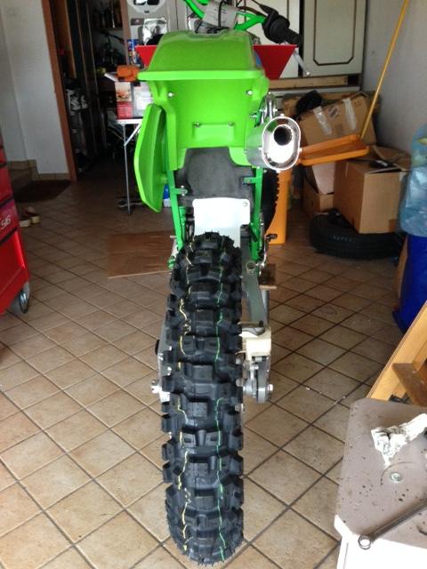

Here is the latest pic updates from Lukas
Very clean and neat work...
It makes me want to take my bike apart and start over.... Except for my engine :D
