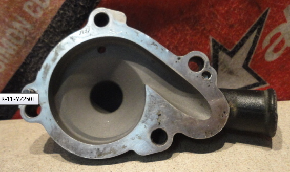

Here's a pic of a cover for a 2011 yz250f
boyesen super cooler 2.png (409.13 KiB) Viewed 16131 times
Again, smooth transitions.

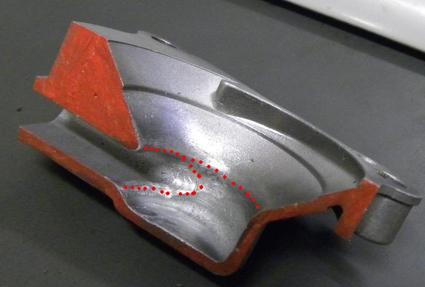

Here is my clearance test fit piece that I have cleaned up the sharp edges on.
I indicated the area's I cleaned up with red dots.
KX500 WATER PUMP IMPELLER CLEARANCE 4.JPG (55.29 KiB) Viewed 16127 times
Let me know what you think :-)

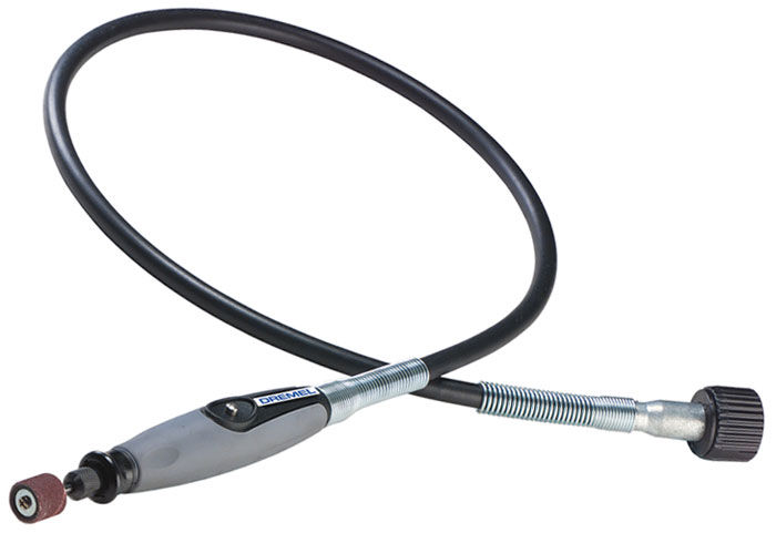

I think it's too hard to get in there and do much.
How did you do it?
Posted: Thu Mar 21, 2013 2:15 am
Say hello to my little friend :D
It takes only a few minutes to do what you see.
Posted: Thu Mar 21, 2013 2:42 am
by Qsixteen
The green stuff
Posted: Thu Mar 21, 2013 2:46 am
Isn't that nice :D
