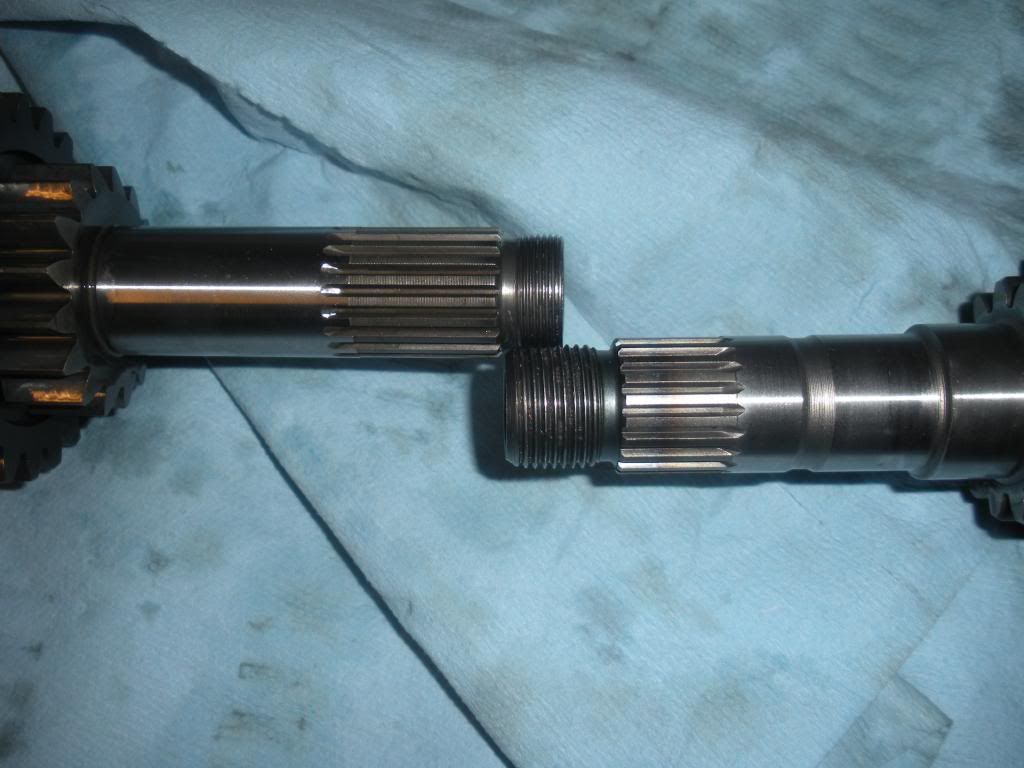

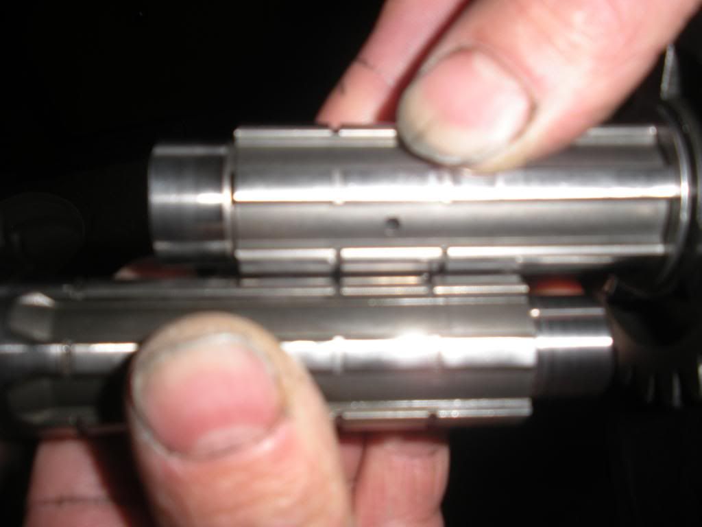

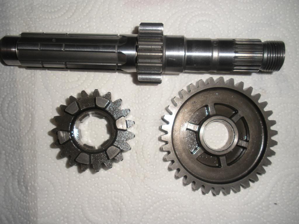

These are the parts you'll need from a 1993 klx650r ; inputshaft, 1st gear output gear, 1st gear selector, clutch hub nut ,not pictured. You'll also need all the klx650r gear spacing washers, which arent pictured either.

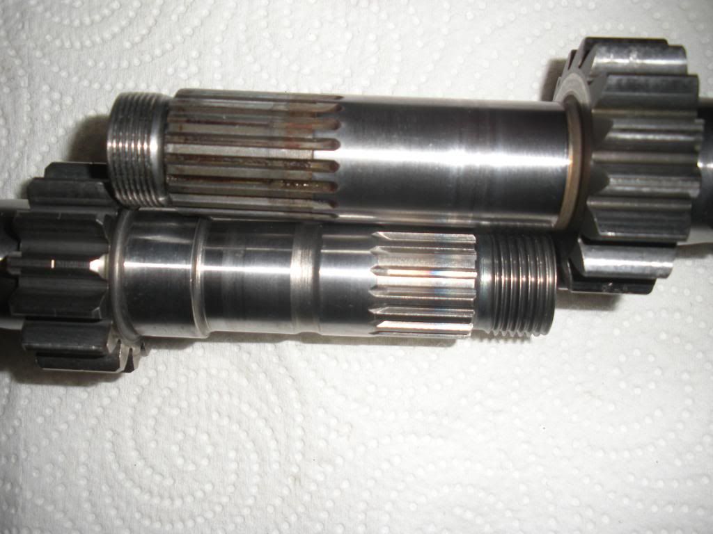

Then you have to shorten the klx shaft to the k5 length, a little off each end. The bearing surface on the clutch arm end is where you shorten on this side

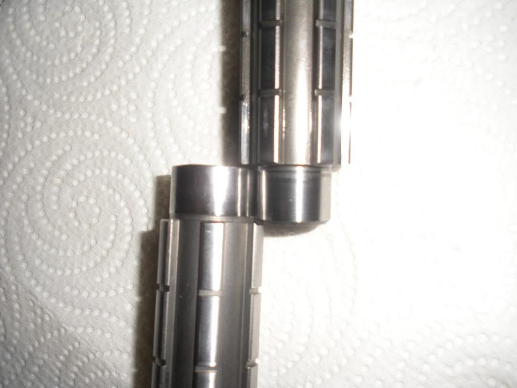

Just a couple threads off on the other
To where they're the same length like here

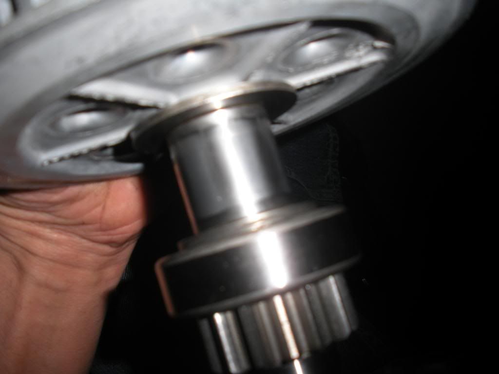

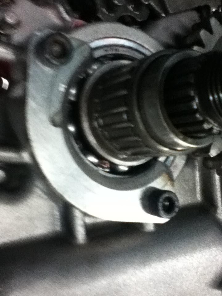

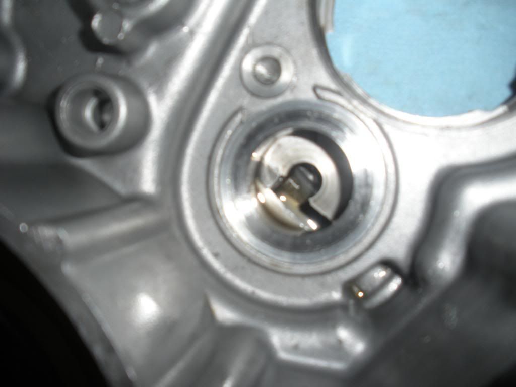

The input shaft requires different bearings with custom carriers to fit it. I cant find my pic with the measurements & honestly if your this deep you really need to calculate it yourself. The clutch side bearing is a TMB205. You can see the carrier here, notice the retainer.
Dont use the stock style washers to retain like this, it does not work.
The clutch arm end uses a hk2012b bearing. I didnt click a pic of the finished product
but heres a pic of the trial carrier installed

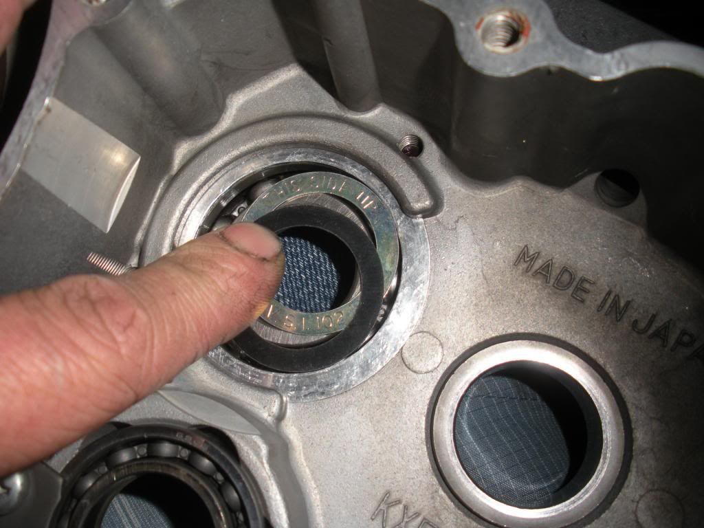

The other side of the clutch bearing carrier needs to be cup shape as the factory tangs wont catch the smaller tmb205 bearing, so it must be shimmed I used valve spring shims to regain the +1mm, I say +1mm because my carrier is .010 wider than necessary to load it tight against the bearing retainer on the other side. When installing these shims Load everything in the case & check shiftfork allignment, I had to teardown because I didnt check

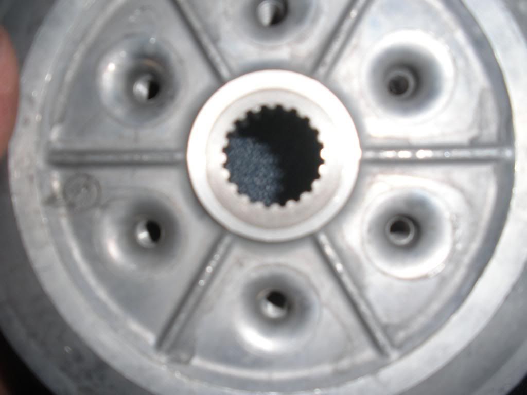

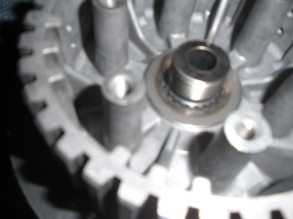

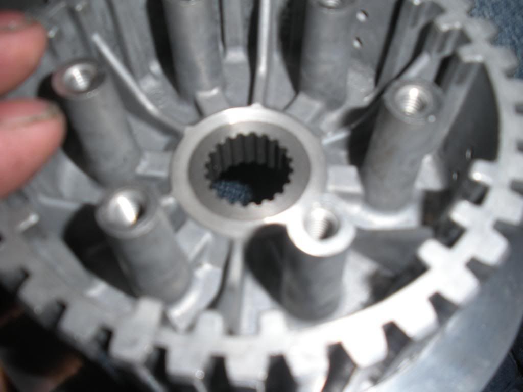

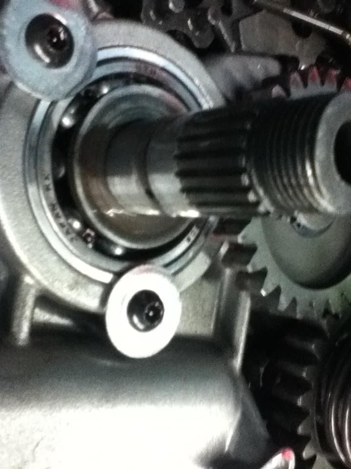

With the shift forks & drum all in place loaded in the clutch side case looking at the gear dogs is where the centering takes place. I've got a .015 & a .030 shim in there which ='s the +1mm. One you've installed the shims & gotten the gears centered in neutral, you have your spacer figured, so you can load the spacers, tmb205, clutch hub bearing carrier with washers to see how much you need to thin the hub.
You need exposed thead for the lockwasher engagement with all ^^ that on it
I took even amounts of both sides of the hub
I didnt want to take any more than necessary here for strength obviously. When I final assembled I had to be careful not to push the shaft in or the lock washer would fall off the engagement threads. You also may need to shorten you clutch pushrod or add more washer to the pushrod hub bearing guide. They already have one washer you could order more if needed.

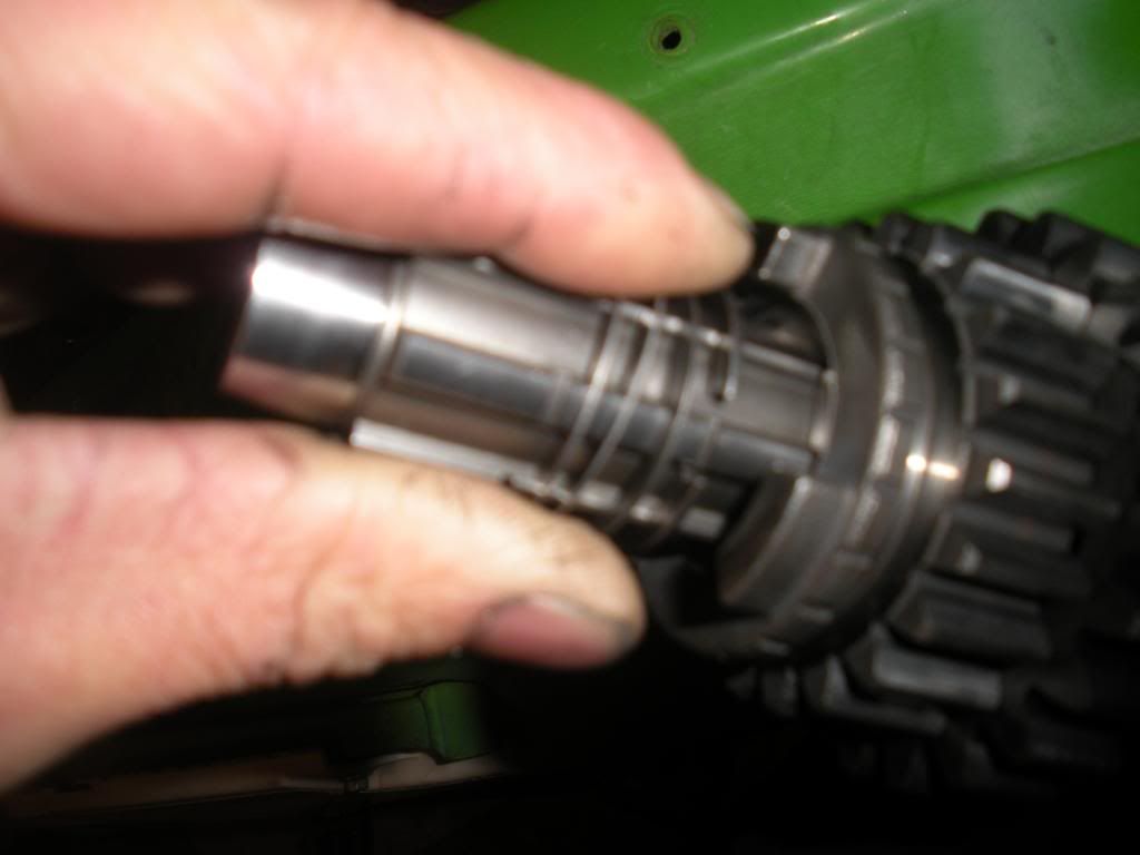

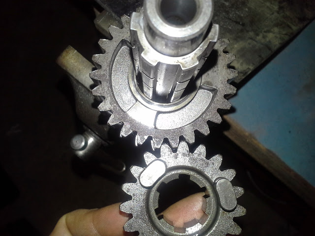

The 2nd to the last circlip groove , on the clutch arm side, is a snap rings width off of where it should be.
So the gear needed to be cut in a snap ring & 1/2 width so the dogs would engage fully, de-burr with a dremel & fine stone so it slides on the shaft smoothly
Then you take all the washers from the KLX-R trans, which = 1 snap rings width, to push the outer gear where it needs to be

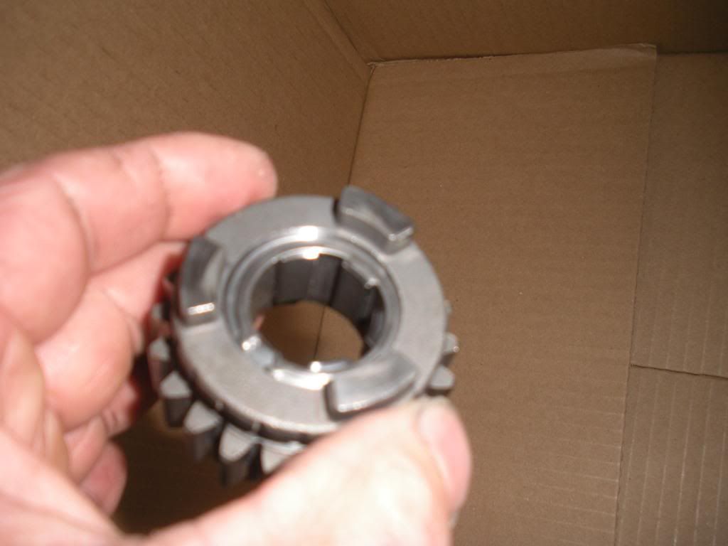

The first gear output & engagement gear are drop in items, nothing special, it does give you 6 shift dogs for 1st instead of 3 like the KX.

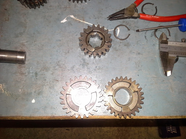

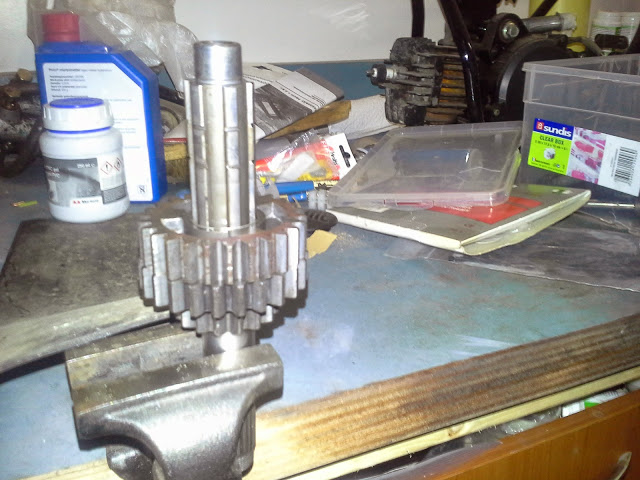

I may have a idea for 5th gear in, only it's for the K5 transmission
Here you see 3rd output(26t) laying on top of 5th input(24t) with 5th input gear next to it
Side by side, Only third is 64.5mm and 5th is 66.6mm
So in stead of having 19/24, you having 19/26. Not the famous Overdrive of 18/26, but it's a start.
