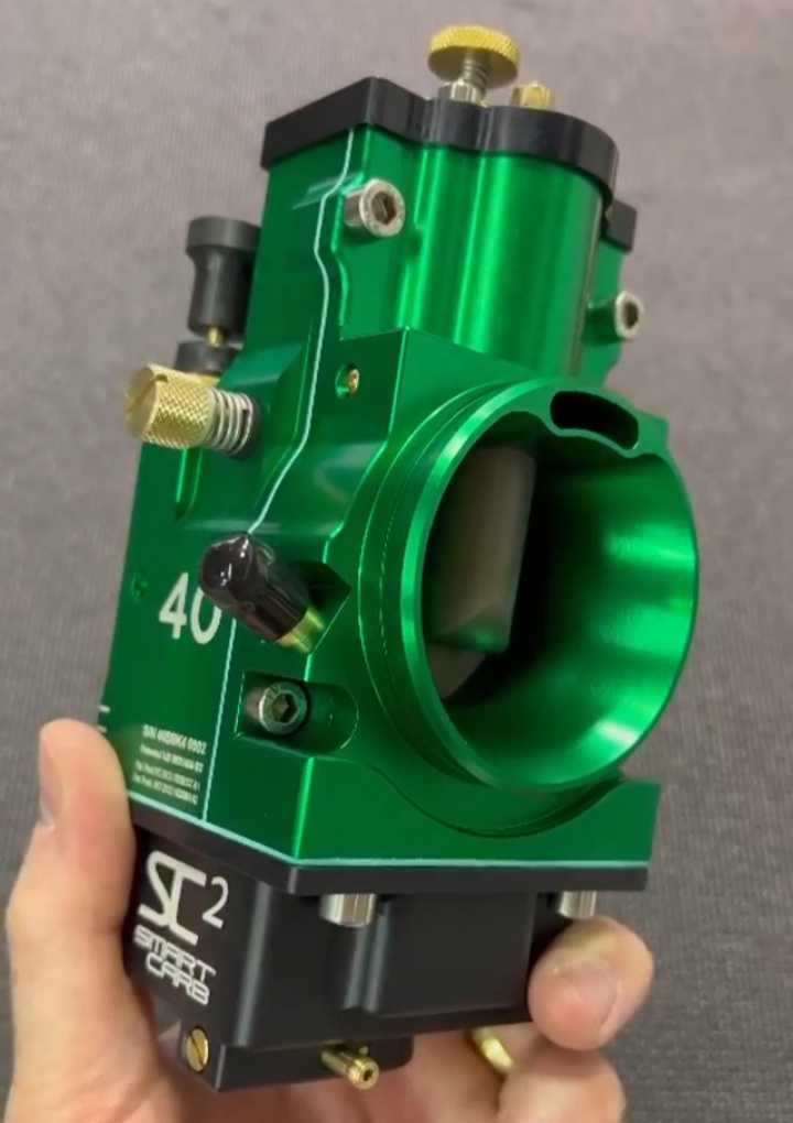

I think I'm going to try a Smart Carb SC2 on this build.
The fact that you can set the carb up and do huge changes in elevation and you don't have to mess with jetting is a real plus.
But how will it perform?
Stay tuned for a review at some time in the future..

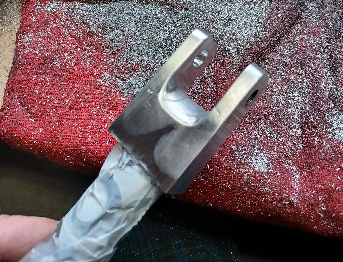

I have the new shock shaft modified to fit the KX500 linkage.
I had to shorten the clevis, Drill and tap the bolt hole, and clearance the inside of the clevis.
The next one I do I will clearance the linkage a bit more so I can take less from the shock.

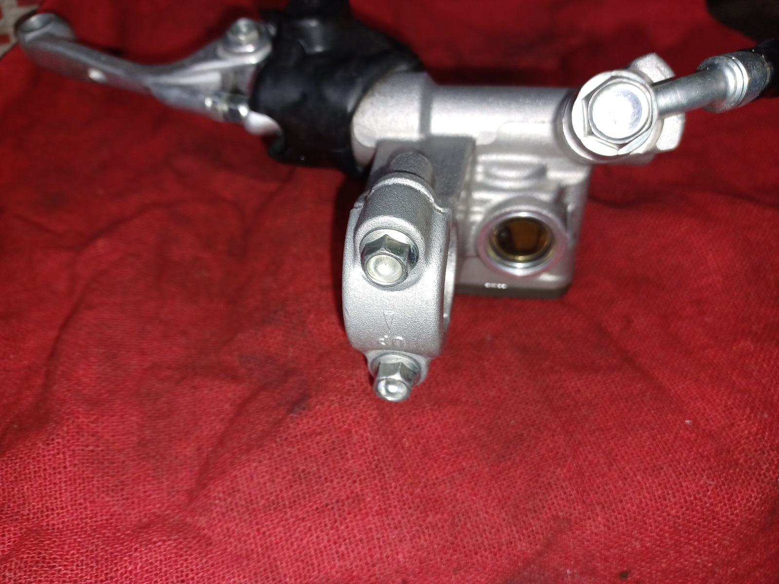

I cleaned up the 2019 KX450F front brake set up and will be replacing the hose with a SS Galfer... 8-)

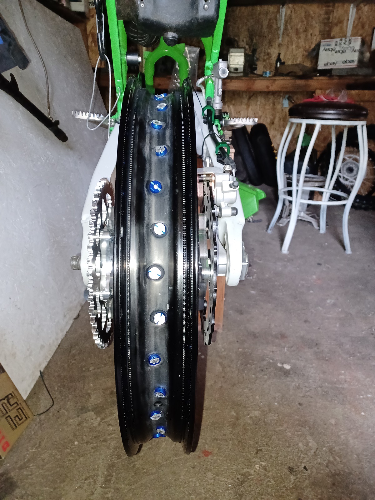

The Warp 9 Racing wheels are in and look great.
Their build time and delivery was incredible at only 1.5 weeks.
