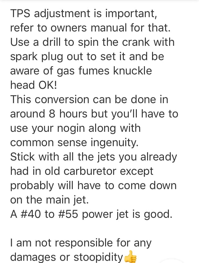

Kx500 TPS and power jet how to by Leo Sadzewicz
Re: Kx500 TPS and power jet how to by Leo Sadzewicz
Leo Sadzewicz: I’d like to mention the kx250 has 3D mapping which is one of the things that makes this mod SO sweet 😁
The power D just has one curve to my knowledge and cannot support a tps or a power jet.
That is the reason I didn’t buy the power D

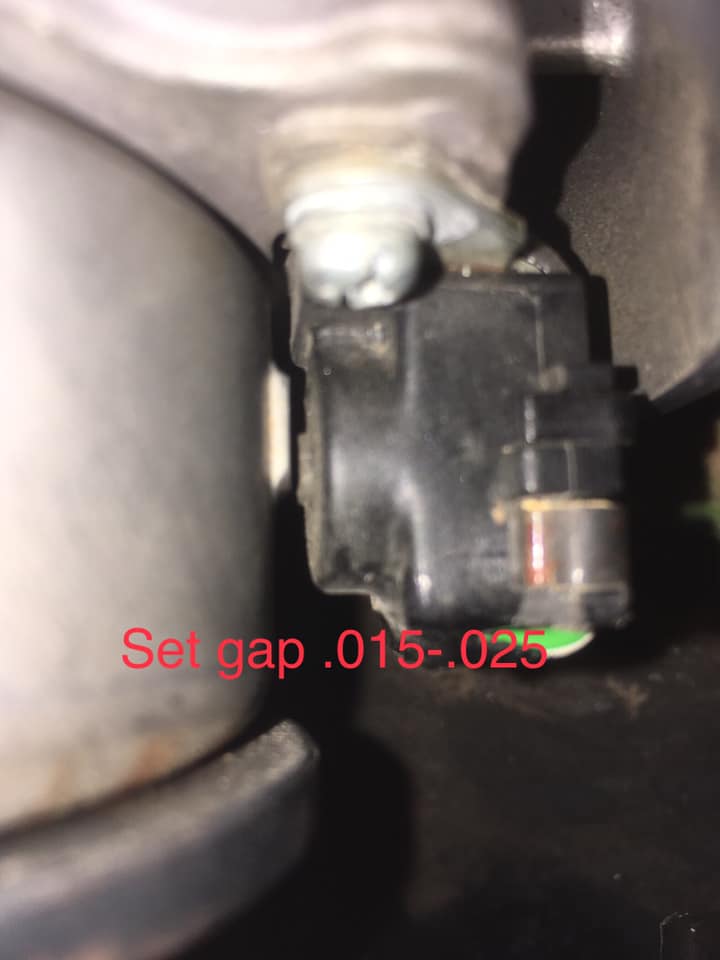

Update from Leo Sadzewicz:
Timing needs to be here or even a little more advanced or top end will be a little flat
TPS STATOR SETTING.jpg (34.85 KiB) Viewed 13477 times
