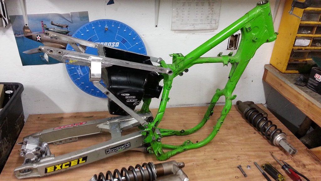

Before I go any further, I need a mock up.
Turns out I just happen to have a few spares laying around...
Except for the stupid swingarm that I had to buy on eBay :?

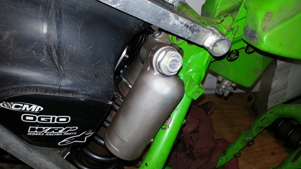

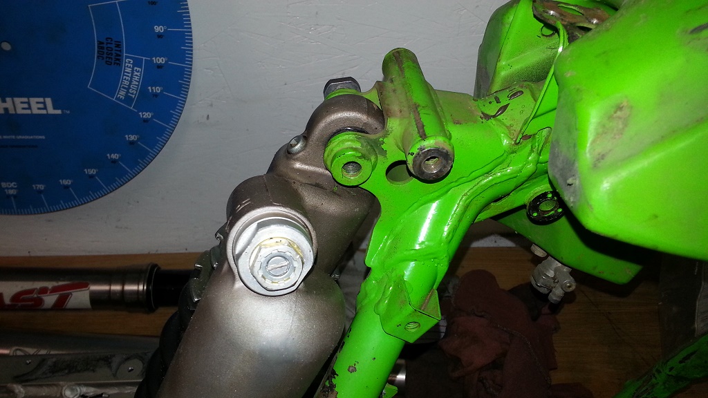

But it does not work :shock: :o :shock:
Note the location of the shock reservoir.
Note that the reservoir goes right through the middle of where the pipe is suppose to go.
So the two choices I see is to reroute the pipe or move the reservoir...
More to come 8-)
