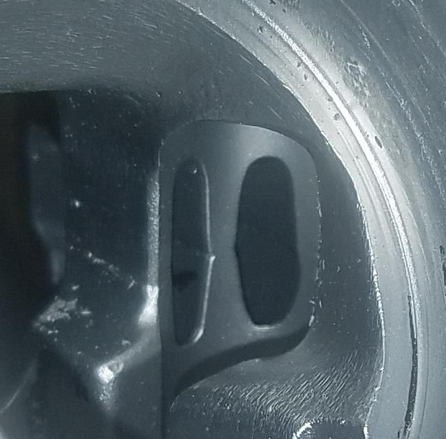

Here is a view from the exhaust port... Before..

And after the rough cutting is done..

Now I need to finish the other side to match.
Then, I need to install the exhaust valves and mark them so that I can get the ports to match the open and shut position of the valves for maximum flow.. Breathe baby breathe!
