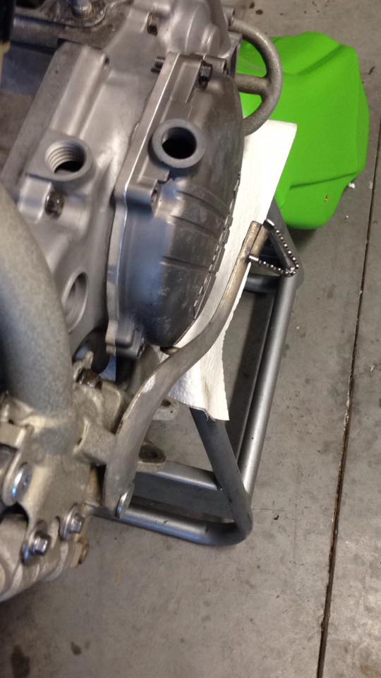

KXGURU.COM KX500 REAR BRAKE MOD 108.JPG (199.48 KiB) Viewed 16636 times
All the way down.... No problem..
KXGURU.COM KX500 REAR BRAKE MOD 109.JPG (152.5 KiB) Viewed 16636 times
All the way up.. Perfect

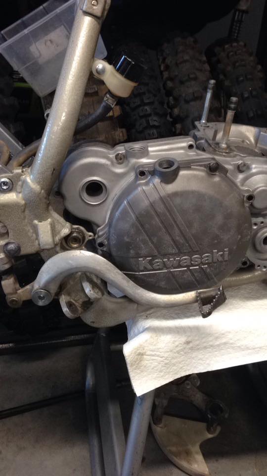

KXGURU.COM KX500 REAR BRAKE MOD 110.JPG (171.1 KiB) Viewed 16636 times

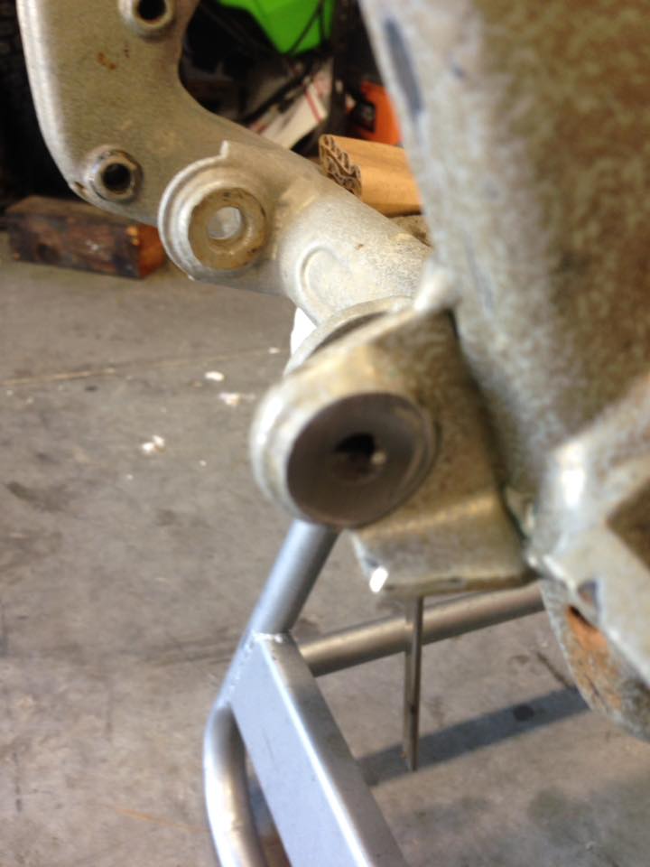

Ok... I received a cheapo rear brake lever with a folding tip...
KXGURU.COM KX500 REAR BRAKE MOD 112.JPG (375.29 KiB) Viewed 16622 times
KXGURU.COM KX500 REAR BRAKE MOD 113.JPG (366.08 KiB) Viewed 16622 times
Looks good...
Pressed in two bushings and...
KXGURU.COM KX500 REAR BRAKE MOD 114.JPG (219.98 KiB) Viewed 16622 times
Fits perfectly...
