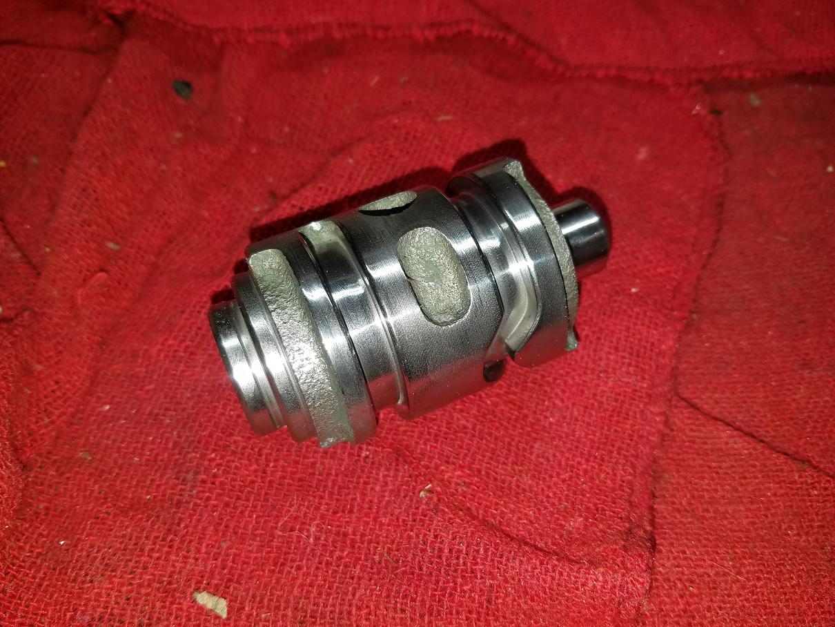

It's really hard to see but I got the edges of the grooves nice and shiny..

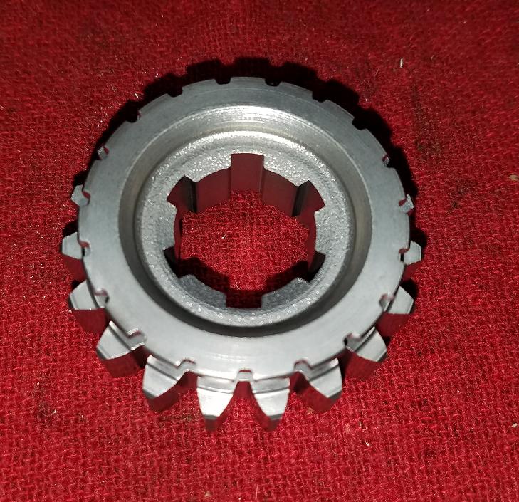

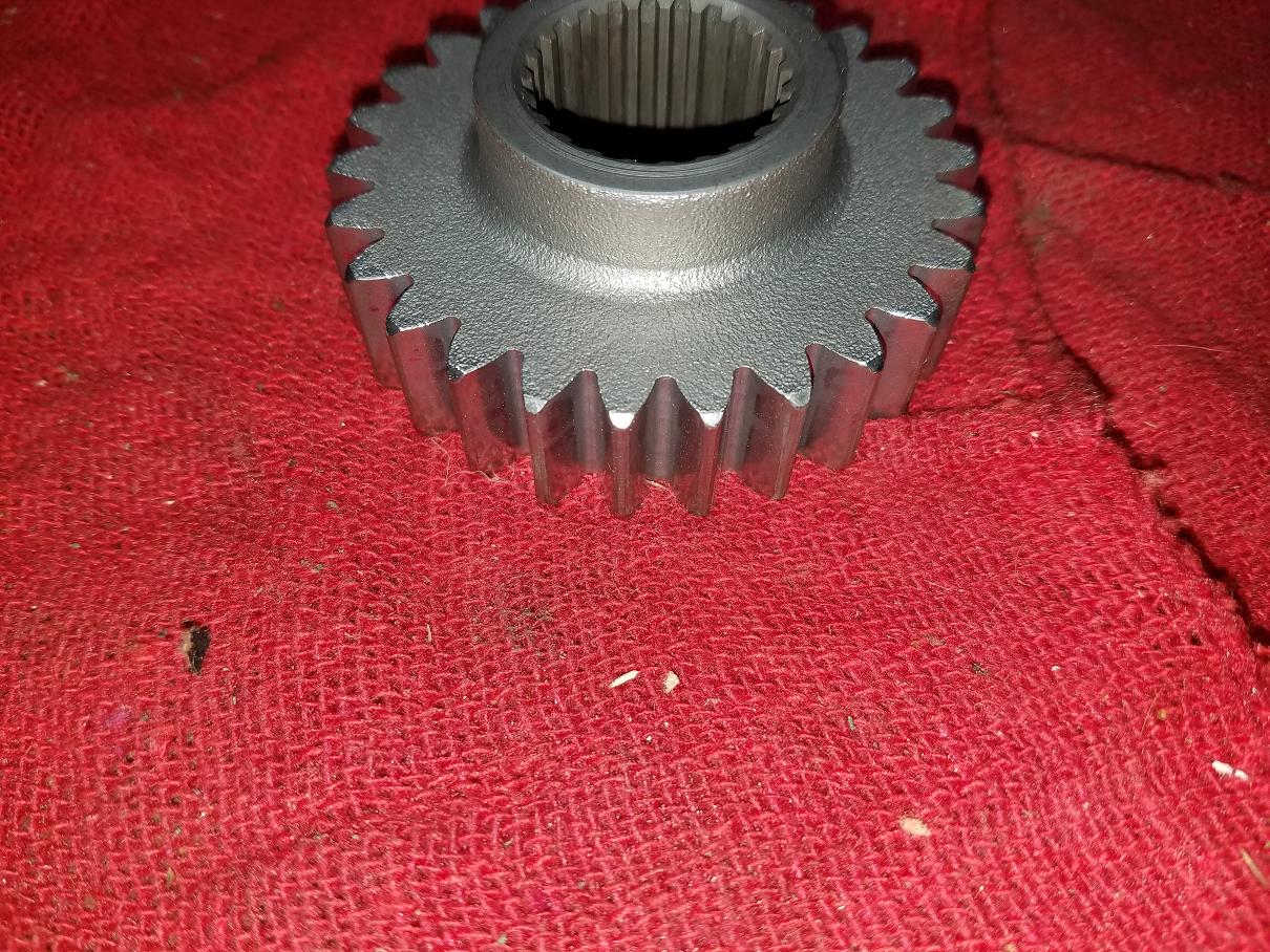

Just a touch of clean up on the Primary crank gear and the kick idler gear..

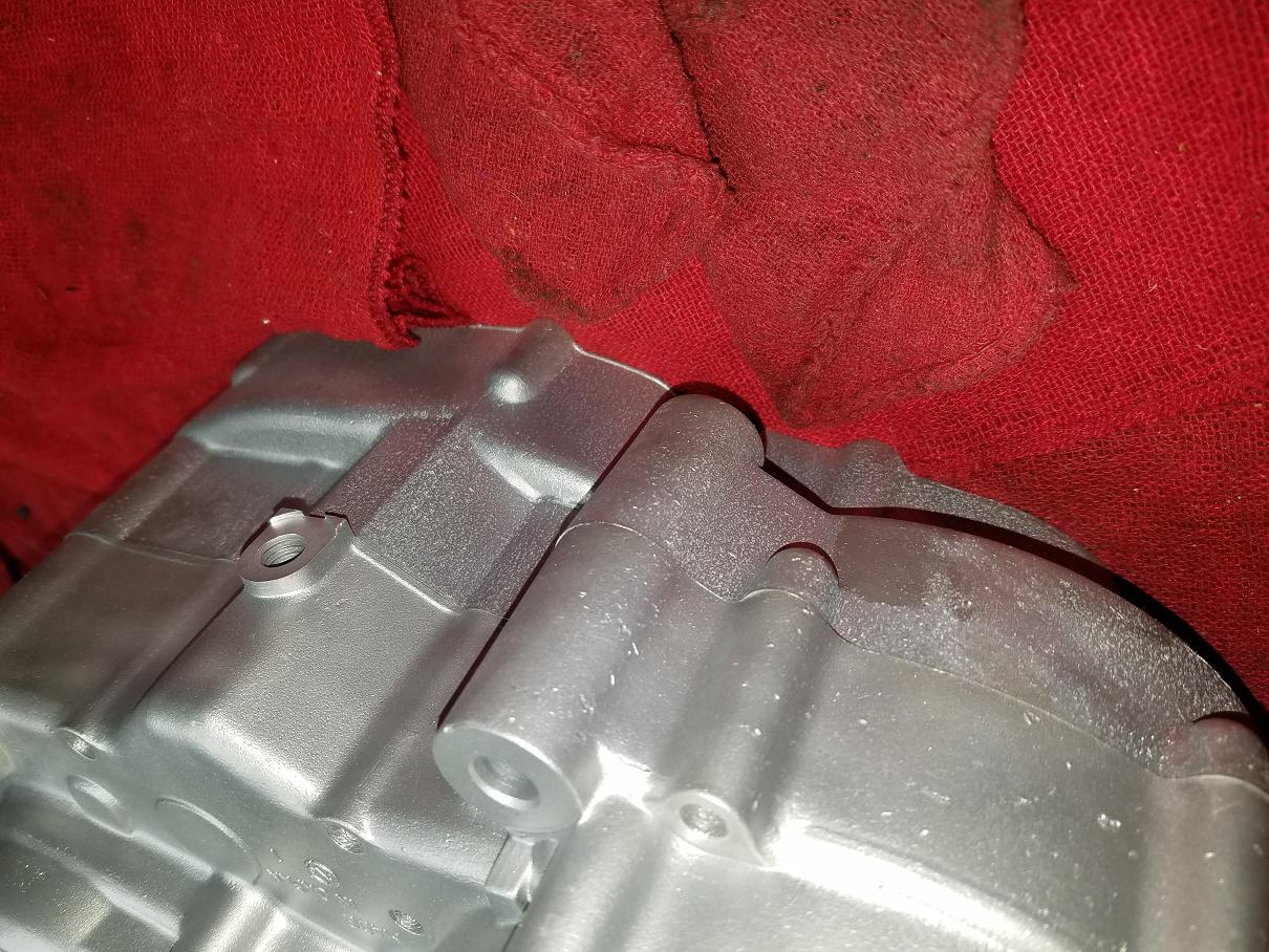

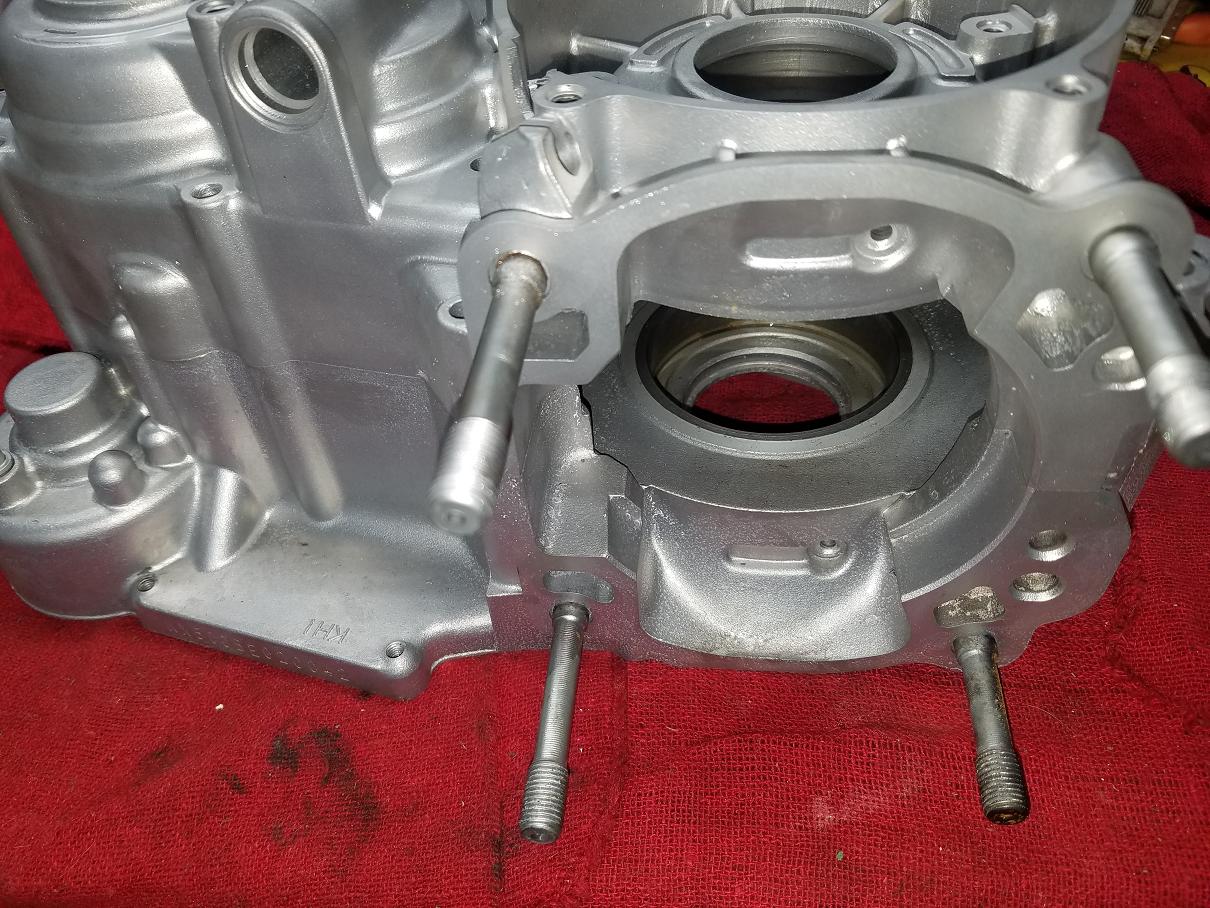

Almost done with the cases...
KX GURU RACING SEAN COLLIER KX500 187.JPG (227.05 KiB) Viewed 12805 times

KX GURU RACING SEAN COLLIER KX500 188.JPG (231.96 KiB) Viewed 12805 times

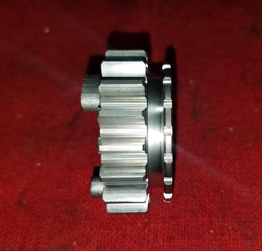

Unfortunately a bunch of the gears were really worn so Jason spent a lot of time cleaning them up including touching up the dogs.
The results are pretty good.

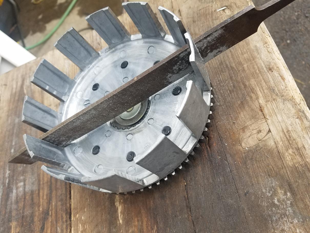

Posted: Sat Oct 08, 2016 3:49 am

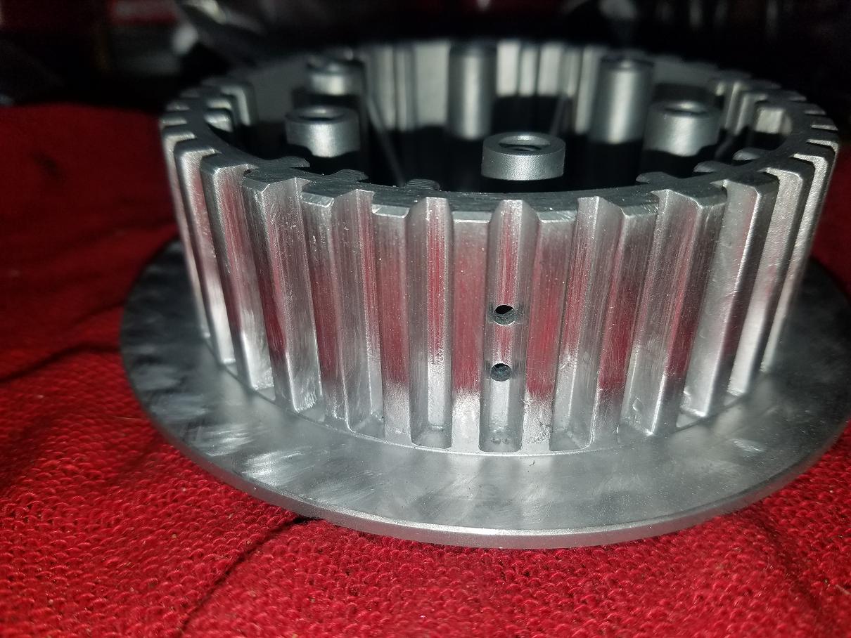

I really hate filing clutch baskets.
For as long as it takes to file one down you could buy a new one.
But again, that isn't in the cards so I'm doing the best I can with what I have to work with..
KX GURU RACING SEAN COLLIER KX500 199.JPG (225.63 KiB) Viewed 12789 times
KX GURU RACING SEAN COLLIER KX500 201.JPG (116.54 KiB) Viewed 12792 times

And we discovered today that the cylinder mounting area on the cases are off by about .001" from one case to another so it's off to the machine shop on Monday... :(
