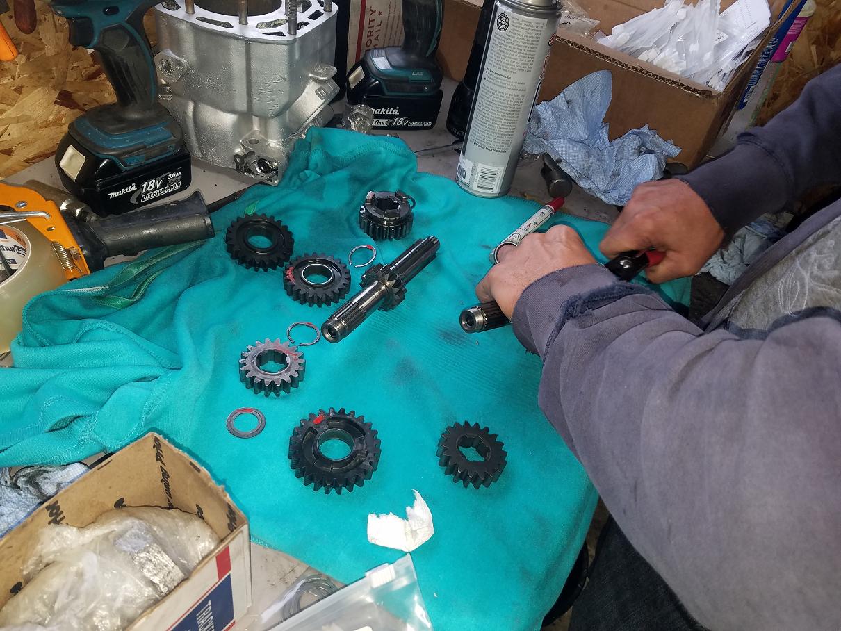

Just a touch of clean up on the Primary crank gear and the kick idler gear..

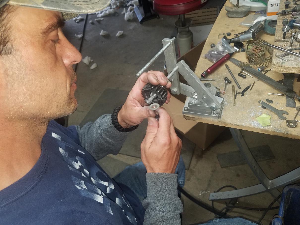

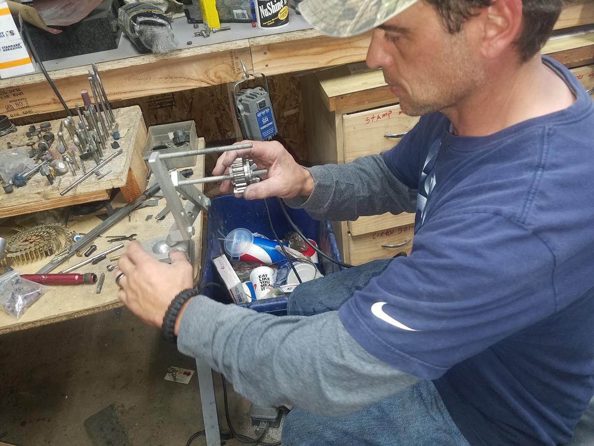

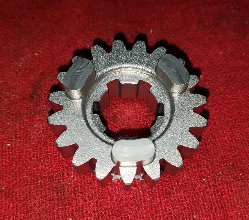

Unfortunately a bunch of the gears were really worn so Jason spent a lot of time cleaning them up including touching up the dogs.
The results are pretty good.

JASON!!!!! I TOLD YOU A MILLION TIMES TO WEAR YOUR SAFETY GLASSES!!!

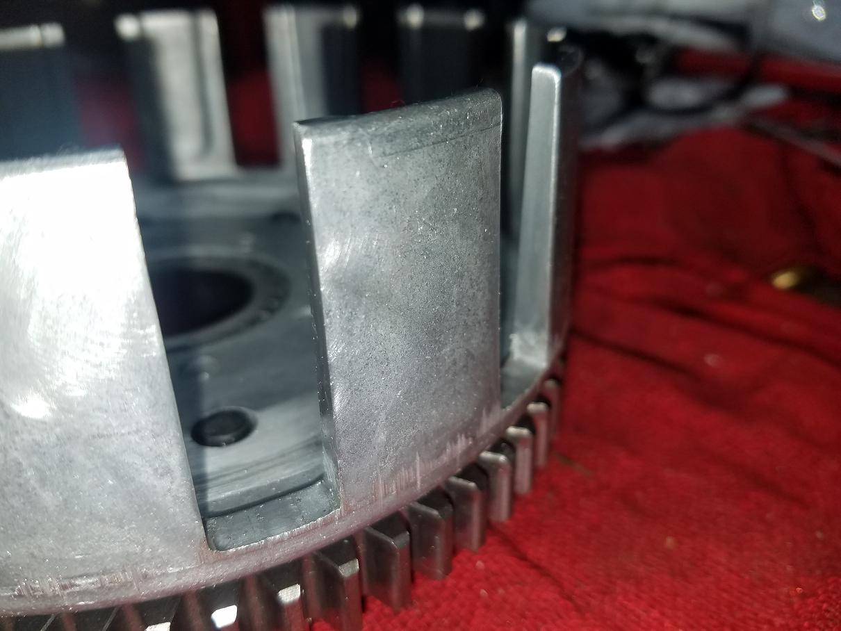

I really hate filing clutch baskets.
For as long as it takes to file one down you could buy a new one.
But again, that isn't in the cards so I'm doing the best I can with what I have to work with..
