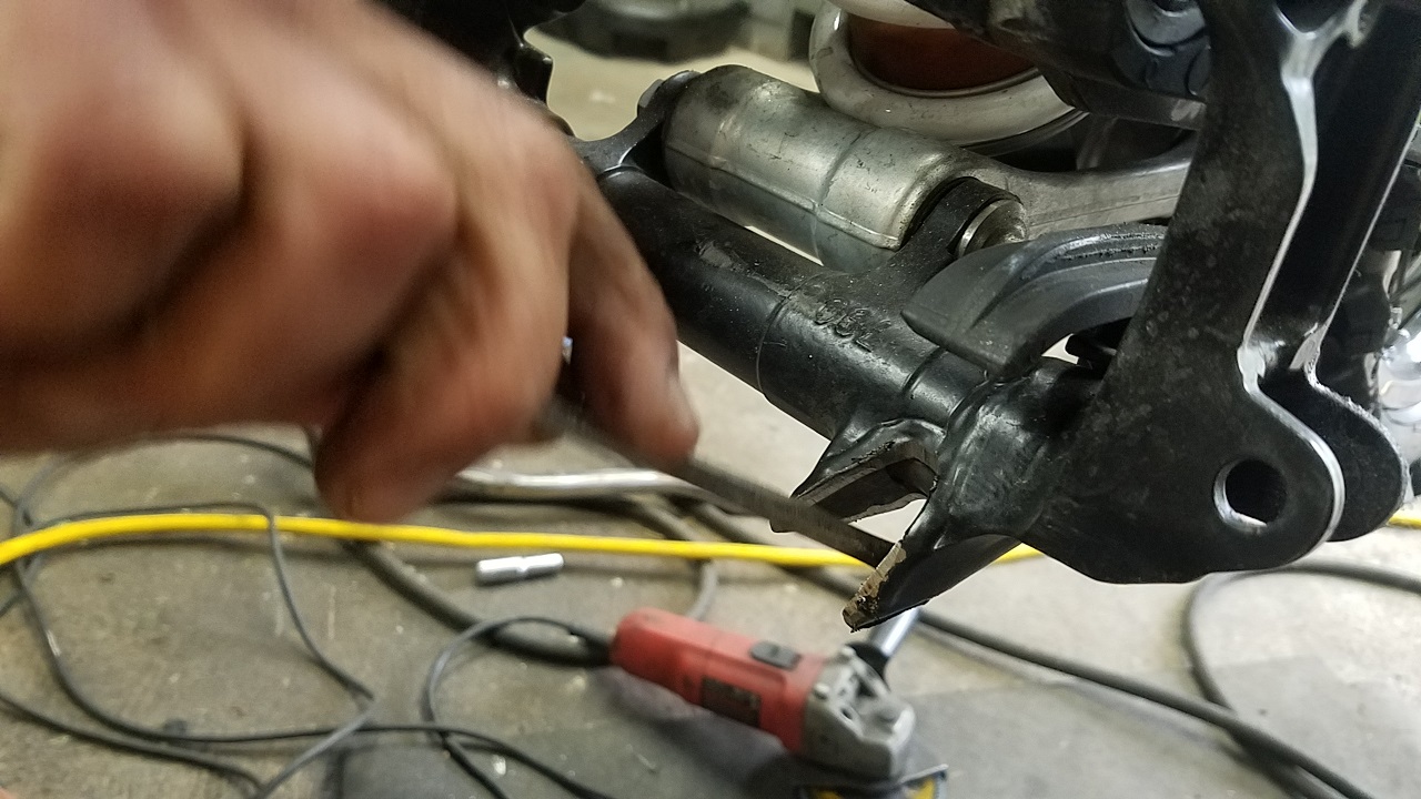

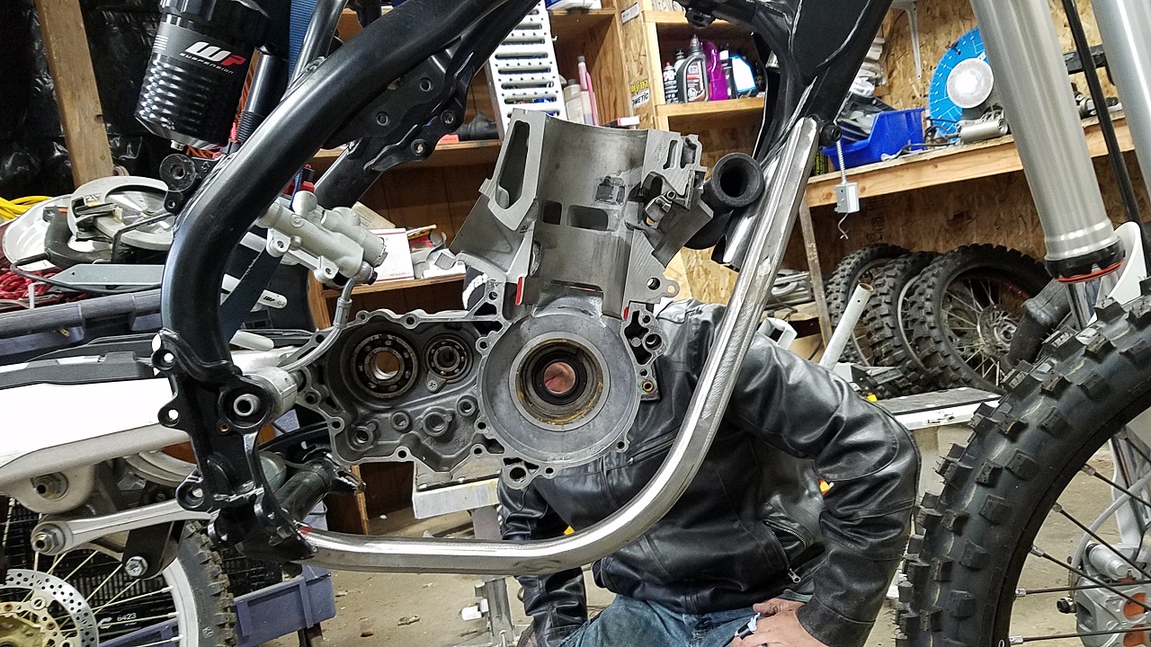

You can see by this pic that Jason and I cleaned up the front mounting area of the frame rails..
KX GURU RACING 2016 KTM 250SXF KX500 CONVERSION 123.jpg (363.13 KiB) Viewed 9960 times
Jason is cleaning out he rear mounting area for the frame rails.
It is a real pain so if your gonna do it, be aware that the 450 rails we used are 1.5-2mm wider then the 250 rails.

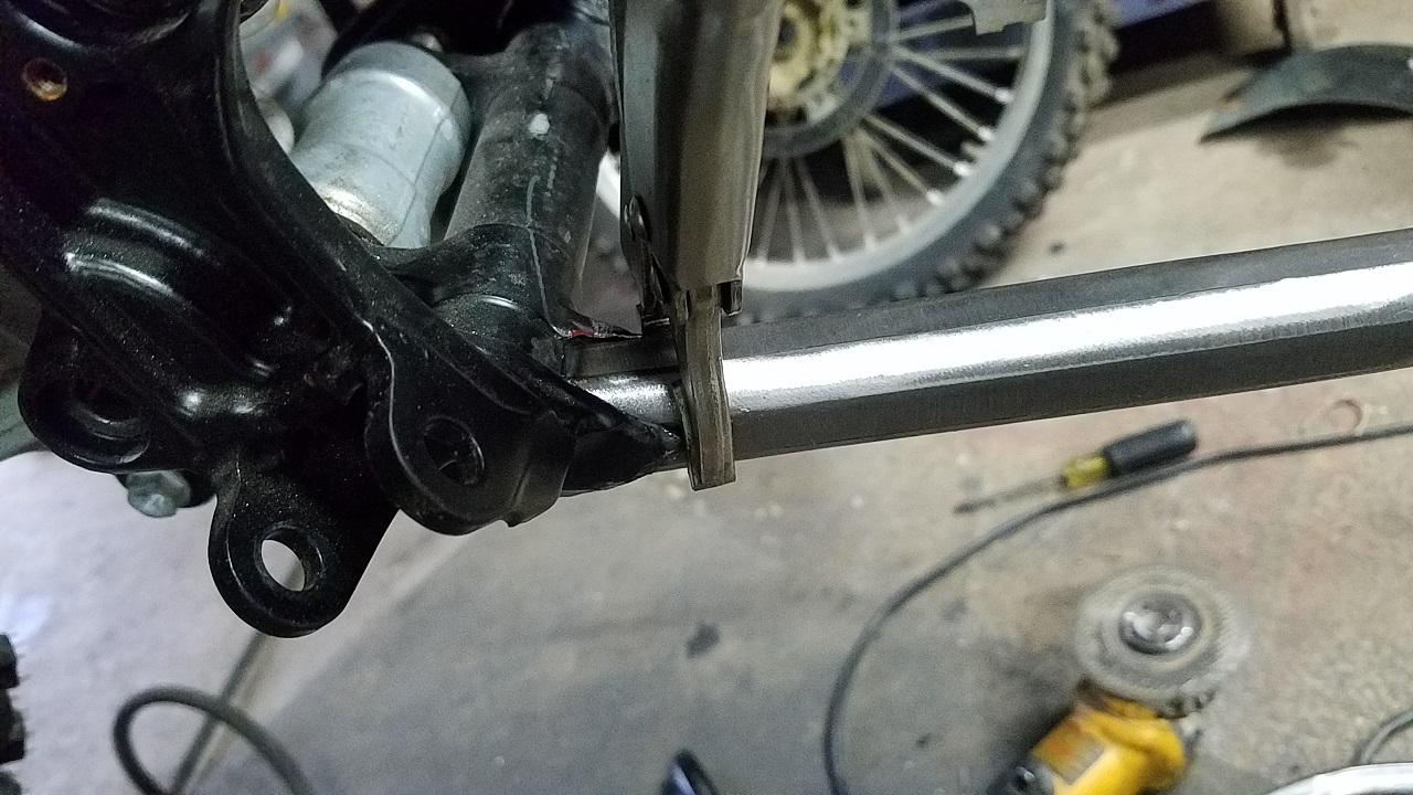

KX GURU RACING 2016 KTM 250SXF KX500 CONVERSION 124.jpg (419.58 KiB) Viewed 9960 times
Yeah, you gotta clean out all the old rail material... have fun...

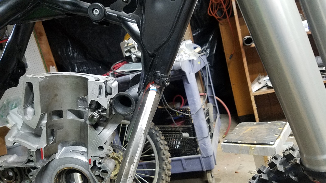

Easy does it... Take a little off.. check the fit... Mark it... take a bit more off... Check it... :lol:
KX GURU RACING 2016 KTM 250SXF KX500 CONVERSION 126.jpg (435.72 KiB) Viewed 9959 times
Checking again and again...

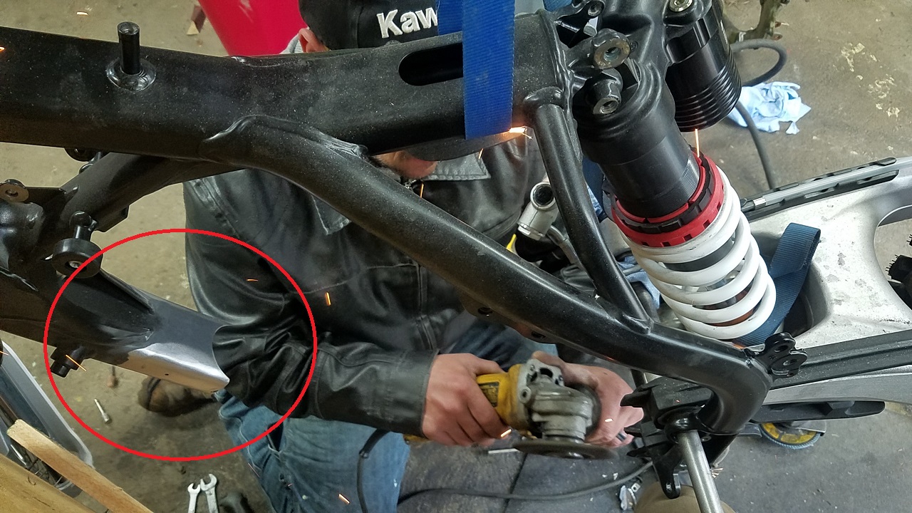

KX GURU RACING 2016 KTM 250SXF KX500 CONVERSION 129.jpg (369.87 KiB) Viewed 9957 times
KX GURU RACING 2016 KTM 250SXF KX500 CONVERSION 130.jpg (333.84 KiB) Viewed 9957 times

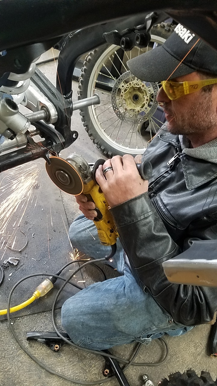

Ok... I just need to make another to match but a mirror image :roll:
Jason loves grinding :lol:
Good thing because the swingarm needs just a bit of clearance to the engine case and clutch cover.

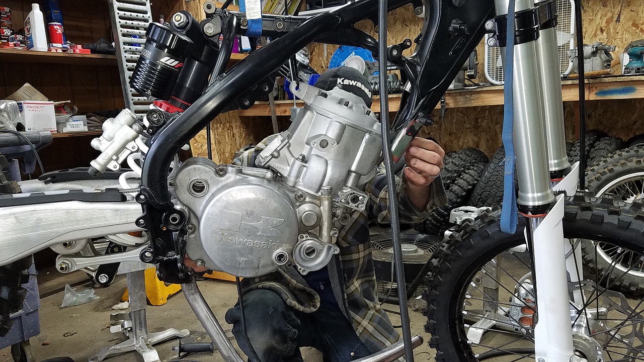

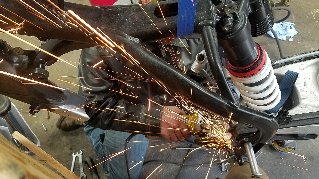

Jason is aligning the engine with the frame rails, swingarm, sprockets, and a host of other issues 8-)
KX GURU RACING 2016 KTM 250SXF KX500 CONVERSION 132.jpg (505.73 KiB) Viewed 9947 times
Trim, disassemble, check, reassemble, trim, ect, ect...

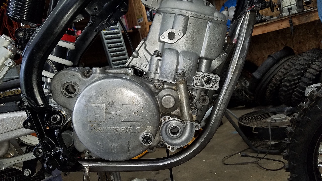

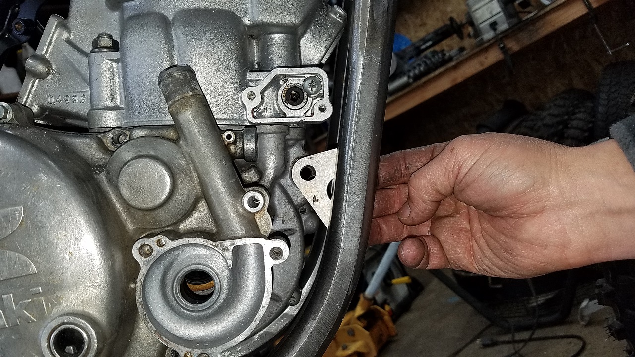

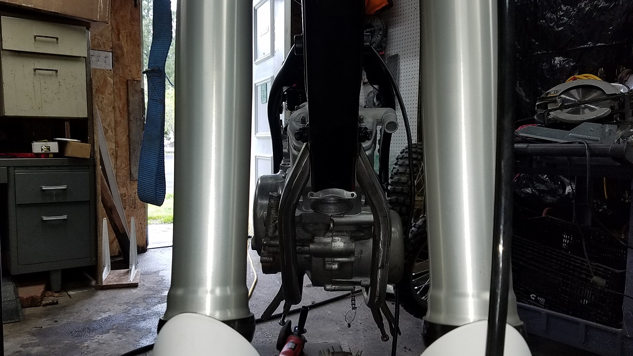

Just for grins, Jason held up a KX500 engine mount.... FITS PERFECT!!!!
KX GURU RACING 2016 KTM 250SXF KX500 CONVERSION 137.jpg (442.59 KiB) Viewed 9944 times
Only one problem... It's aluminum and we need chromoly...
I think we can re-position the KTM mounts and weld them back on...
Time will tell..

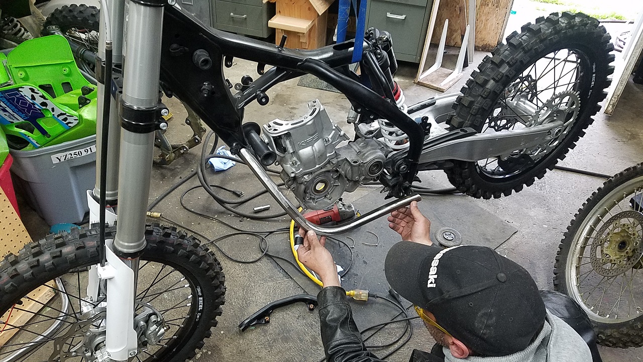

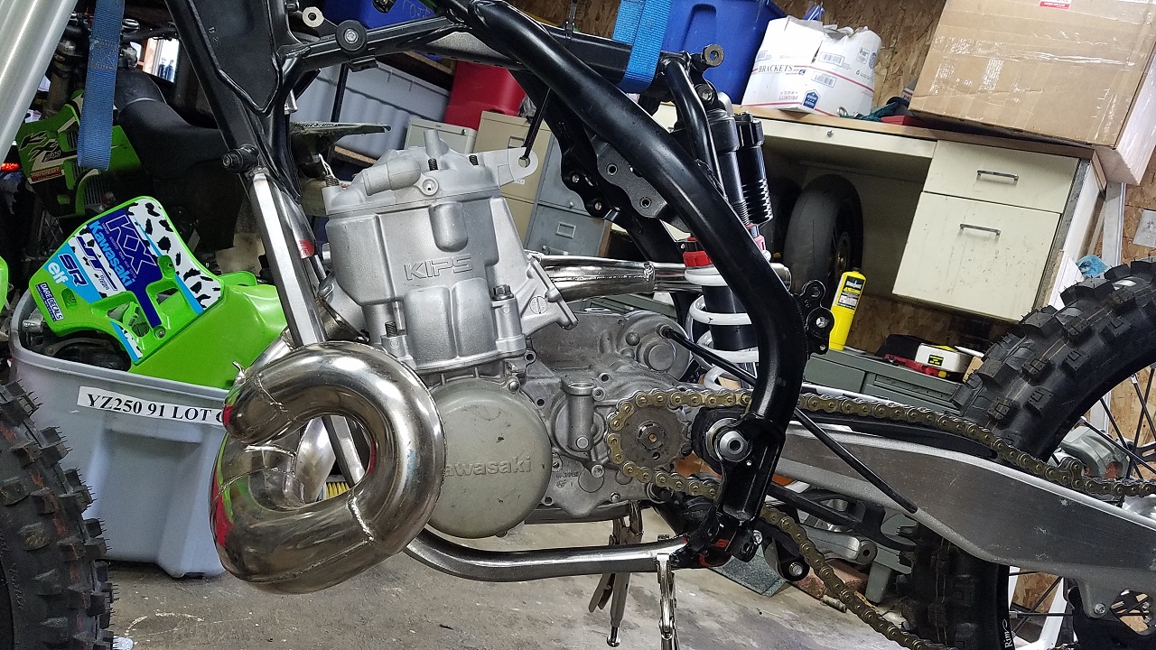

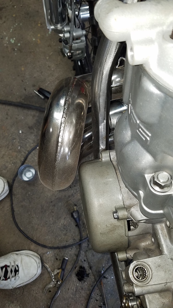

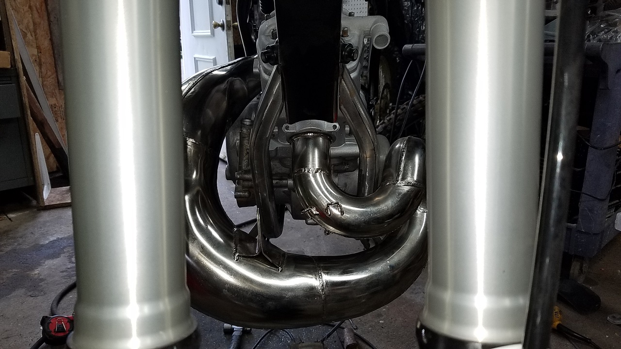

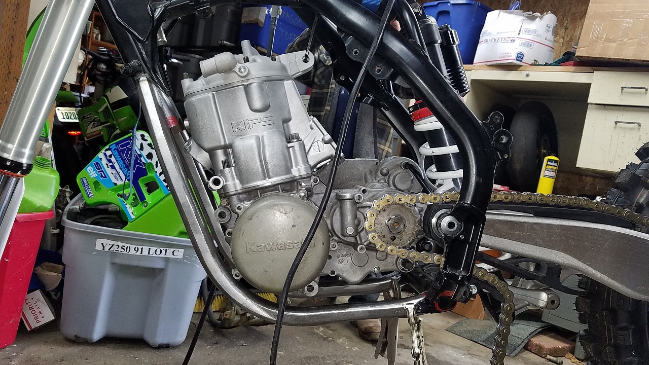

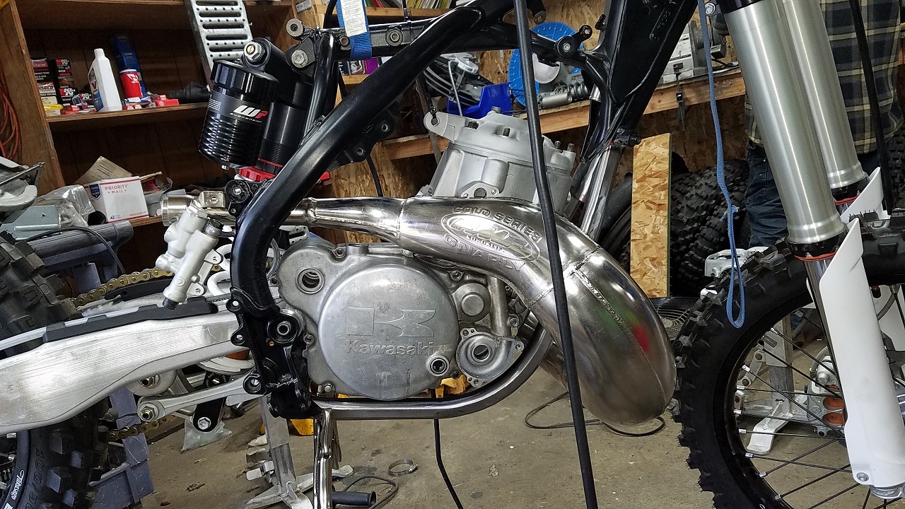

Now that we think we have the engine clocked correctly it's time to see if the pipe will fit..
KX GURU RACING 2016 KTM 250SXF KX500 CONVERSION 139.jpg (481.77 KiB) Viewed 9943 times
That looks good...
Yes.... It's nice.... So far...

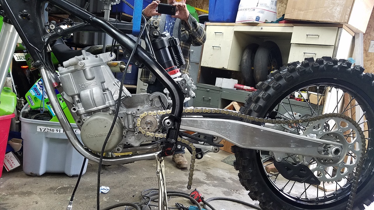

I can't wait to take this thing for a ride...
