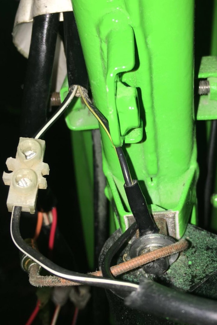

Post by Rookestar »
Kx
Rookestar
Posts: 22
Joined: Thu Jul 28, 2016 5:49 pm

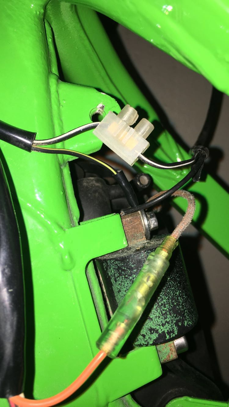

Re: MY 1991 KX250 HAS NO SPARK!
Post by Rookestar »
Kx
From what I can tell it looks correct.
So your next step is to check the OHM specs for the coil and the stator.
Just because it worked two years ago does not mean that it is still good today.
Run the Ohm specs and go from there.

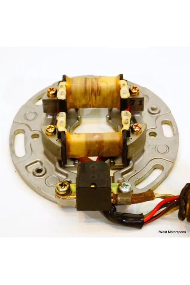

Hi I was just wondering if I haft to replace the whole lot

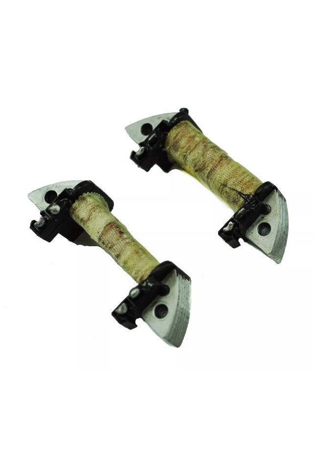

Post by Rookestar »
Or can I just replace these ??
