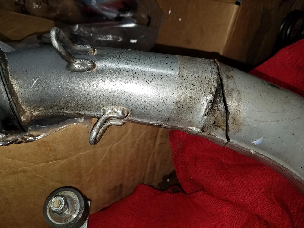

This isn't going to work too well...
JT ENGINE WORKS 89 CR500 CART ENGINE BUILD 144.JPG (131.88 KiB) Viewed 16243 times

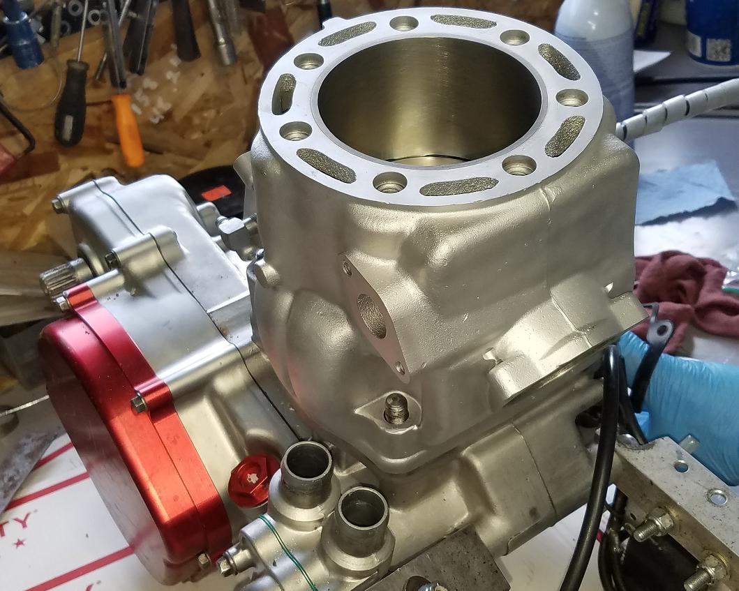

Bearings removed and degreased.. Ready for glass blasting.
JT ENGINE WORKS 89 CR500 CART ENGINE BUILD 145.JPG (203.31 KiB) Viewed 16238 times
Glass blasting done, ready for vapor blasting

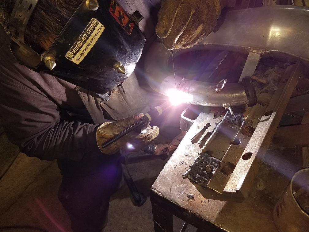

JT ENGINE WORKS 89 CR500 CART ENGINE BUILD 147.JPG (131.9 KiB) Viewed 16237 times
Tig it up Travis..
JT ENGINE WORKS 89 CR500 CART ENGINE BUILD 146.JPG (123.58 KiB) Viewed 16238 times
