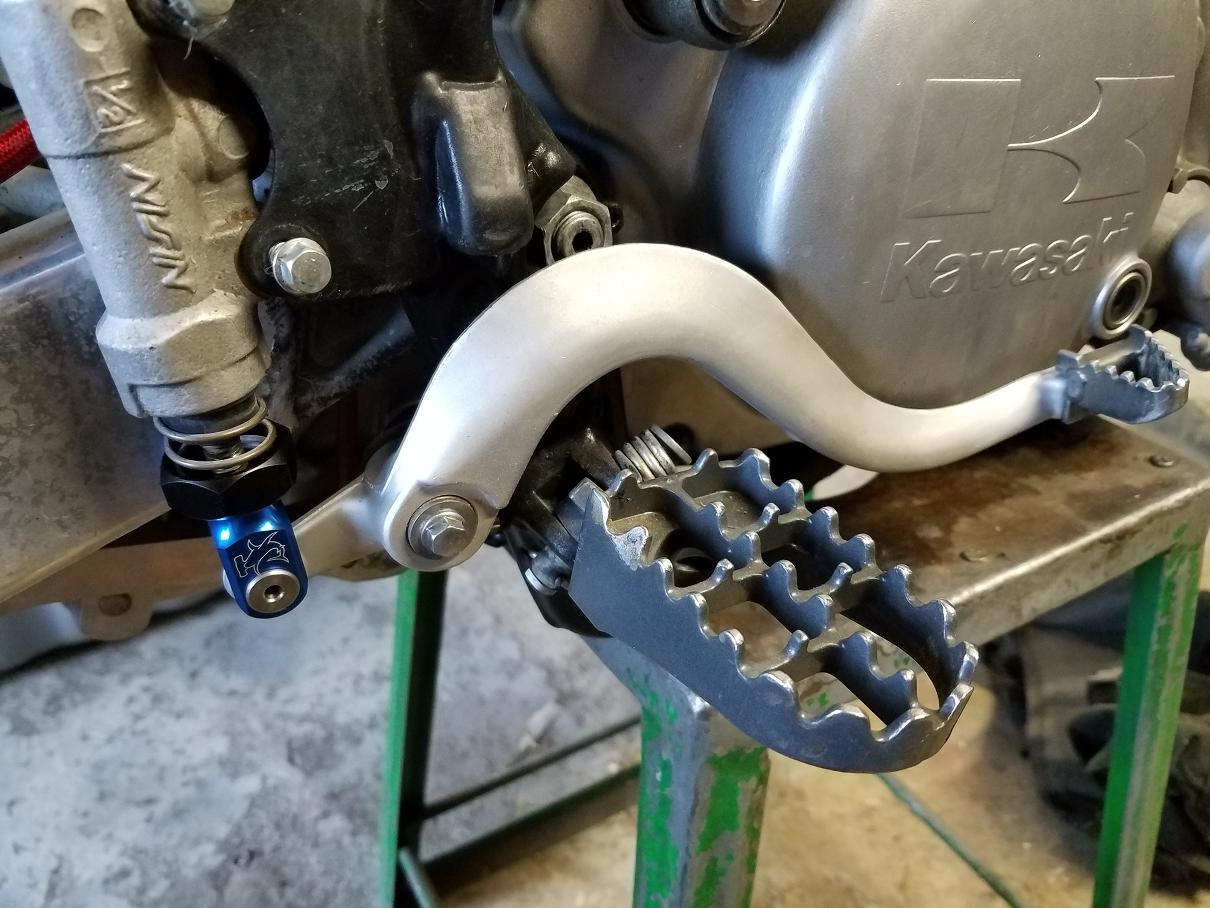

For now I will remove the bolt but in the future, I will remove the mount and help streamline the frame..
KXGURU.COM KX500 REAR BRAKE MOD 108.JPG (199.48 KiB) Viewed 8888 times
All the way down.... No problem..
KXGURU.COM KX500 REAR BRAKE MOD 109.JPG (152.5 KiB) Viewed 8888 times
All the way up.. Perfect
KXGURU.COM KX500 REAR BRAKE MOD 110.JPG (171.1 KiB) Viewed 8888 times

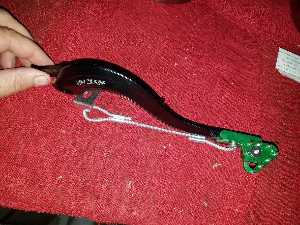

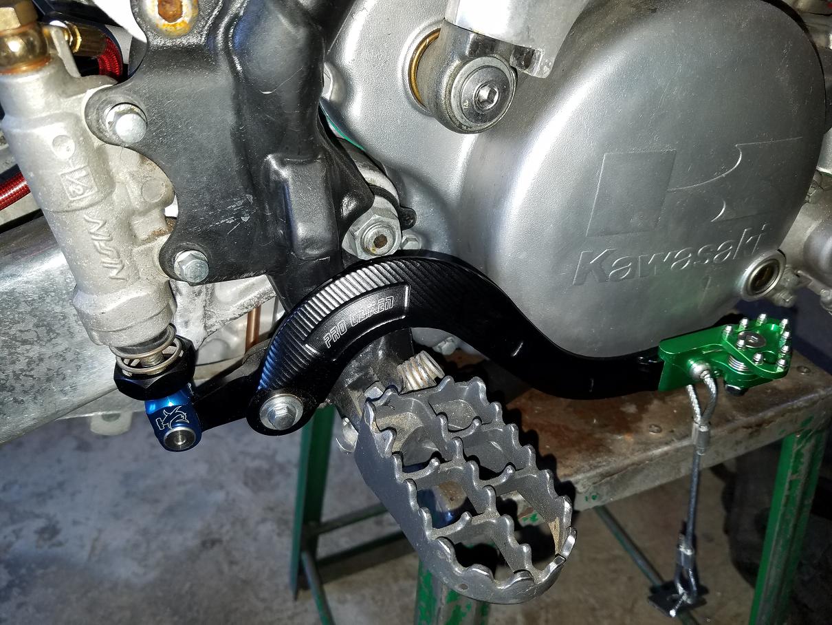

Ok... I received a cheapo rear brake lever with a folding tip...
KXGURU.COM KX500 REAR BRAKE MOD 112.JPG (375.29 KiB) Viewed 8874 times
KXGURU.COM KX500 REAR BRAKE MOD 113.JPG (366.08 KiB) Viewed 8874 times
Looks good...

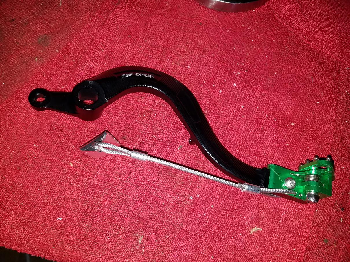

Pressed in two bushings and...
KXGURU.COM KX500 REAR BRAKE MOD 114.JPG (219.98 KiB) Viewed 8874 times
Fits perfectly...

In case you want to do the rear brake lever conversion, use the KX250F rear brake lever 04-16.
You will need two bronze bushings, ID 12mm, OD 16mm, Length 12mm.
Once you press the new bearings in, you will need to slightly ream the ID of the bushings as they do not want to slip right on.
