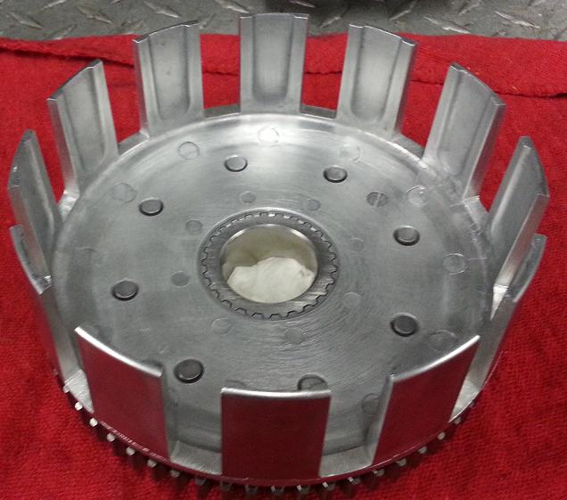

Clutch basket repair...
Before
91 KX500 CLUTCH BASKET REPAIR OEM-CYCLE.COM 120.JPG (72.41 KiB) Viewed 10766 times
After
91 KX500 CLUTCH BASKET REPAIR OEM-CYCLE.COM 121.JPG (51.36 KiB) Viewed 10766 times
Jason is a master with a hand file and Scotch Brite :D

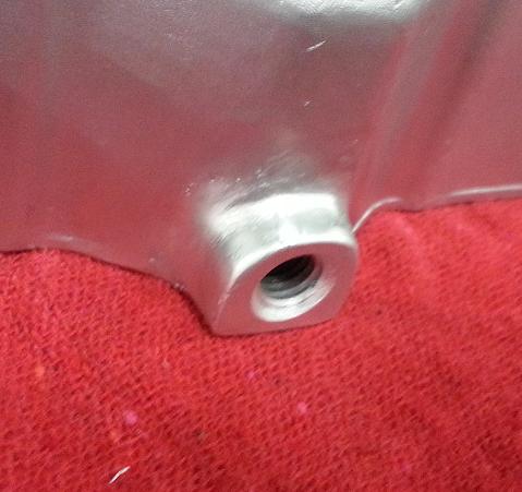

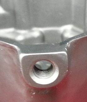

Drain plug repair is complete.
I like to make them a little deeper then stock so that you have more thread engagement and less chance of stripping in the future.
I also put WD40 in the case and let it sit over night to make sure it is not leaking before assembly.

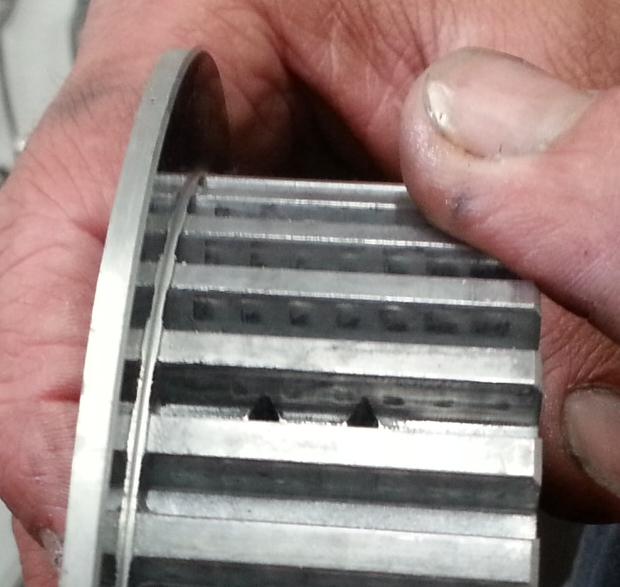

Clutch hub before

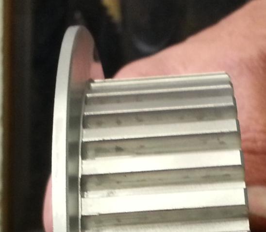

After

Not perfect but a whole lot better then before.
This should provide a little easier clutch pull.

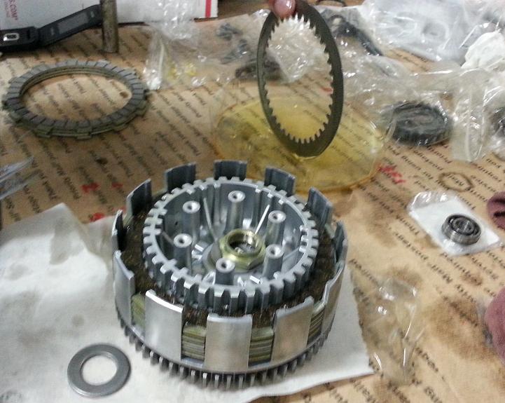

Getting the clutch plates pre oiled..

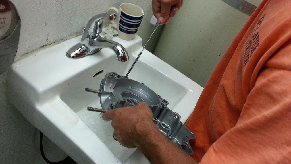

Re: Building a 91 KX500 engine
As if it weren't clean enough already...
91 KX500 OEM-CYCLE.COM MORE CASE CLEANING 106.JPG (94.98 KiB) Viewed 10749 times
