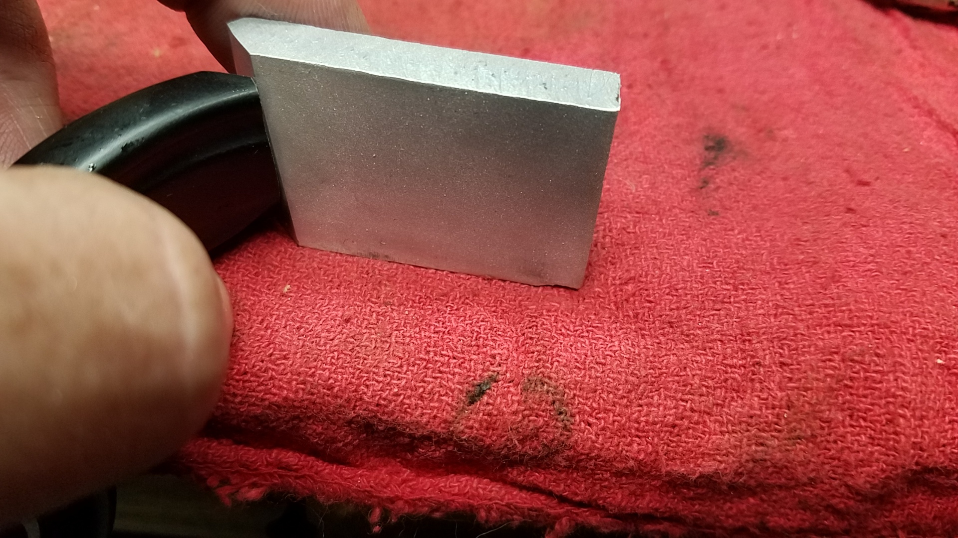

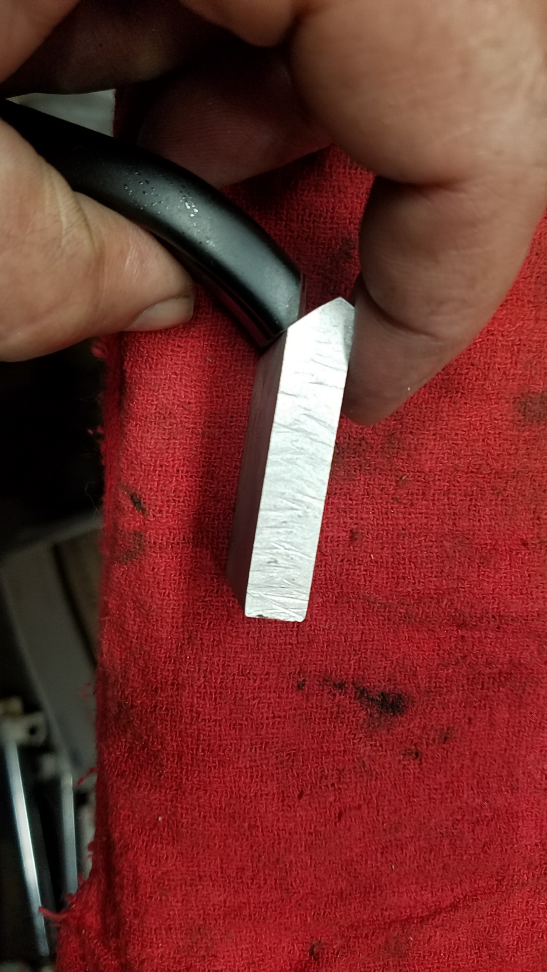

Started working on the rear brake lever...
Since the KX500 engine is way wider than the 250 SXF engine the rear brake lever needed tweaking.
I also tried a 450 SXF lever but even it fell short.
So I grabbed a piece of aluminum and starting hacking my lever up.
KTX500E KX GURU RACING 301.jpg (780.44 KiB) Viewed 11071 times
KTX500E KX GURU RACING 302.jpg (560.7 KiB) Viewed 11071 times
KTX500E KX GURU RACING 303.jpg (648.37 KiB) Viewed 11071 times

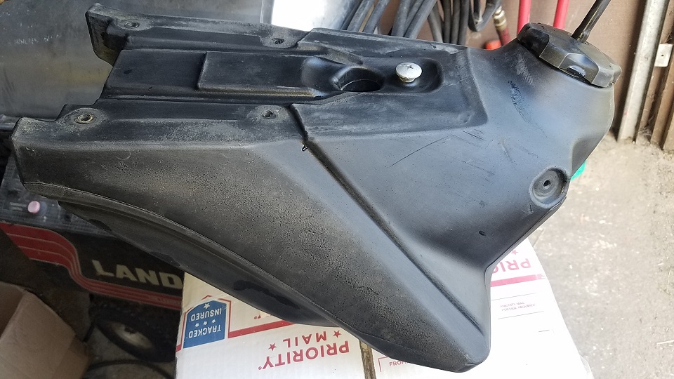

I decided that the gas tank looked a little rough for this level of build.
Since Cerakote was designed for use on plastic I decided to give it a try.
Worst case scenario is I'll have to buy a new tank :shock:
KX GURU RACING CERAKOTE 101.jpg (120.19 KiB) Viewed 11067 times
KX GURU RACING CERAKOTE 102.jpg (191 KiB) Viewed 11067 times
KX GURU RACING CERAKOTE 103.jpg (214.6 KiB) Viewed 11067 times
EPIC FAILURE!!!
Time to start over... :roll:

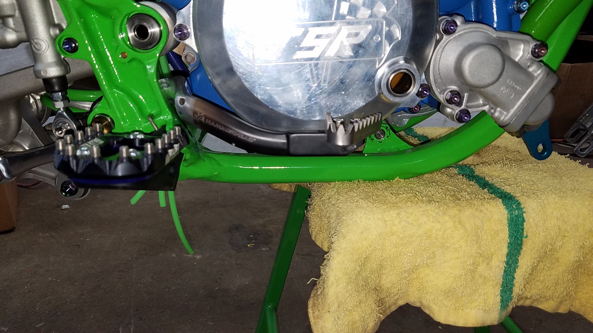

Posted: Wed Jun 12, 2019 3:19 am
On the bright side, the rear brake lever turned out GREAT!!!
KTX500E KX GURU RACING 311.jpg (135.82 KiB) Viewed 11066 times
KTX500E KX GURU RACING 312.jpg (111.2 KiB) Viewed 11066 times
KTX500E KX GURU RACING 313.jpg (235.21 KiB) Viewed 11066 times

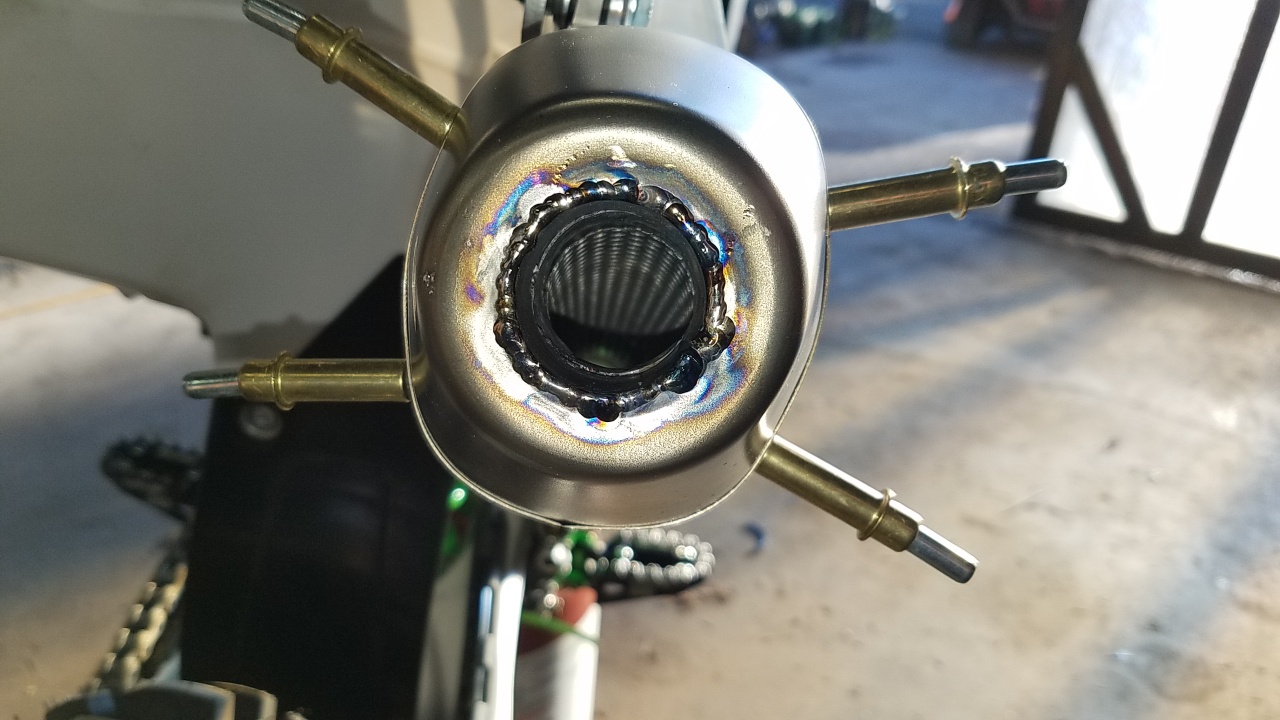

The muffler is now re-cored to match the KX500 ID..
It was a real job trying to find someone to weld Titanium for me.
My new friend Rob Jeffers did a great job.
He is now working on the pie pieces to go from the inlet of the muffler to the outlet of the expansion chamber...
Can't wait to hear it when it's done...
