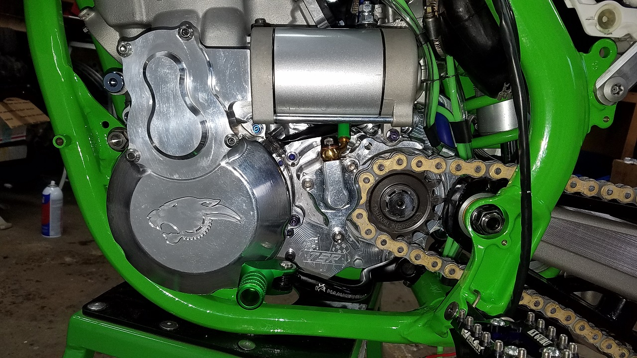

Special Thanks goes to Alex Ward from Crazy Al's racing for getting me this 8 cet Anti Gravity battery...
Let's get wiring this puppy up...

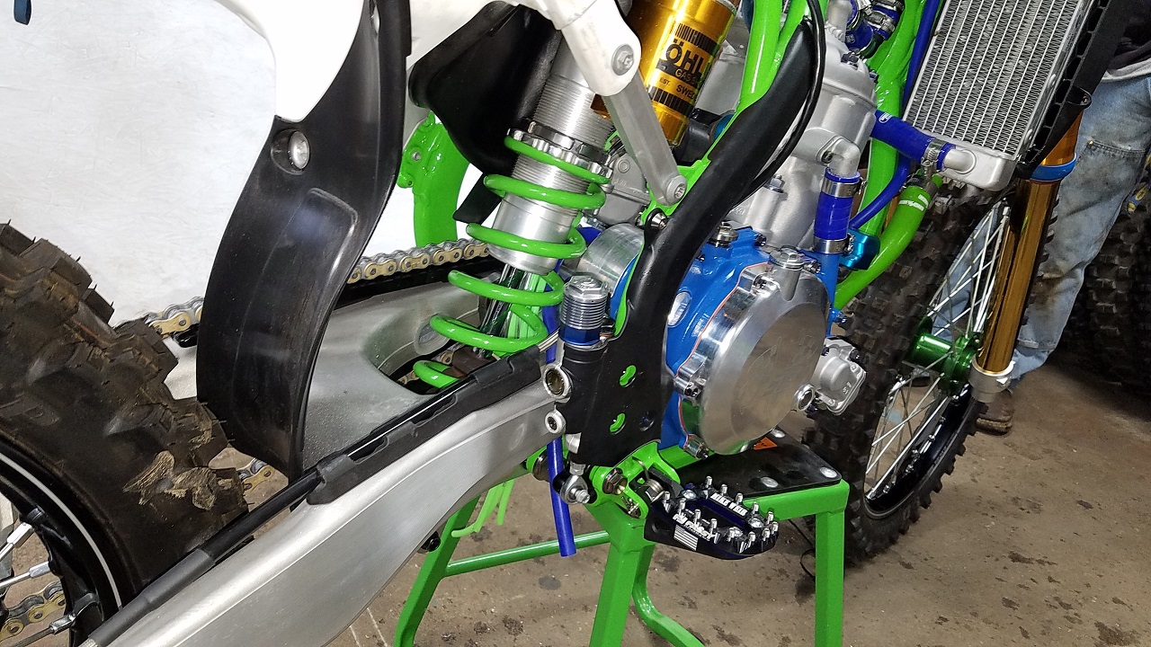

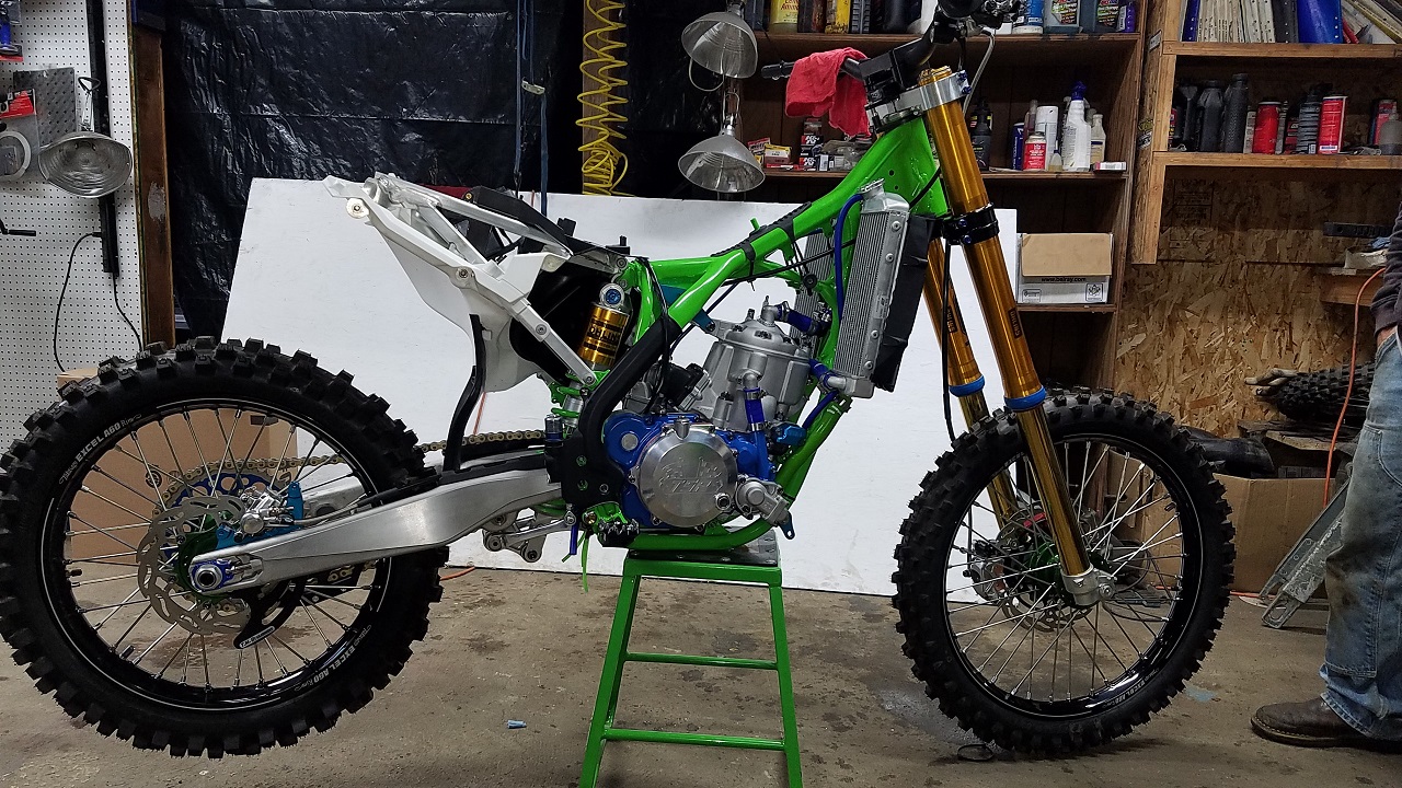

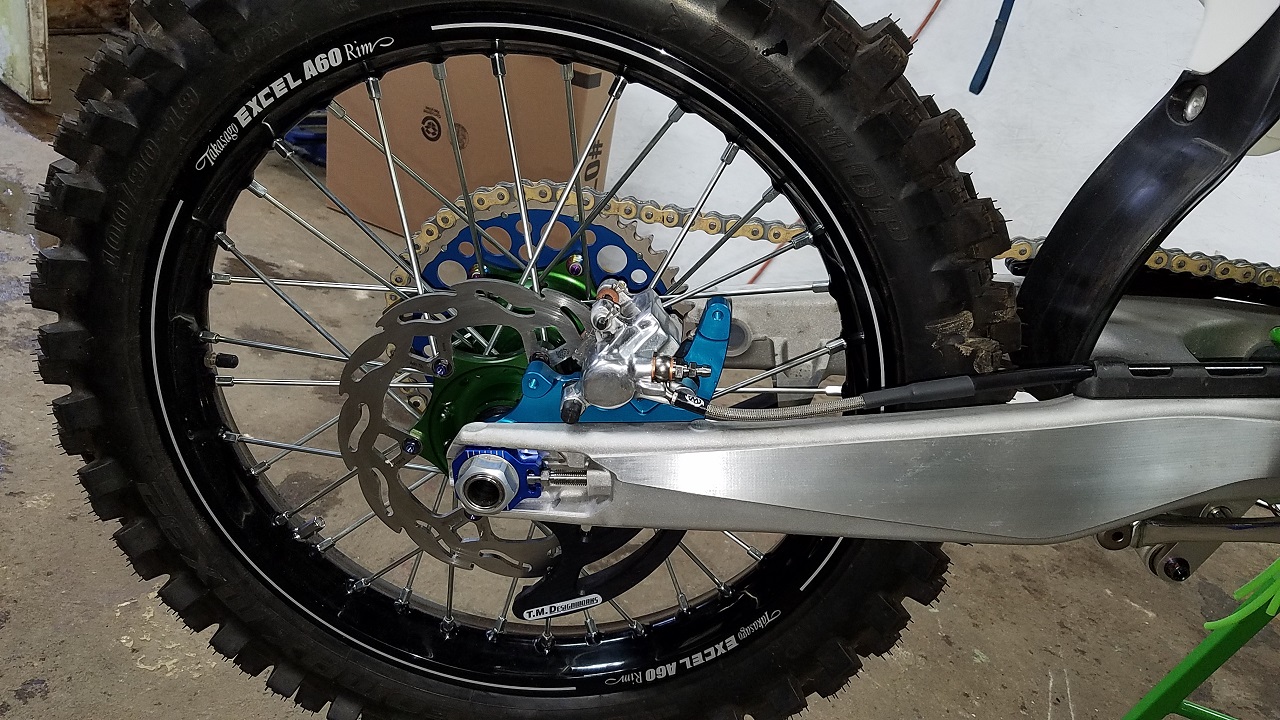

Jason Tanner came out today and we made some good progress.

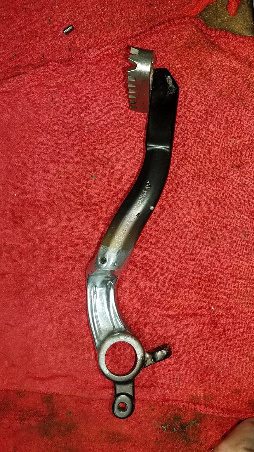

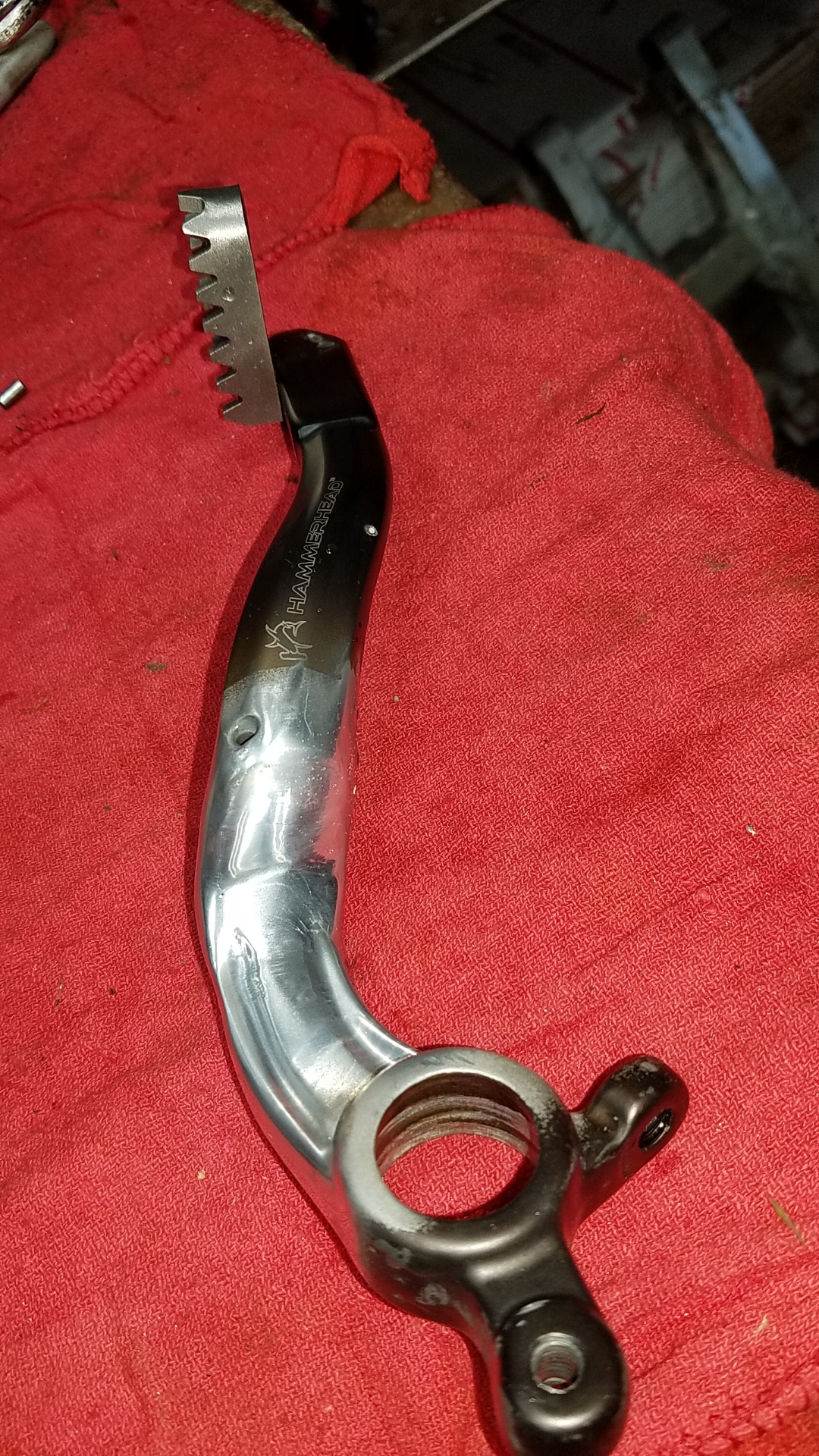

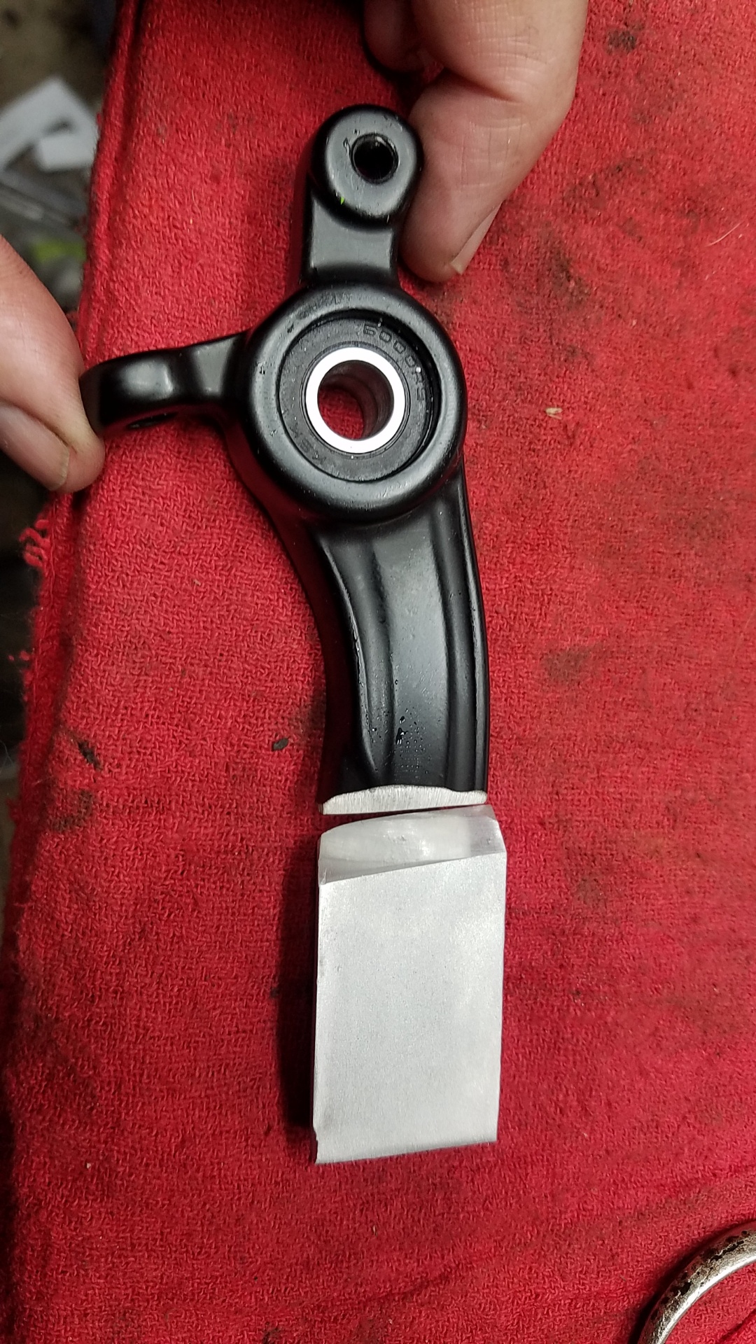

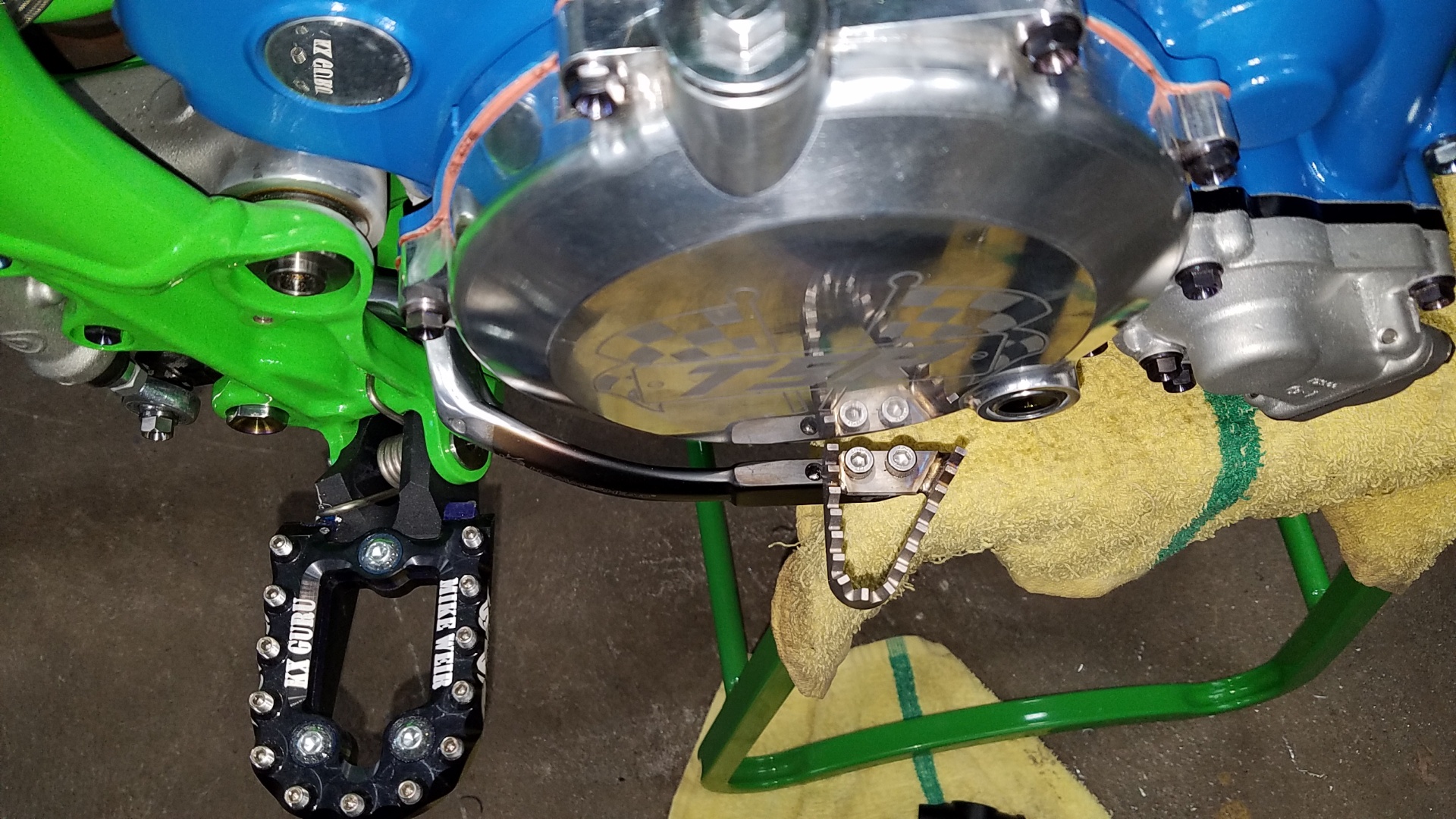

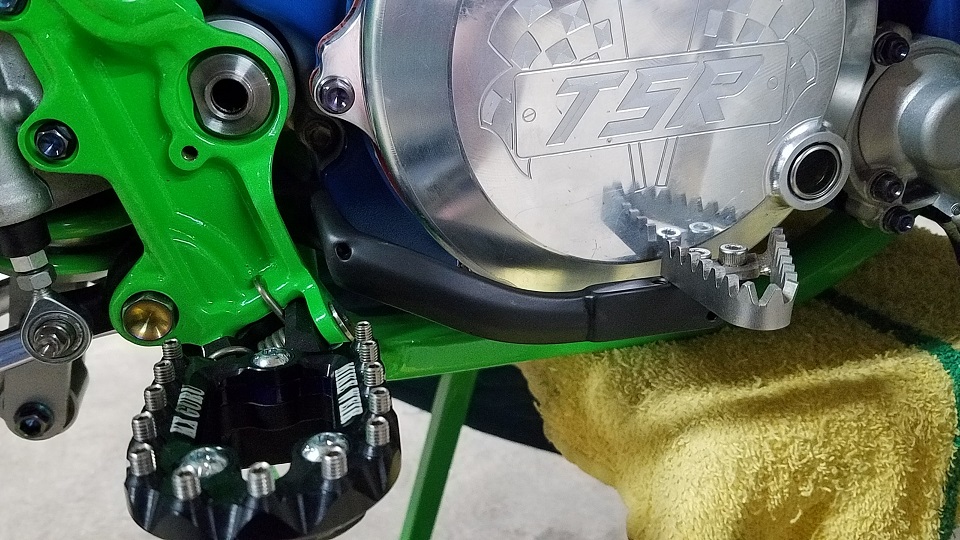

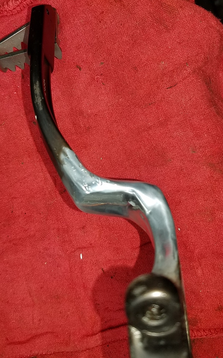

Started working on the rear brake lever...
Since the KX500 engine is way wider than the 250 SXF engine the rear brake lever needed tweaking.
I also tried a 450 SXF lever but even it fell short.
So I grabbed a piece of aluminum and starting hacking my lever up.
KTX500E KX GURU RACING 301.jpg (780.44 KiB) Viewed 11067 times
KTX500E KX GURU RACING 302.jpg (560.7 KiB) Viewed 11067 times
KTX500E KX GURU RACING 303.jpg (648.37 KiB) Viewed 11067 times

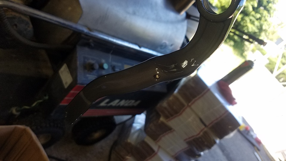

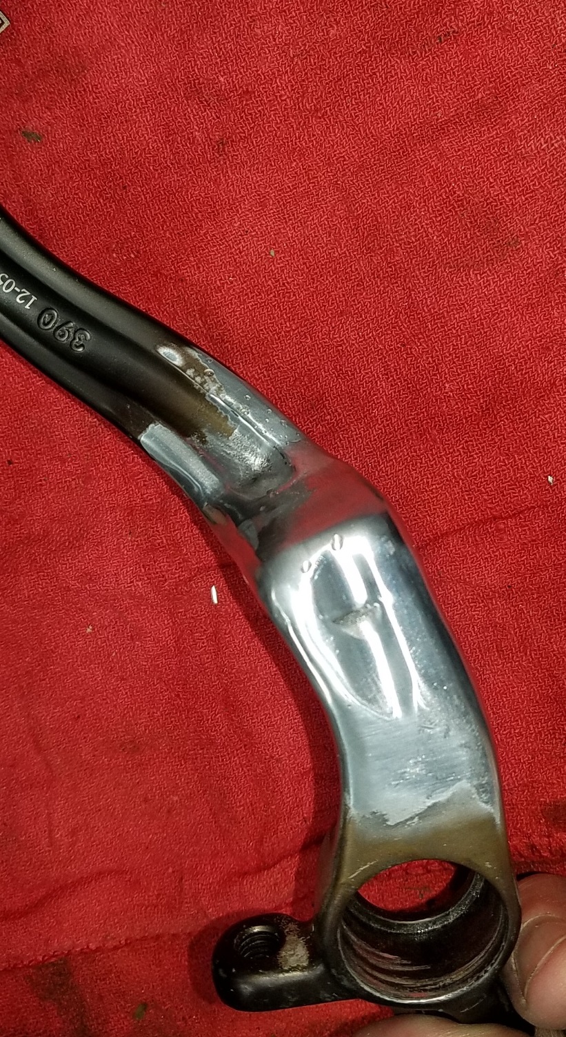

After weld and rough blending...
Keep in mind that it is rough...
KTX500E KX GURU RACING 304.jpg (972.09 KiB) Viewed 11066 times
KTX500E KX GURU RACING 305.jpg (884.8 KiB) Viewed 11066 times
KTX500E KX GURU RACING 306.jpg (940.38 KiB) Viewed 11066 times
KTX500E KX GURU RACING 307.jpg (651.66 KiB) Viewed 11066 times
KTX500E KX GURU RACING 308.jpg (592.28 KiB) Viewed 11066 times
Roughed in and ready for final blending, sanding, and Cerakote
KTX500E KX GURU RACING 309.jpg (676.3 KiB) Viewed 11065 times
KTX500E KX GURU RACING 310.jpg (720.49 KiB) Viewed 11065 times

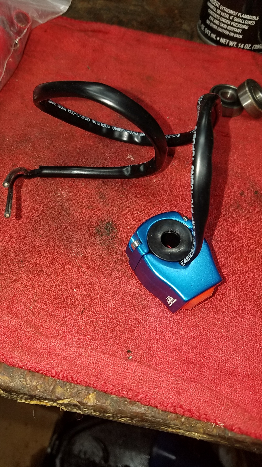

Kill switch came in :D

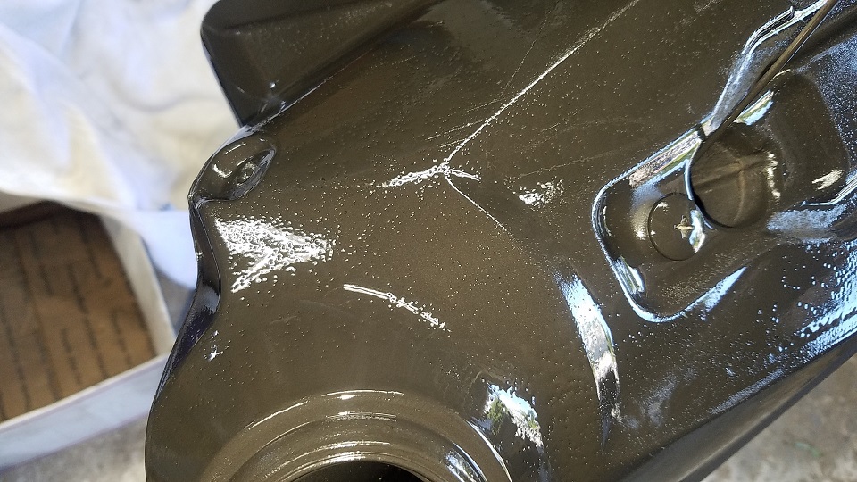

I decided that the gas tank looked a little rough for this level of build.
Since Cerakote was designed for use on plastic I decided to give it a try.
Worst case scenario is I'll have to buy a new tank :shock:

EPIC FAILURE!!!
Time to start over... :roll:

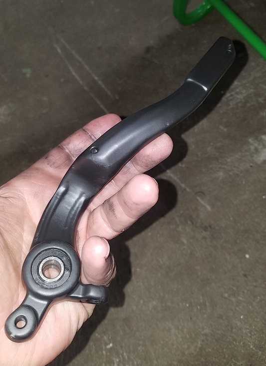

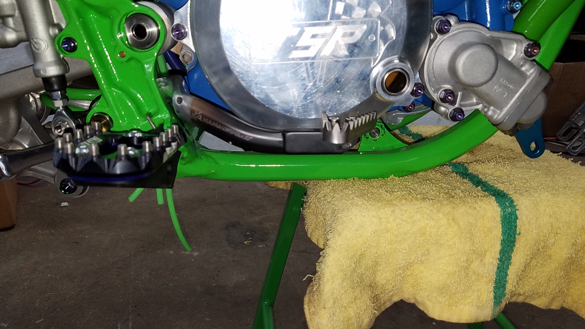

On the bright side, the rear brake lever turned out GREAT!!!
KTX500E KX GURU RACING 311.jpg (135.82 KiB) Viewed 11062 times
KTX500E KX GURU RACING 312.jpg (111.2 KiB) Viewed 11062 times
KTX500E KX GURU RACING 313.jpg (235.21 KiB) Viewed 11062 times
Posted this last night but had a technical glitch 😲 Some of you have been following this build.. KtX500e Fired it up last night for the first time... There is a bit of humor there.... Jason Tanner handled the situation like a Pro 😂

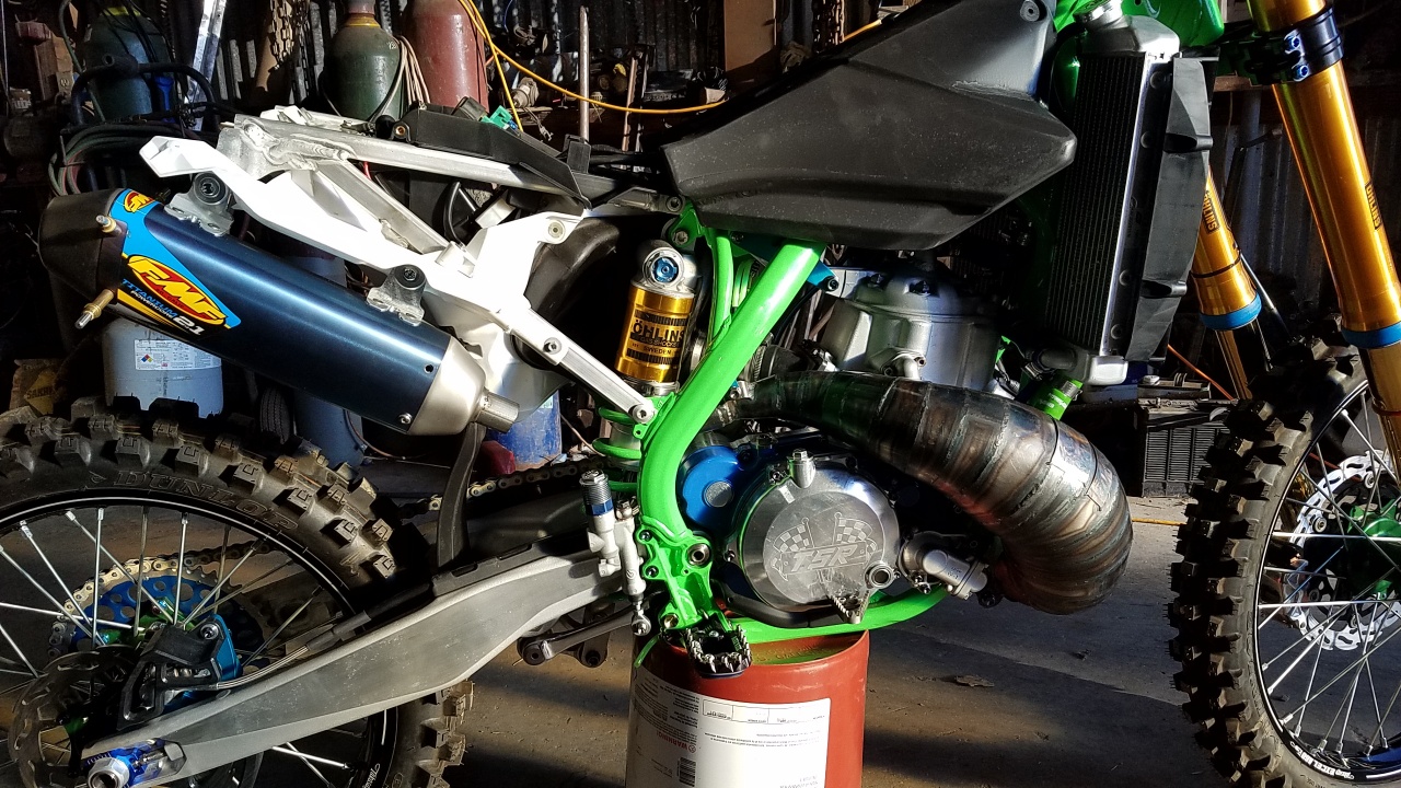

The muffler is now re-cored to match the KX500 ID..
It was a real job trying to find someone to weld Titanium for me.
My new friend Rob Jeffers did a great job.
He is now working on the pie pieces to go from the inlet of the muffler to the outlet of the expansion chamber...
Can't wait to hear it when it's done...
