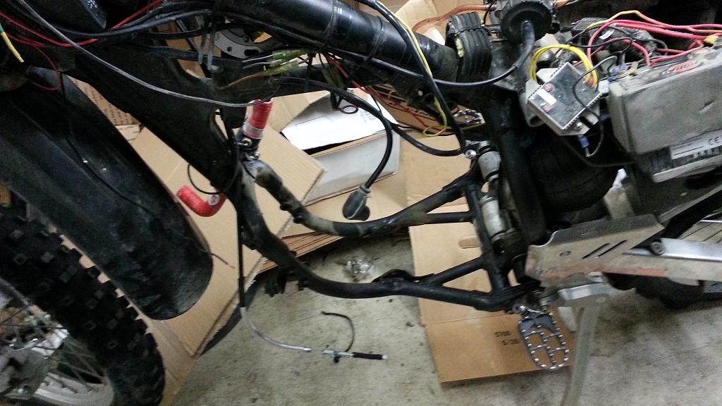

So...... Out with the old...
KX500 ENGINE SWAP 1.JPG (68.33 KiB) Viewed 11492 times
KX500 ENGINE SWAP 2.JPG (140.65 KiB) Viewed 11492 times

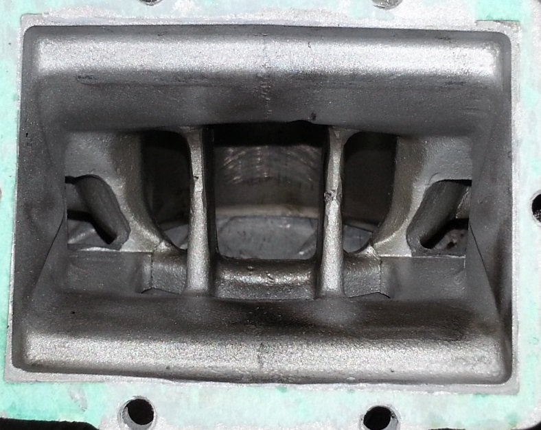

Take a look at the cylinder before I started messing with it..
Stock bridges which were welded before plating, looks kinda rough..
kx500 2001 cylinder clean up 1.jpg (177.75 KiB) Viewed 11475 times

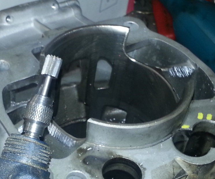

Stock transfers and stock floor ports.
kx500 2001 cylinder clean up 2.jpg (134.17 KiB) Viewed 11475 times

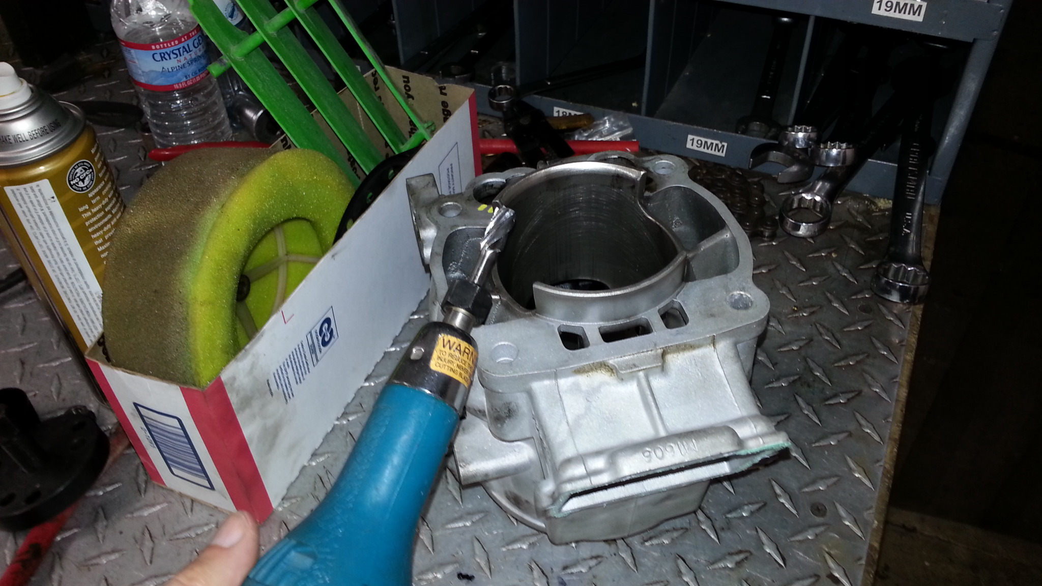

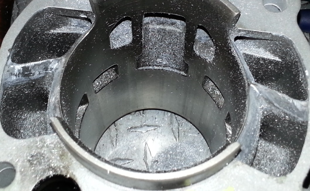

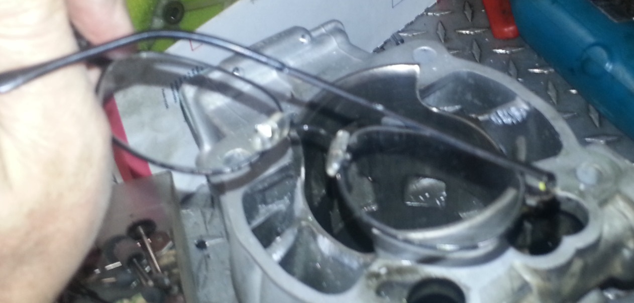

So, I grabbed my Dremel, I know some of you hate it but I'm not set up with air tools..
And, after a while they will move material.
kx500 2001 cylinder clean up 4.jpg (119.06 KiB) Viewed 11475 times
And don't forget the eye protection as well as the lens correction for those of us who can't see anything unless it is at least 3 feet in front of us :geek:
kx500 2001 cylinder clean up 5.jpg (152.27 KiB) Viewed 11475 times

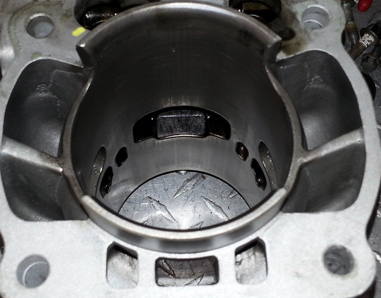

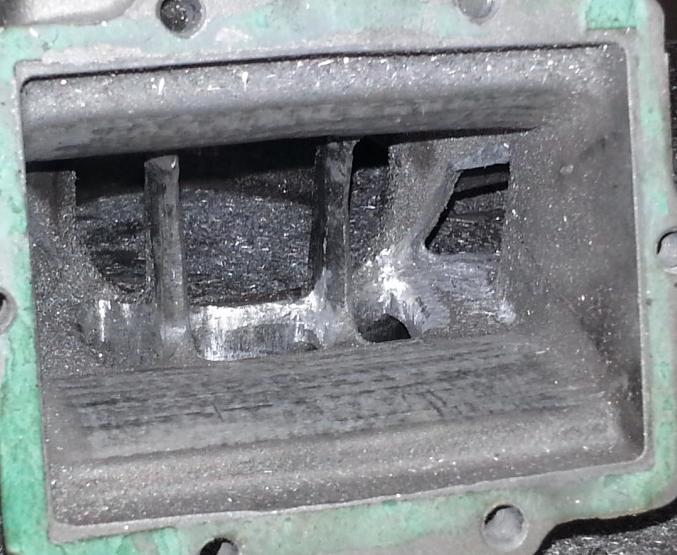

Now were starting to get somewhere..

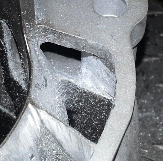

kx500 2001 cylinder clean up 6.jpg (269.99 KiB) Viewed 11475 times

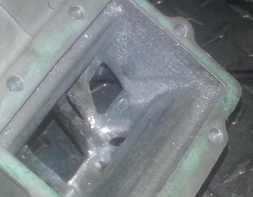

These are looking better too...
kx500 2001 cylinder clean up 7.jpg (333.04 KiB) Viewed 11475 times
So far I have about an hour into the project.
I'm about half way done so it's not a bad job and if I can do it, you can too.. 8-)

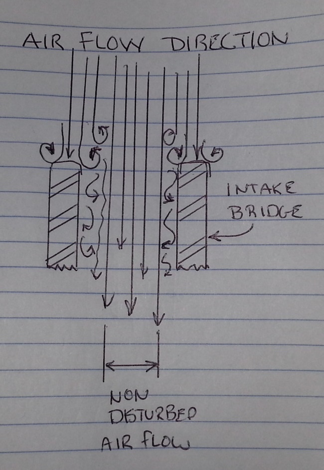

This diagram is of the intake bridges and how air flows around them in the stock configuration.
disturbed air flow.jpg (158.2 KiB) Viewed 11473 times
The air/fuel mixture hits the face of the blunt bridges causing the air to swirl around.
This actually narrows the channel that the air can flow through undisturbed.
So, you are loosing air velocity as well as the volume of air entering your engine.

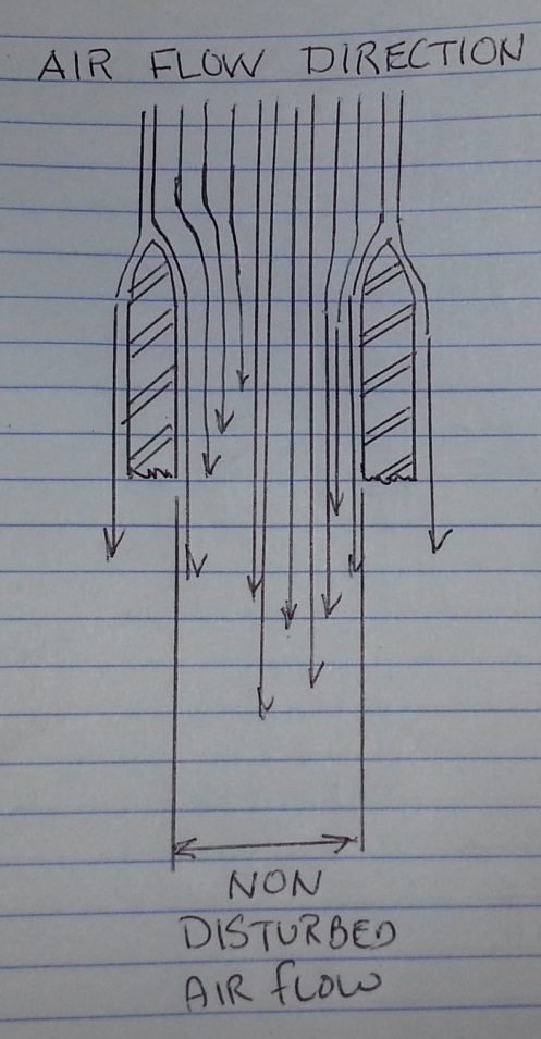

After cleaning up the bridges you greatly free up the non disturbed air flow maintaining maximum air velocity and volume..
disturbed air flow 2.jpg (130.48 KiB) Viewed 11473 times

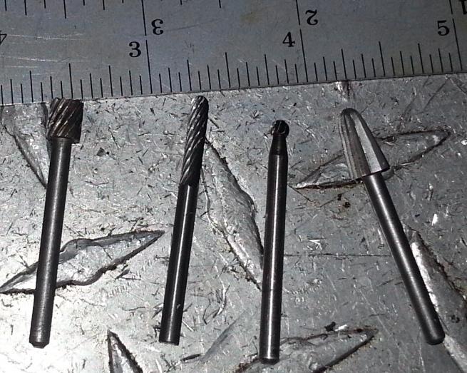

Here is some porting tools I use.
2001 kx500 porting tools.JPG (78.9 KiB) Viewed 11469 times

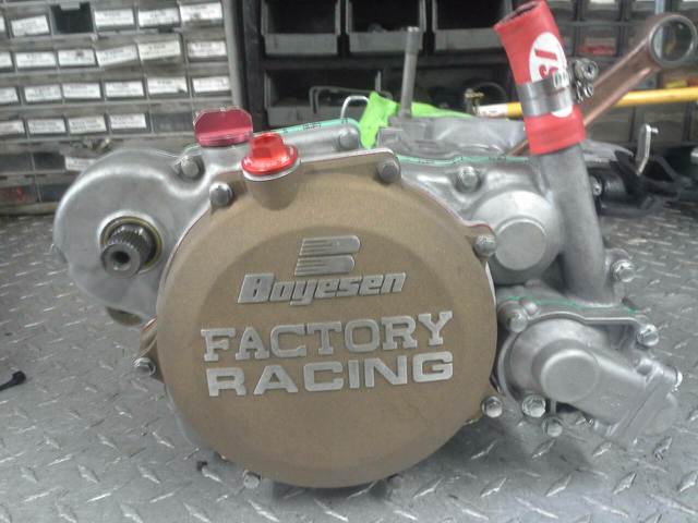

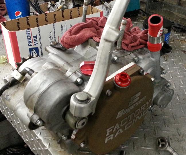

But for now I'm finishing the bottom end...
What we have is all the oil passages have been cleaned up, all mating surfaces have been lapped with Timesaver, bearings, seals, gaskets, shift forks, shift drum, and every snap ring, has been replaced.
The crank has been welded, trued, and balanced and rebuilt, using a IMS Pro rod.
Windowed Wossner piston, stock bore, fresh plate.
Transfers, bridges, and exhaust port, has been cleaned up.
Water ports have been cleaned up and the impeller clearance mod is done.
2 angle squish band with decompression on the head.
The rest is just glitter...
So, it should be just a nice, smooth, stock motor with some cleanup.
How will it run?
I should find out very soon.
The top end is back on.
