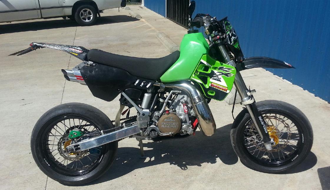

So, with the water pump clearance mod and enlarging the inlet side of the clutch cover, here is my temps for today.
70 deg F
42 percent humidity
Breaking in the new top end around town.
Highest head temp 204 deg F
Highest water temp 122 deg F
Average temps
Head 185 deg F
Water 115 deg F
Hmmm.... seems to big of a difference...
I'm taking it back to the shop to re-burp the head, rads, and impeller area just for insurance.
Here is as close as a comparison as I have recorded before:
Air temp 72F
Humidity 43%
Head: 158-162 F
Coolant: 133-138F
Very tool limited at the house but I pulled the burp plug on the left rad and B.U.R.P!!!!
Yeah, back to the shop tomorrow to burp the head, rad, and water pump impeller area..
I bet that will cause the two temps to come back in line..

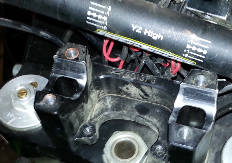

Had a small clunking sound in the front end.
It was nothing more then a loose triple stem.
But the thing that I found that blew me away was all that dirt!!! :D
kx500 loose triple stem.jpg (201.86 KiB) Viewed 10461 times
I cleaned it up quick before someone saw it 8-)

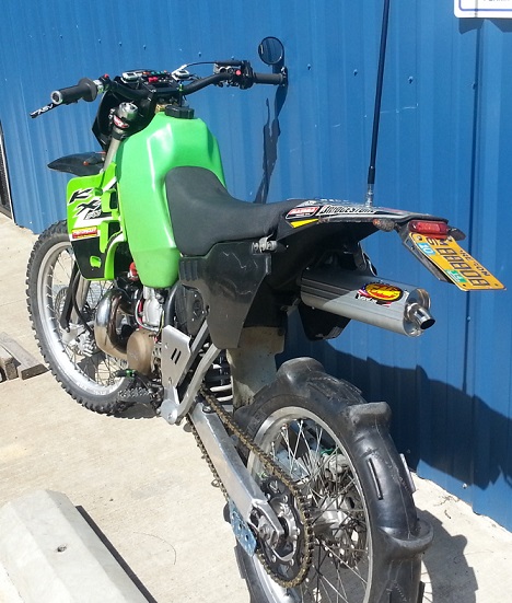

Should be ready for a trip to the dunes....
01 KX500 SUPERMOTO WITH PADDLE TIRE.jpg (118.47 KiB) Viewed 10445 times
The cool thing about riding your Supermoto at the dunes.... You can signal while passing :D

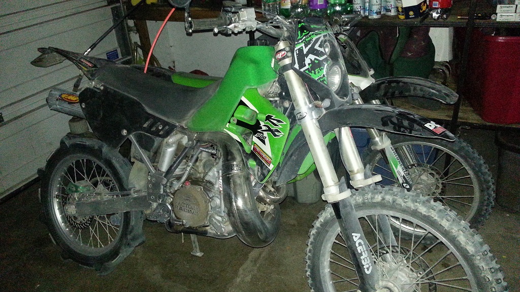

My bike is feeling dejected... Dirty oil... dirty chassis... dirty plug...
What's this world coming to?
01 KX500 SUPERMOTO WITH PADDLE TIRE dirty.jpg (324.83 KiB) Viewed 10741 times
