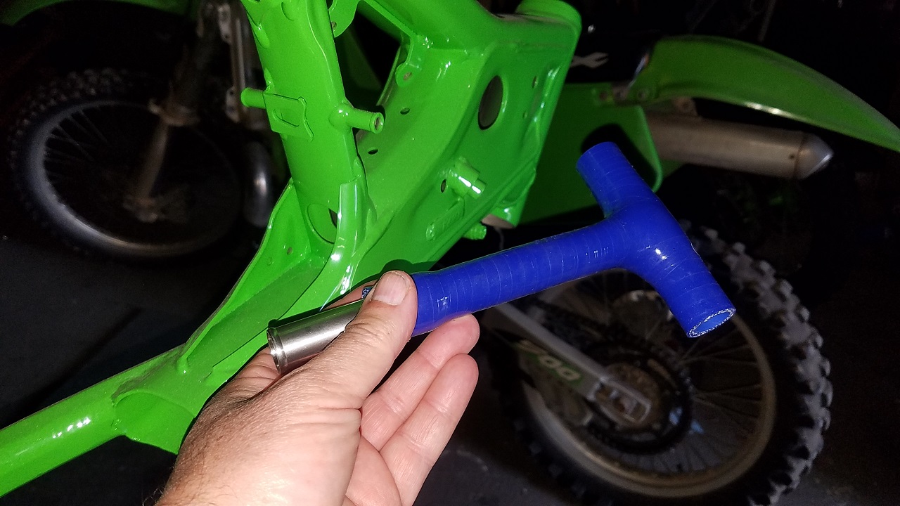

Posted: Wed Sep 05, 2018 10:28 pm

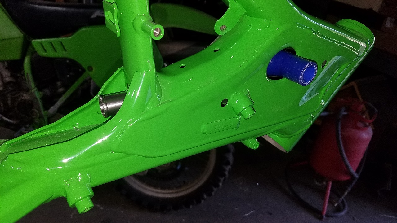

Finally... A part that I can put on the bike and not have to worry about taking it off again :lol:
This is a Samco Husqvarna 2016 205 sxf T radiator hose.
I pulled the stock unit out to powder coat the frame and I just didn't trust the stock part after the abuse of getting it apart.
KX GURU RACING KTX500E SAMCO RADIATOR T HOSE 101.jpg (248.05 KiB) Viewed 11221 times
KX GURU RACING KTX500E SAMCO RADIATOR T HOSE 102.jpg (299.74 KiB) Viewed 11221 times

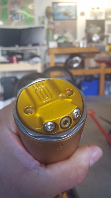

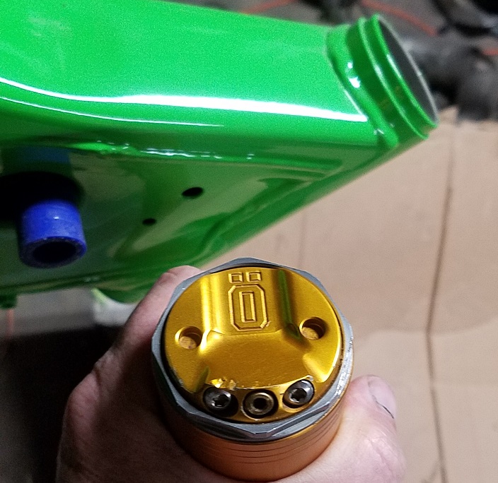

Posted: Sat Nov 03, 2018 2:49 am

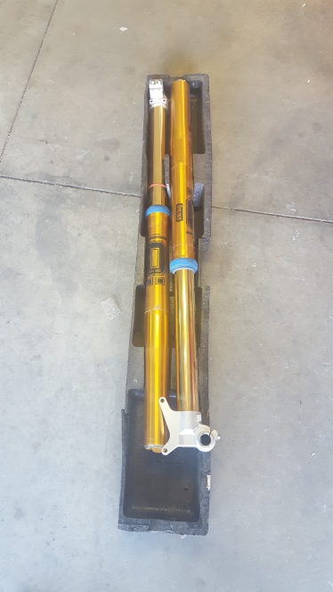

I finally have my hands on the forks.... Now I need my triple trees, shock, and GPR dampener and I should be ready to go...
KX GURU RACING KTX500E BUILD OHLINS FORKS 101.jpg (407.31 KiB) Viewed 10954 times
Yes, you are seeing it right... These are used forks with some wear...
Oh well... That's what photoshop is suppose to be for :lol:
KX GURU RACING KTX500E BUILD OHLINS FORKS 102.jpg (173.88 KiB) Viewed 10954 times

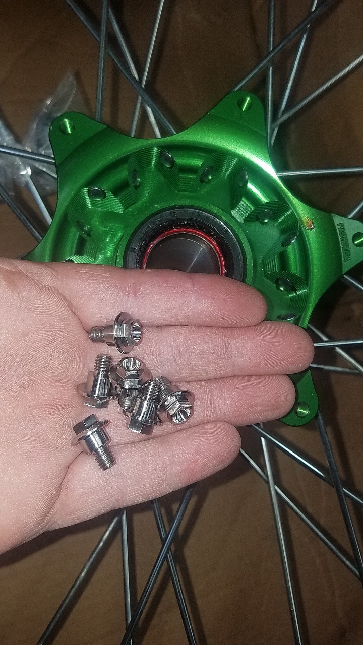

Titanium axle
KX GURU RACING KTX500E BUILD TITANIUM AXLE 101.jpg (404.2 KiB) Viewed 10954 times

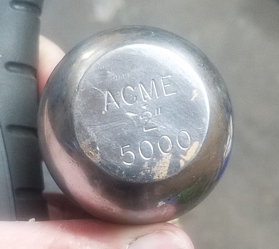

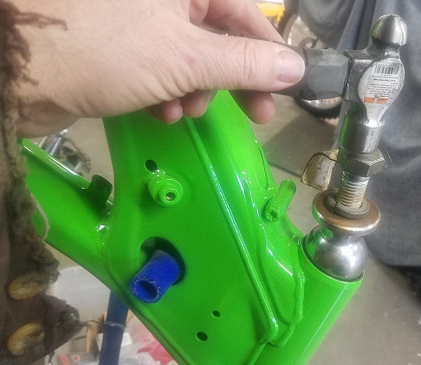

Posted: Sun Nov 11, 2018 11:09 pm
I'm putting the races back in the frame.
I don't have any special tooling :(
But, I do have a old 2" trailer hitch ball that is a nice fit :lol:
KX GURU RACING TRIPLE BEARING RACE INSTALLATION 101.jpg (220.5 KiB) Viewed 10933 times
Good old ACME 8-)
KX GURU RACING TRIPLE BEARING RACE INSTALLATION 102.jpg (103.21 KiB) Viewed 10933 times
Posted: Mon Nov 12, 2018 4:48 pm
Ah... one other point.
I actually pushed in the races and then later decided that I should take some pics...
I put a rag between the bearing race and the ball before I started driving it in.
Also, look at the hammer I used, it is tiny... And I don't wack it... small taps drove the races in with no issues.
After I was done I inspected the bearing surface and there was no damage at all.
I have used this same procedure many times in the past with no issues.
It would have been better to put it into a press and use a socket or a slightly ground down race to press it ini.
But I knew I could do this and it was quick and easy 8-)

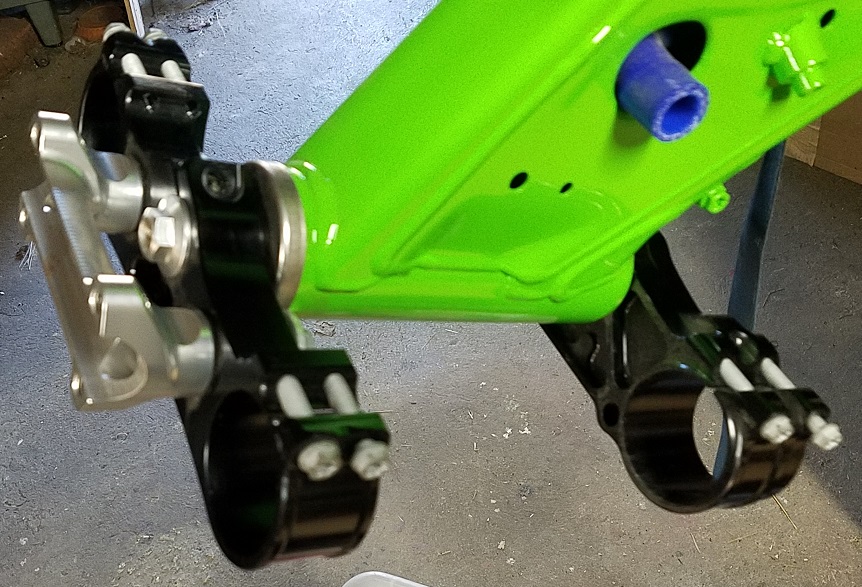

Posted: Sun Nov 25, 2018 10:51 pm
Mocking up the front end..
KX GURU RACING KTX500E 200.jpg (247.37 KiB) Viewed 10853 times
KX GURU RACING KTX500E 201.jpg (370.88 KiB) Viewed 10853 times
