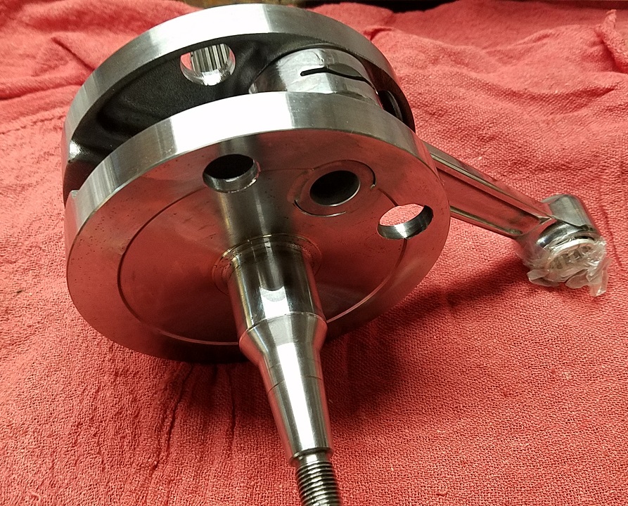

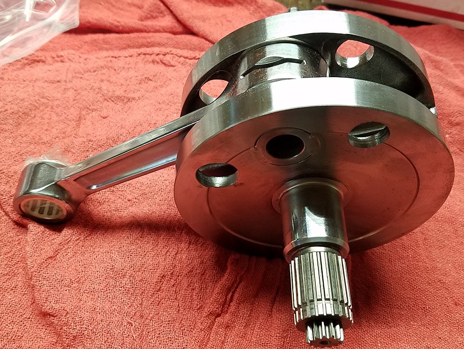

Got the crank back :-)
KX GURU RACING KTX500E CRANKSHAFT 101.jpg (345.97 KiB) Viewed 11291 times

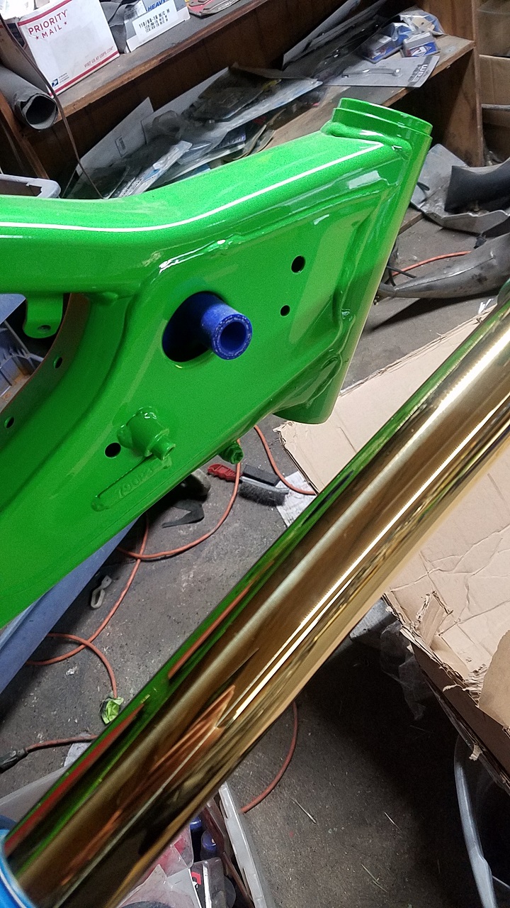

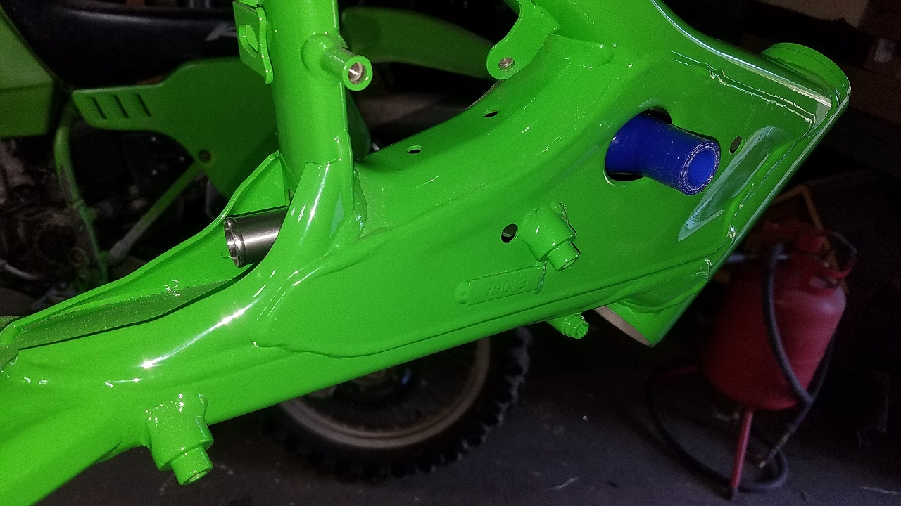

Finally... A part that I can put on the bike and not have to worry about taking it off again :lol:
This is a Samco Husqvarna 2016 205 sxf T radiator hose.
I pulled the stock unit out to powder coat the frame and I just didn't trust the stock part after the abuse of getting it apart.
KX GURU RACING KTX500E SAMCO RADIATOR T HOSE 101.jpg (248.05 KiB) Viewed 11219 times
KX GURU RACING KTX500E SAMCO RADIATOR T HOSE 102.jpg (299.74 KiB) Viewed 11219 times

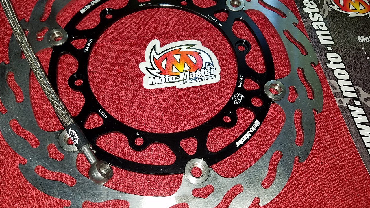

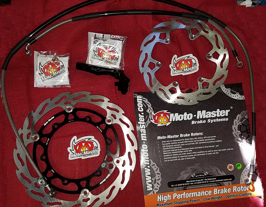

Hmmm... These might work...
Beautiful parts from Moto Master.
These should help slow the beast 8-)
MOTO MASTER BRAKE KtX500e KX GURU RACING BUILD 101.jpg (423.09 KiB) Viewed 11006 times

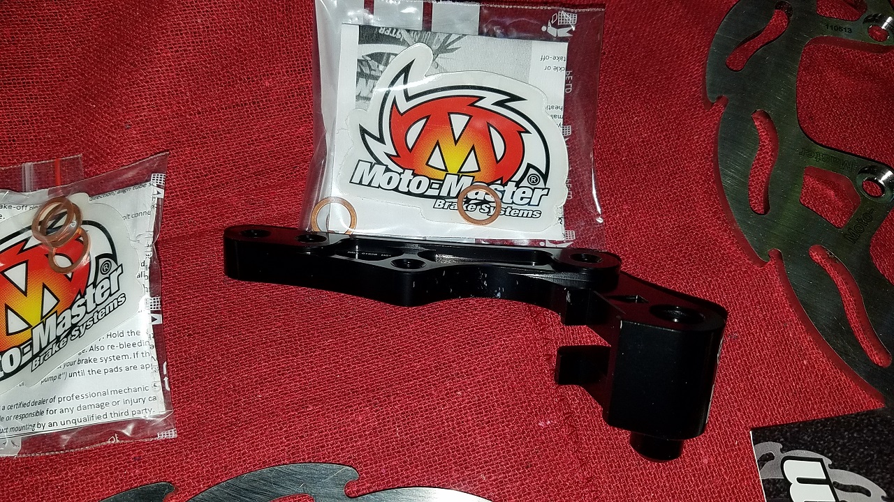

MOTO MASTER BRAKE KtX500e KX GURU RACING BUILD 102.jpg (613.63 KiB) Viewed 11006 times

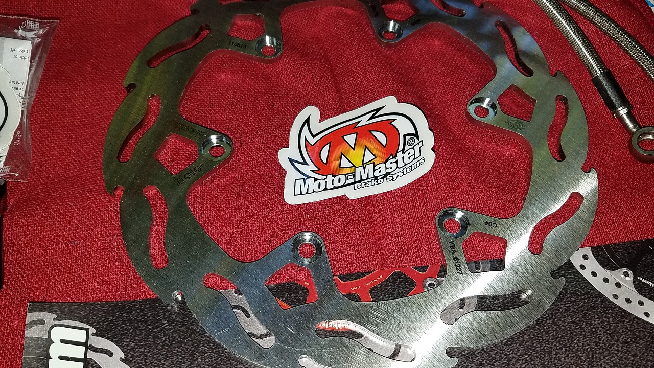

MOTO MASTER BRAKE KtX500e KX GURU RACING BUILD 103.jpg (580.07 KiB) Viewed 11006 times
MOTO MASTER BRAKE KtX500e KX GURU RACING BUILD 104.jpg (600.17 KiB) Viewed 11006 times
MOTO MASTER BRAKE KtX500e KX GURU RACING BUILD 105.jpg (563.93 KiB) Viewed 11006 times
Thanks Moto Master!!!

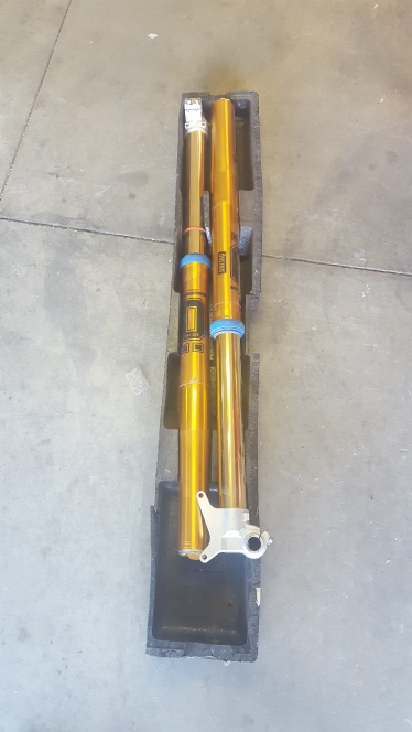

I finally have my hands on the forks.... Now I need my triple trees, shock, and GPR dampener and I should be ready to go...
KX GURU RACING KTX500E BUILD OHLINS FORKS 101.jpg (407.31 KiB) Viewed 10952 times
Yes, you are seeing it right... These are used forks with some wear...
Oh well... That's what photoshop is suppose to be for :lol:
KX GURU RACING KTX500E BUILD OHLINS FORKS 102.jpg (173.88 KiB) Viewed 10952 times

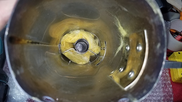

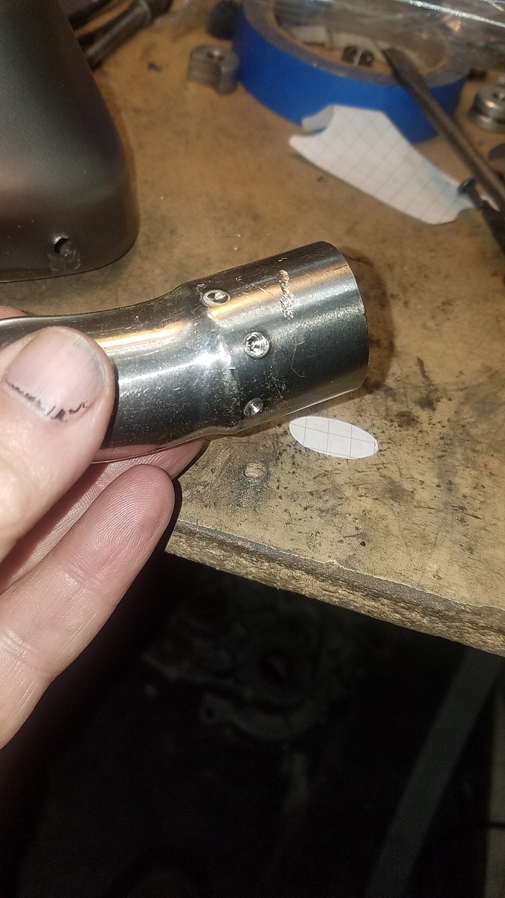

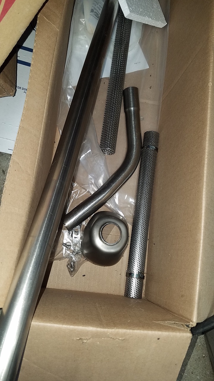

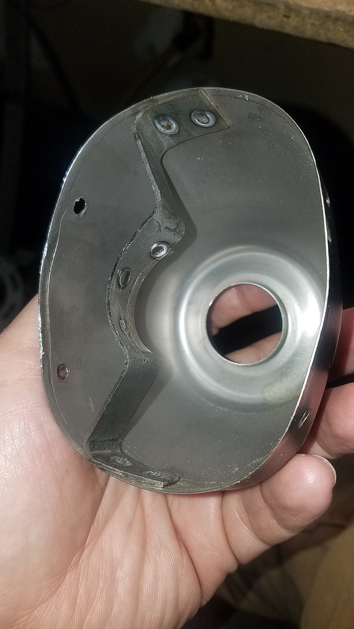

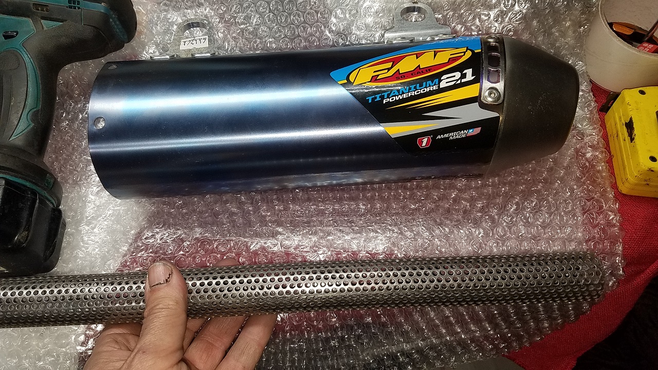

I finally got the KTM muffler pulled completely apart...
In case you don't know, I'm coring it for a KX500
KX GURU RACING FMF TITANIUM MUFFLER CONVERSION TO A KX500 101.jpg (78.79 KiB) Viewed 10942 times
KX GURU RACING FMF TITANIUM MUFFLER CONVERSION TO A KX500 102.jpg (518.05 KiB) Viewed 10942 times
KX GURU RACING FMF TITANIUM MUFFLER CONVERSION TO A KX500 103.jpg (358.78 KiB) Viewed 10942 times
KX GURU RACING FMF TITANIUM MUFFLER CONVERSION TO A KX500 104.jpg (288.24 KiB) Viewed 10942 times
KX GURU RACING FMF TITANIUM MUFFLER CONVERSION TO A KX500 105.jpg (310.01 KiB) Viewed 10942 times

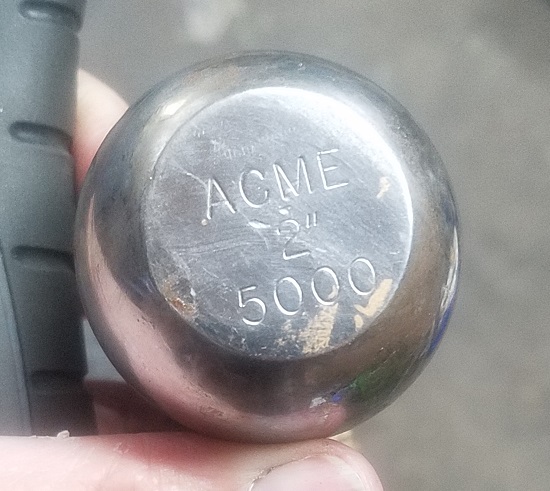

I'm putting the races back in the frame.
I don't have any special tooling :(
But, I do have a old 2" trailer hitch ball that is a nice fit :lol:

Good old ACME 8-)

Ah... one other point.
I actually pushed in the races and then later decided that I should take some pics...
I put a rag between the bearing race and the ball before I started driving it in.
Also, look at the hammer I used, it is tiny... And I don't wack it... small taps drove the races in with no issues.
After I was done I inspected the bearing surface and there was no damage at all.
I have used this same procedure many times in the past with no issues.
It would have been better to put it into a press and use a socket or a slightly ground down race to press it ini.
But I knew I could do this and it was quick and easy 8-)

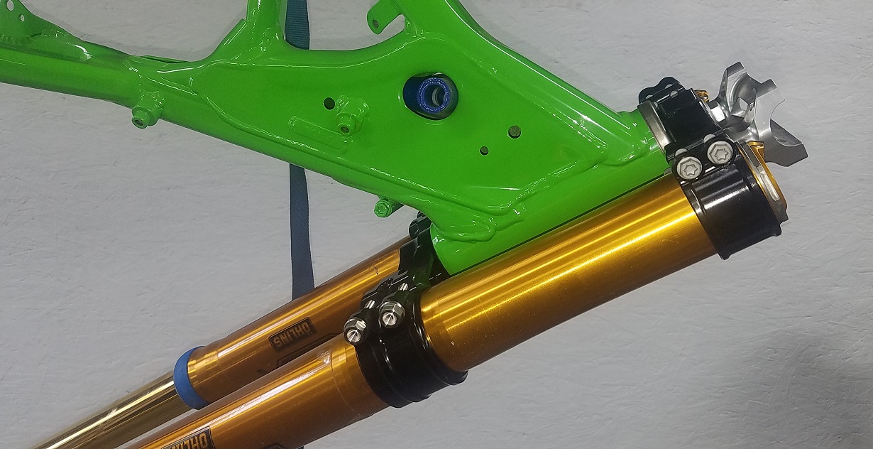

Mocking up the front end..
KX GURU RACING KTX500E 200.jpg (247.37 KiB) Viewed 10851 times
KX GURU RACING KTX500E 201.jpg (370.88 KiB) Viewed 10851 times
