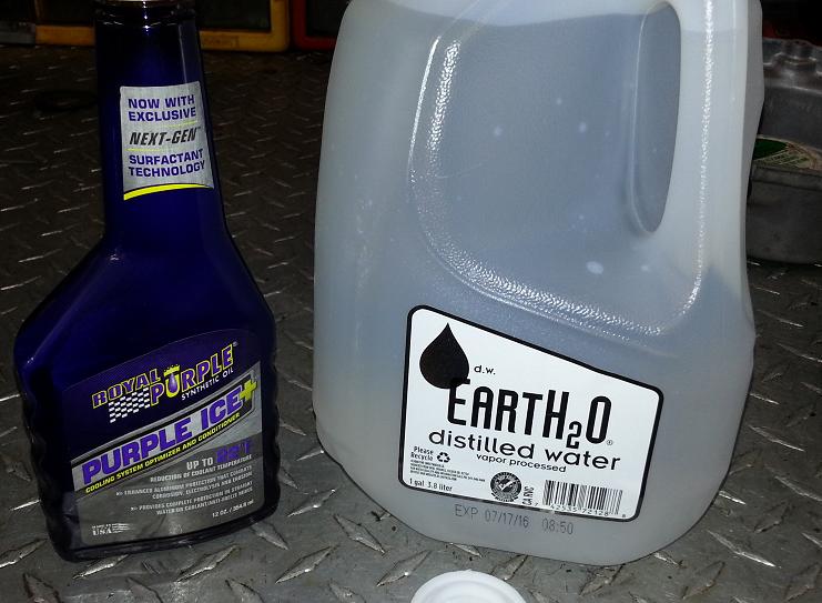

Purple Ice before mixing...
Royal Purple Purple Ice 1.JPG (59.7 KiB) Viewed 34398 times
I am going to use the race mix at 2 oz per 1 quart of water.
If I didn't maintain my bike so well... Cough Cough... I would add 20% green stuff.
Since the race mix is good for 15,000 miles I'm sure it will work just fine for me :D

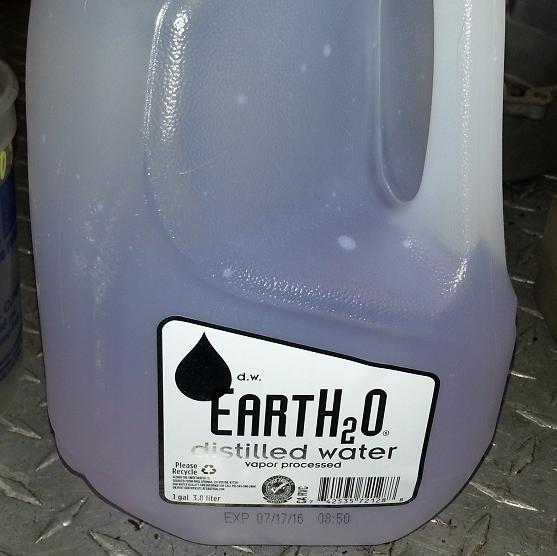

After mixing:
Royal Purple Purple Ice 2.JPG (37.99 KiB) Viewed 34398 times
Not much of a color change but what would yo expect at 1:64 ratio :D

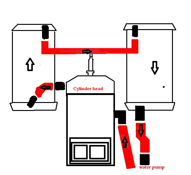

I was asked about radiator flow direction so I figured this was a good spot to throw in a flow chart.... Pun intended... :shock:
RADIATOR FLOW.png (7.3 KiB) Viewed 34251 times

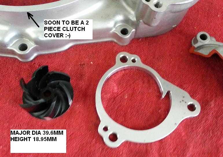

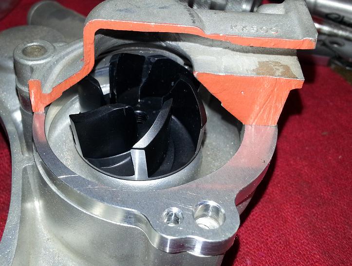

New impeller :o
KX500 COOLING 101.JPG (69.9 KiB) Viewed 34001 times
KX500 COOLING 102.JPG (83.62 KiB) Viewed 34001 times
