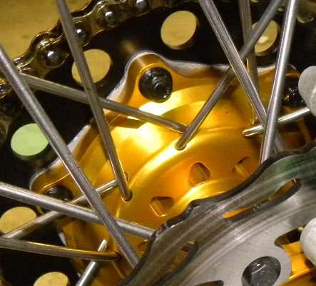

Installed...
KX500 SUPER MOTO REAR WHEEL SPACER .120 THICKNESS -1.PNG (428.62 KiB) Viewed 11747 times
KX500 SUPER MOTO REAR WHEEL SPACER .120 THICKNESS -3.PNG (322.44 KiB) Viewed 11747 times

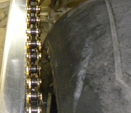

No clearance issues now.
I probably have .015" clearance between the tire and the chain.
I'll be watching the sprocket bolts very carefully to make sure there is no problem with them coming loose.
Yes, I used thread locker and torqued them but better to be safe then hash browns on the highway... :o
I looked at my bike today... then walked away...
