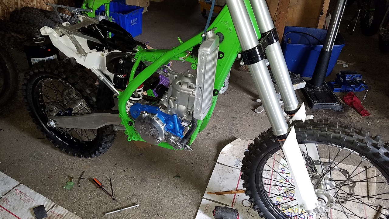

As soon as the pipe gets here... hopefully this week, I can do a final mock up... take some pics.... then if everything fits good I can disassemble and send the frame off to the powder coater for some Kiwi green and clear coat 8-)

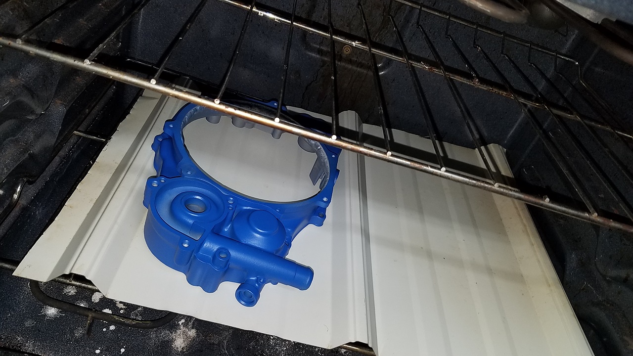

I finally got my Cerakote gear set up and decided to try some color.
So what better part to try it on then my back up 2 piece clutch cover... :o

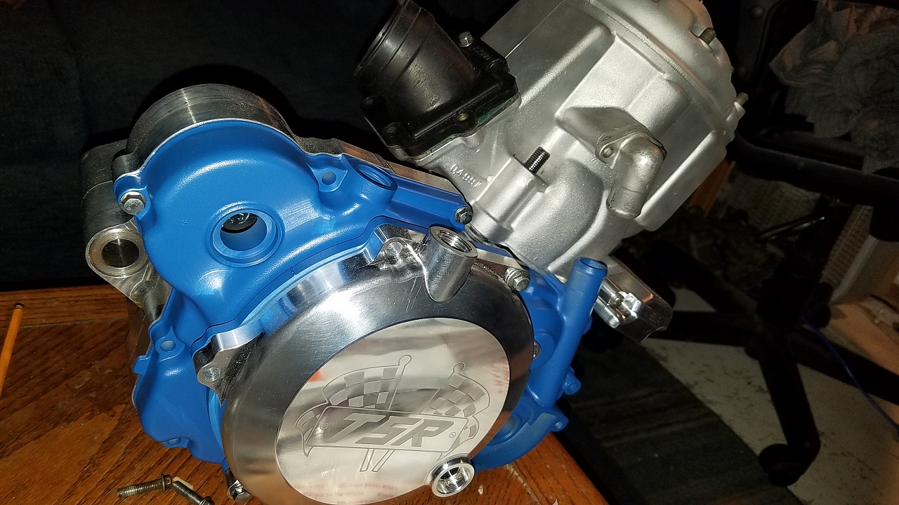

Posted: Mon May 14, 2018 4:19 am
As soon as it cooled off enough... I had to see....

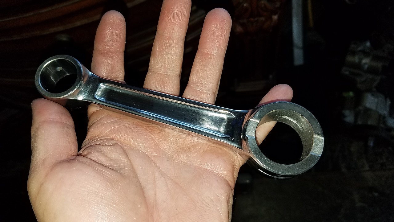

Since I don't think we will have the Turbo Crank figured out for the 500 in time for this build to be completed, I'm building a new crank...

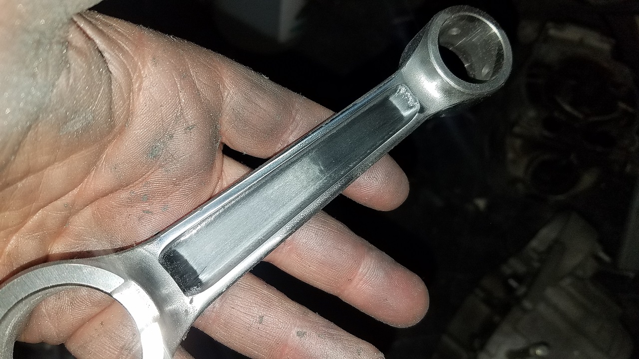

Getting the pre polish done..

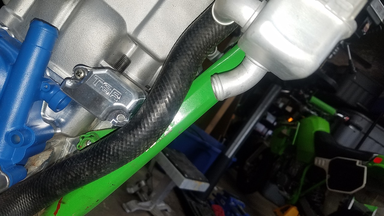

I'm also double checking all the fittings and clearances...
This side is tight but has just enough clearance...

Final checking before disassembly and powder coating..

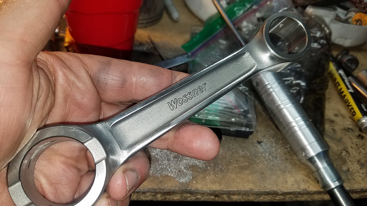

The rod is almost ready..
