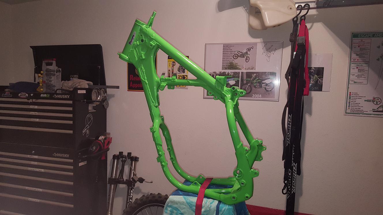

Since we did not have time to powder coat the frame before Day in the dirt we are doing it now..
Just back from the powder coater..
Drop in one clean engine....
