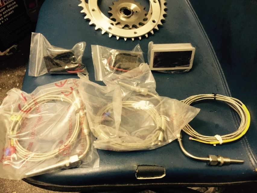

Whatever way I end up joining the carb to the engine I am going to have to mount the MAP (manifold air pressure) sensor on it, the W/M pump pressure switch, the dump valve and the boost gauge. I have two boost gauges I thought it might be interesting to put one on the plenum too to see the pressure drop across the carb. Also another sampling device I have ready to go on, or devices, is two air temperature probes, one I am going to put on on the air tube from the turbo, the other on the adaptor between the carb and the engine, this will be to see how much temperature drop the water or W/M injection gives me, it is a potential tuning tool and a great little experiment in itself.
The third sensor is an exhaust temperature sensor, another tuning tool, will help prevent meltdowns.
If I can take my eyes off the road.
