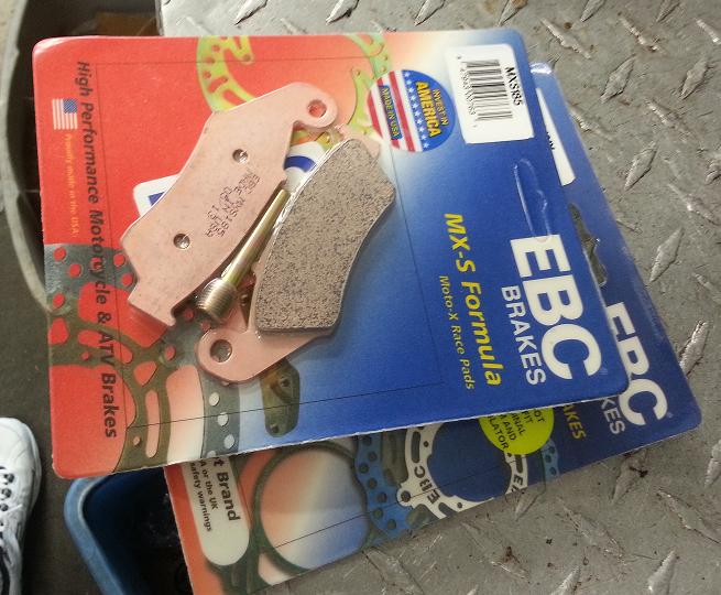

Ah, new pads.
Now my brakes might work :lol:

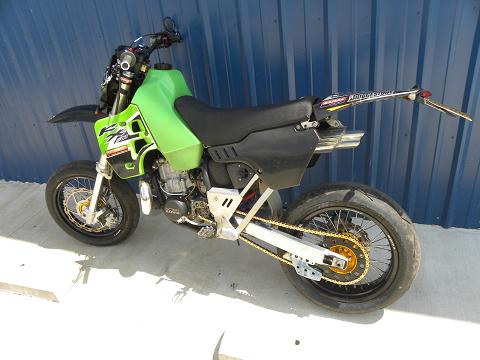

New chain and moved the axle as far back as I could with the sprockets I am running.
It does make a small difference in unintended wheelies :D

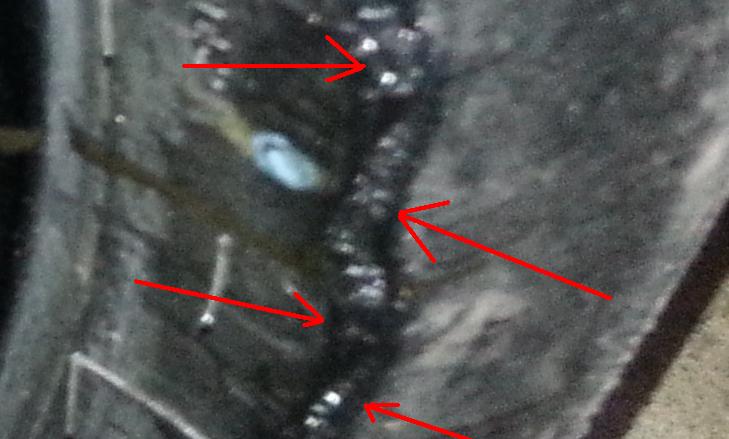

When I got back to the shop I took a look at the tire and found black greasy stuff on the edge of the tire...
Guess what it was?
Oh yeah, remember that new chain I put on?
It had a heavy amount of lube on it.
I didn't bother wiping it off.
Since the tire rubs just a wee bit on the chain it got covered in chain lube.
CHAIN LUBE ON TIRE.JPG (42.07 KiB) Viewed 10837 times
You can bet that I will finish my spacer and get it installed and keep the chain lube off my tire :shock:

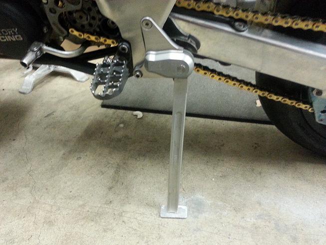

After removing 2 1/16" from the side stand you can see that it is just about right :D
KX500 SUPER MOTO SIDE STAND WITH 2 INCHES REMOVED.JPG (63.18 KiB) Viewed 10955 times

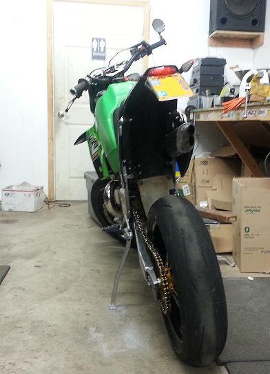

Lean angle.... Perfect...
KX500 SUPER MOTO SIDE STAND WITH 2 INCHES REMOVED 2.JPG (33.78 KiB) Viewed 10955 times

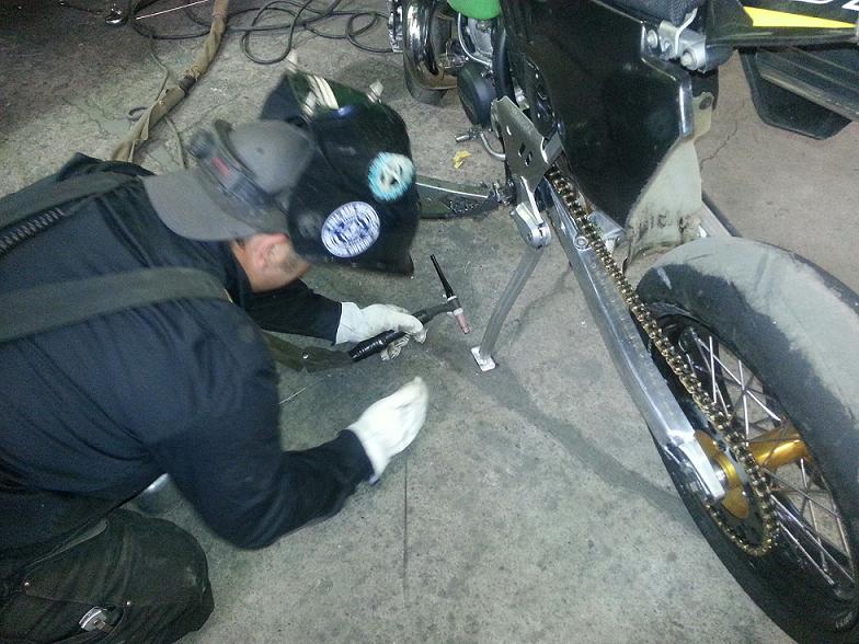

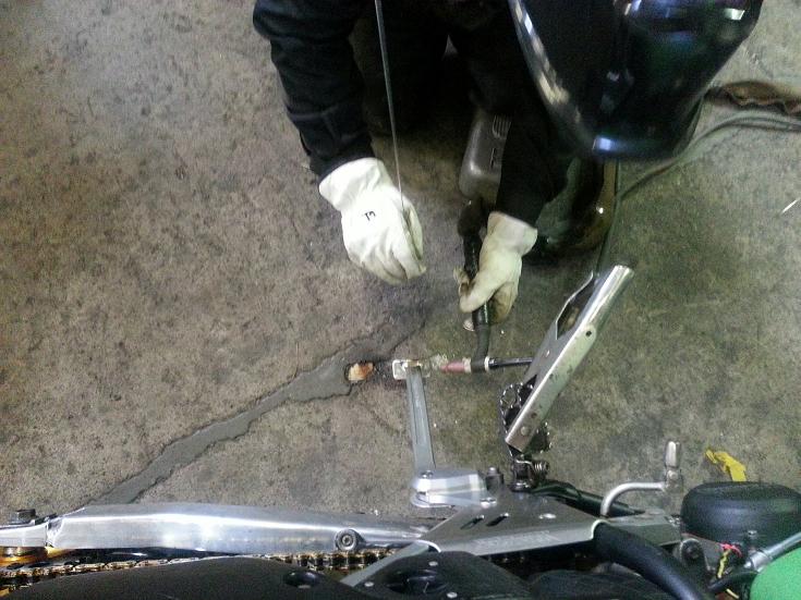

Tomorrow I'll take it to the welder and get it finished...
Next door having my buddy Trav doing some welding..
Don't say it..... Yes, I know.... The ground should have been closer to the welding to keep from frying the electronics... :shock:
What should have really happened is I should have removed the side stand from the bike completely...
