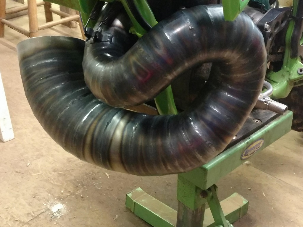

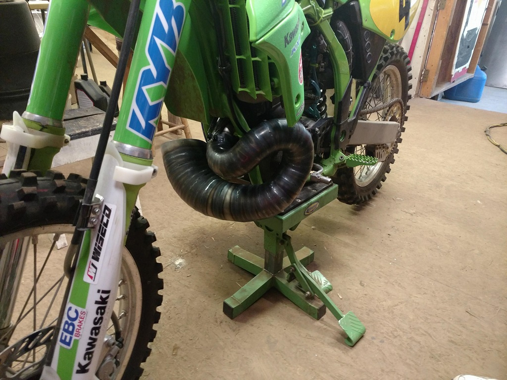

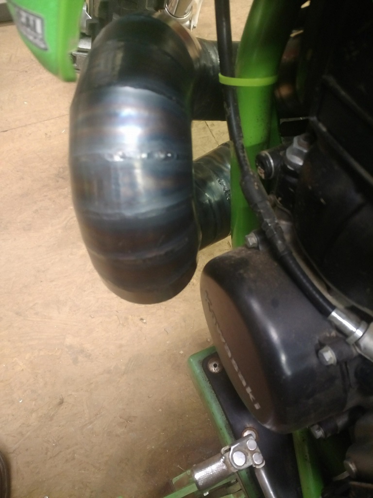

Take a look at some of the pics as it fit on the KX250 chassis..
This pipe was built and test fitted on a KX250 chassis.
The fitment and weld quality was beautiful.
We both assumed that is would be similar to the KTM 250 SXF Chassis.
It was really close, but not close enough.
If the pipe builder had the chassis this would never have happened...
Due to the distance between us and the cost of shipping the chassis back and forth this just wasn't economically feasible.
I have not been posting much for a while because I ran into some issues.
The pipe is absolutely beautiful.
And, when I test fit it, there was clearance for days.
The one thing I did not test was how well the everything worked once the suspension was fully compressed.
So, I popped off the fork caps and full compressed the pipe :shock:
And, it was fine as long as you did not turn the steering to the right.
It had 2" of interference fit :shock: :o :shock:
Yes, it made me sick because deep down I knew what was coming next.... NOOOOOO!!!!
YES!!!!!
exhaust fitment problem 4.jpg (383.7 KiB) Viewed 11660 times

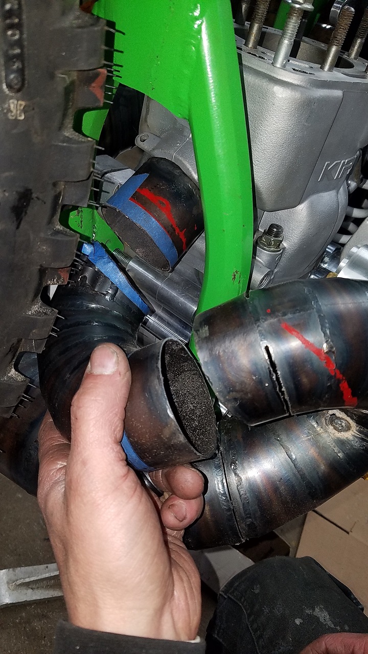

I'm not going to show how much Jason and I butchered that pipe because it was sickening.
But options were limited.
So, the pipe is all cut, tacked together, and shipped back to Growler Racing.
I know they have the ability to fix it and make it look great again 8-)

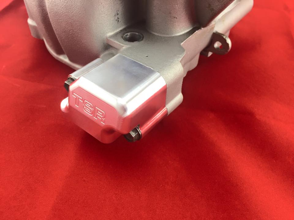

Being that it is sleeved, cutting the sub port walls out is a real pain..
I was so desperate for a aluminum right exhaust valve cover that I was going to have these pieces water jetted from 1/4" aluminum, glue them together with aluminum adhesive, then sand and polish.... Thank you TSR from saving me from myself Lol..
Thanks again TSR!!

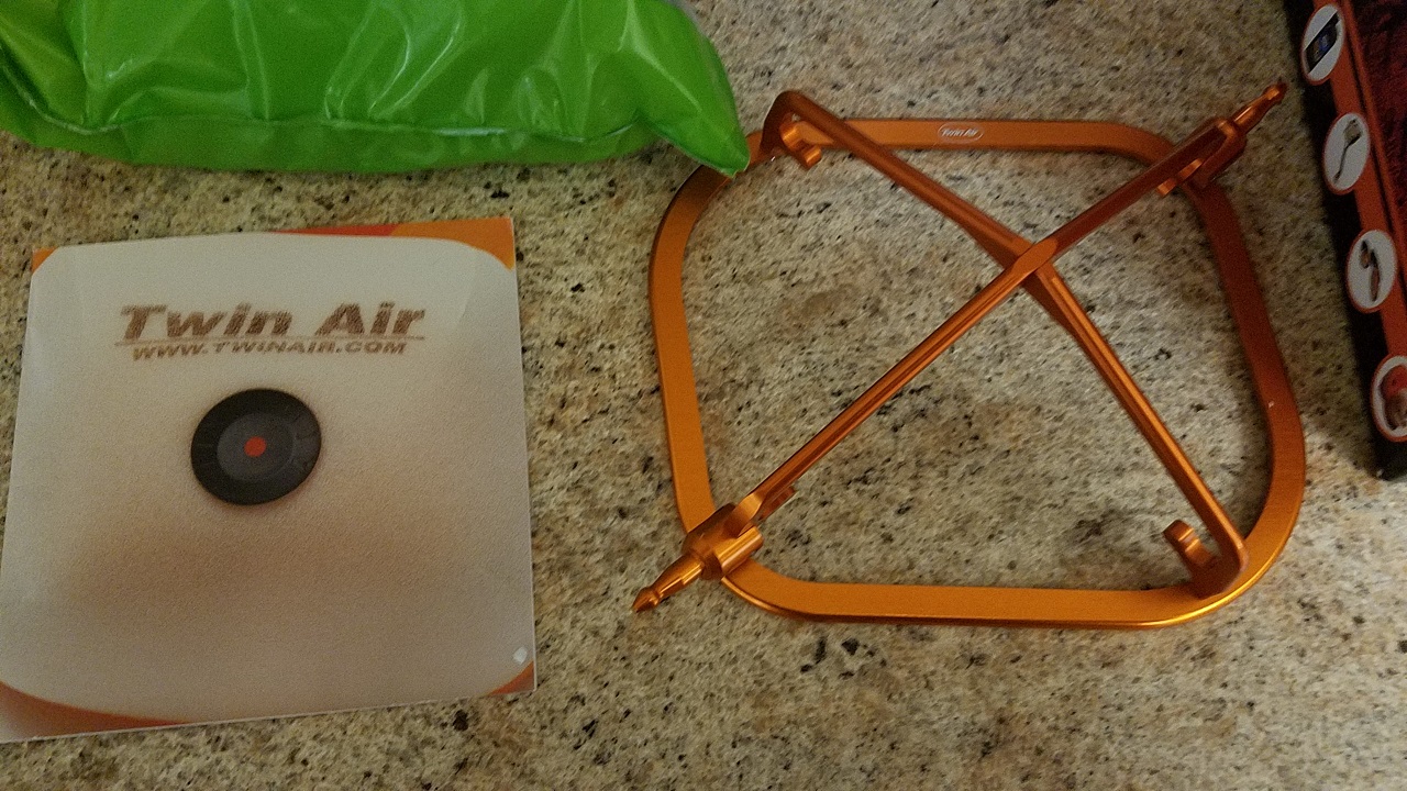

Check out what came in from Twin Air...
This will be going on the KtX500e build to be featured in MXA Magazine.

Very cool stuff.
I've never tried their coolant but I have a whole series of test's to perform this summer on two other products so I'll test this coolant as well..

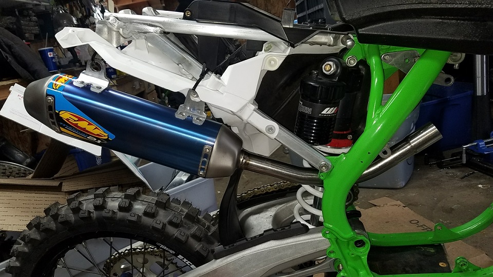

Thank you FMF for the muffler...
I will take great care of it after I cut it up a bit :lol:

Wow, perfect timing...I just went on here to get some sage advice regarding silencer selection, and here you've posted a photo of one. What I need to know is, what's the quietest silencer with a spark arrestor that I can get (or adapt) for my KX500? I'm only going to be riding trails, definitely no racing and I don't mind sacrificing some power in exchange for quiet. I have a couple of KDX200s that are real quiet, even with the Gnarly expansion chamber (stock silencer), and it would be great to have the K5 to be nearly as quiet. Maybe that's not possible?
