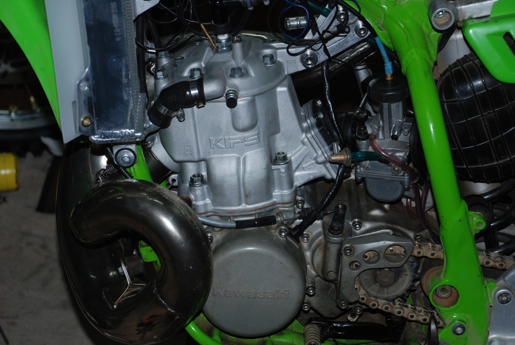

Holly crow, those exhaust ports are huge!. Looking good

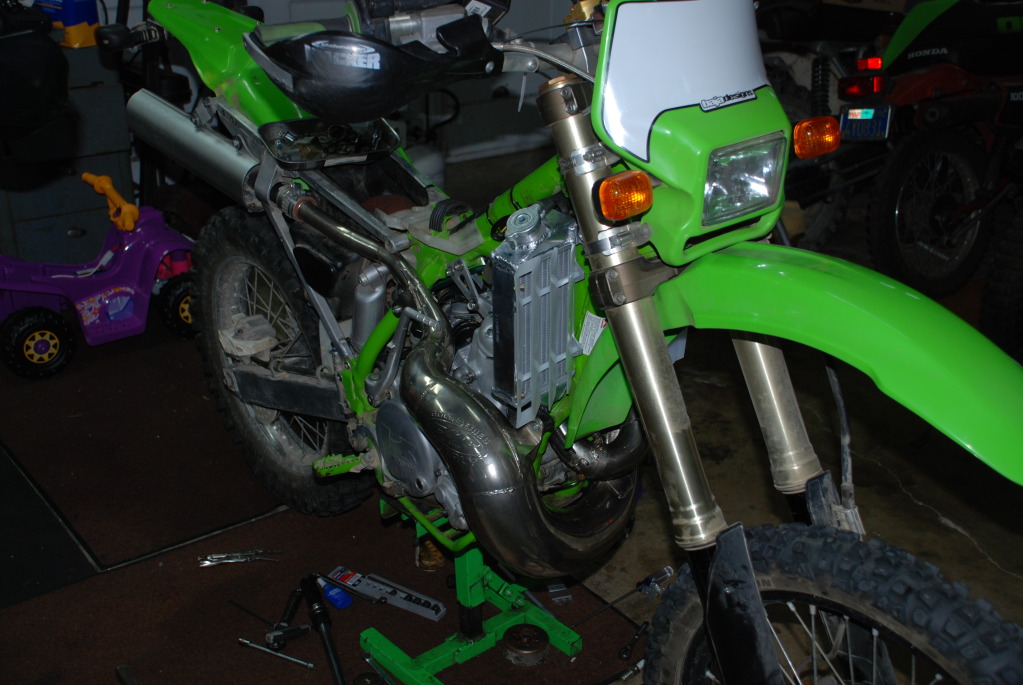

81cr450
Where did you get vf2's ? & I really like that zipty trick for the rings. Also did you have to cut your pin length down?
Motorrad
V2's came driectly from Moto tassari... after I bitched a bunch about their V3's.. (You can get them at OEM-CYCLE.COM)
Which pin.. wrist pin, or head pin.....

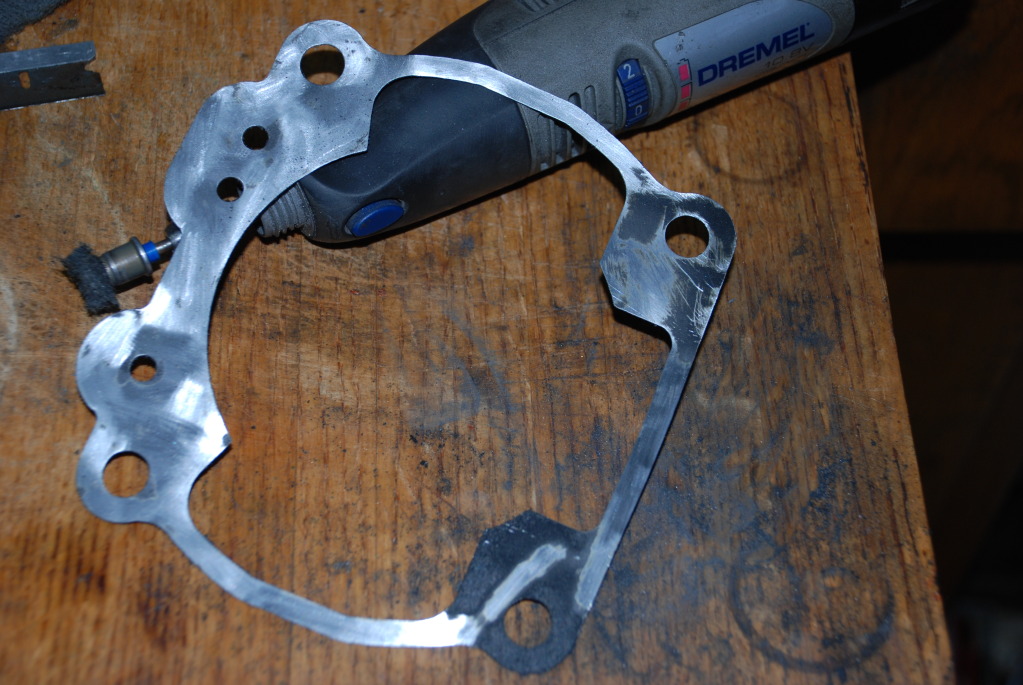

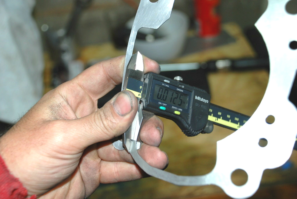

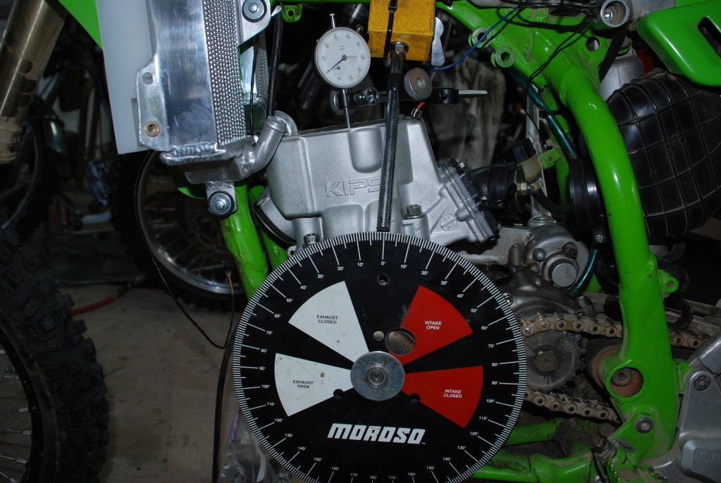

After sticking the Mitatoyo guage on the deck.. and a degree wheel on the PORTS... Decided I needed a bit more UP on the jug.. but stock .020 gasket was too much...
Soooo.. I took all the gasket material off one side of the gasket.. (it is going up against another rubberized gasket, so no problem with seal). and whala... exactly where I needed..

Deck hight after Gasket fix.. Positive .005"

Are you running 1.5 base gaskets then, since you shaved off some of the one to make it thinner?
Motorrad
Technically there are 2 normal base gaskets, the one I modified, and one more spacer of undisclosed thickness (trade secrets)..
so... there are 4...

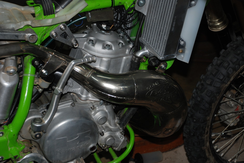

Are you building a custom pipe for this beast, I hope?
Motorrad
Yes... as soon as I get back from my 6month long motorcycle ride

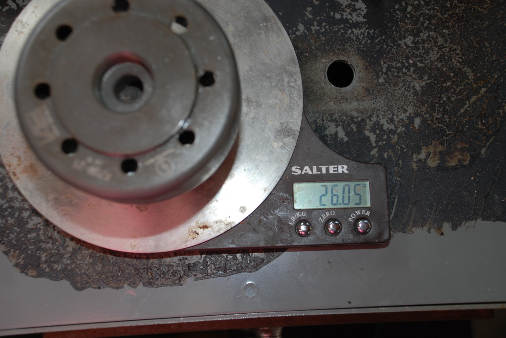

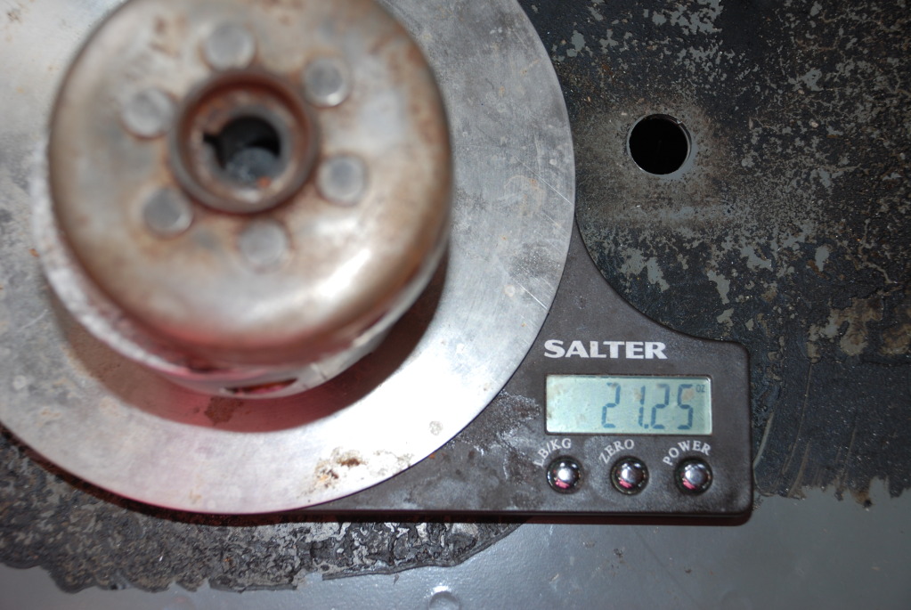

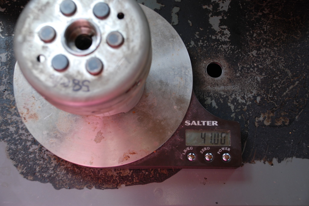

jgturbo
Are you planning on lightening the flywheel?
Motorrad
Going to run the 26oz MZB one... so roughly 1LB less than stock...
jgturbo
What's your reasoning behind a lightened flywheel? I've got an opinion on the subject, but I'd like to hear yours first
Motorrad
Simple.. It's Easyer to add weight that remove it...
That being said.. I like the light one for when I'm on the supermoto track.. Or the street. (remember my bike is plated)... As it comes out of a corner like you shot it out of a cannon evil
In dirt.. I have enough (ward) flywheel weighs cut to add 2.5 lbs to my setup... Half a lb at a time... (when I trail ride it durring summer, I LOAD HER UP)
Weight on my old flywheel New ones are still at work

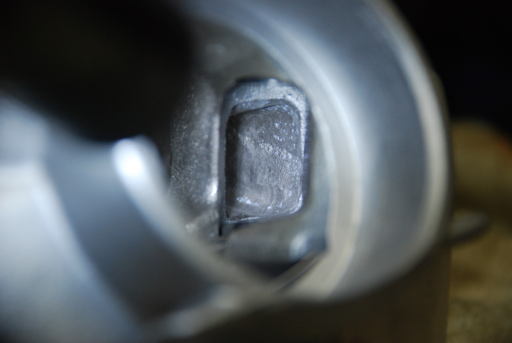

P.S. Can you find whats wrong with this picture... that I noticed the second I dropped the head on...

alward25
you have a pin in the head and cylinder, is that the "new' squish angle?? Need Cometic to cut a new gasket for you
Motorrad
The new 180 Degree compression release modification.

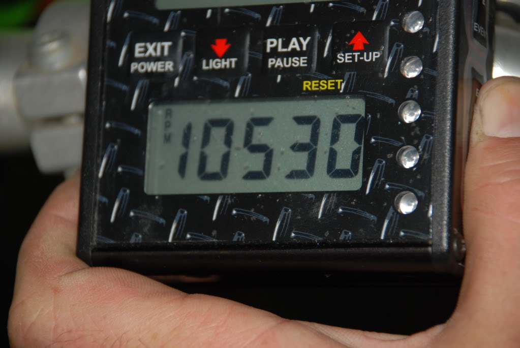

Will it do 10K rpm ??
Motorrad
It did before.... with less port timing... and more "corrected" compression...

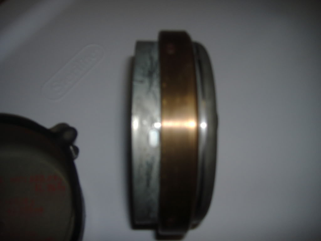

heat cycle #2... what I thought was left over coolant from bleeding head... wasnt.... wheeping coolant from head...

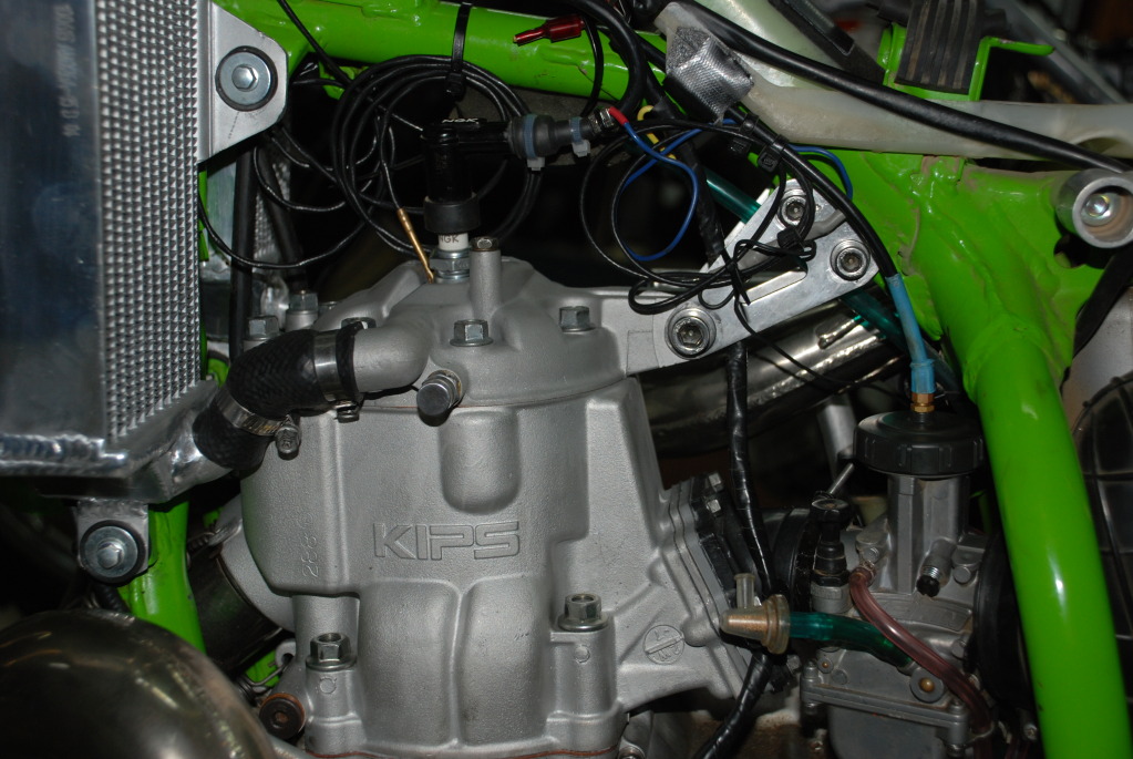

Head is off. On bench..
I already knew what the problem was before I took it off.... (somthing I was going to do before I put it together. but didnt)
confirmed it..
Walking out the door RIGHT NOW... to my grandmothers 89th Birthday party..
will post more later... and take pictures of how to fix it..
RoostDaddy
my guess would be to heat the copper head gasket first. Or throw it away and use a Cometic S/S
Larry Wiechman
Dowel pin bottomed out?
jgturbo
How are you sealing the copper head gasket? Got a stainless o-ring and matching groove for compression and some sort of goo (hylomar works wonders) for coolant?
Motorrad
Head studs pulled a bit of material...
I normally countersink them... But didn't this time... Being in a hurry bites ya..

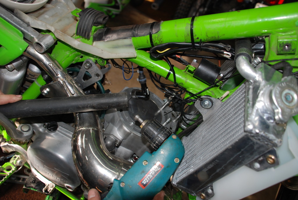

Motorrad
Okay... Like I said... I normaly do this... for some reason or another.. I didnt this time... so I get to do it with the motor together... rolleyes
shopvac and a 90 makita is your friend.
