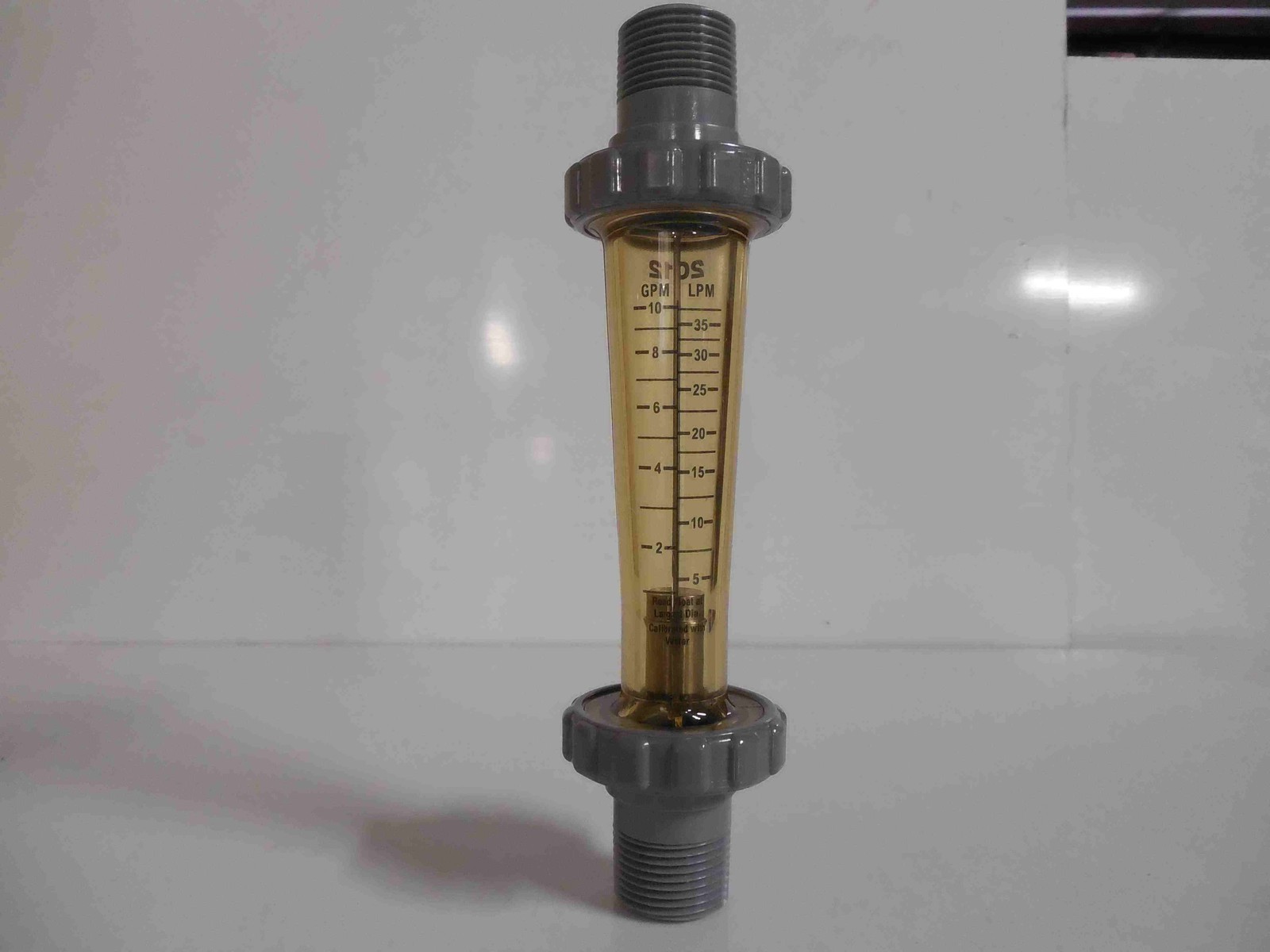

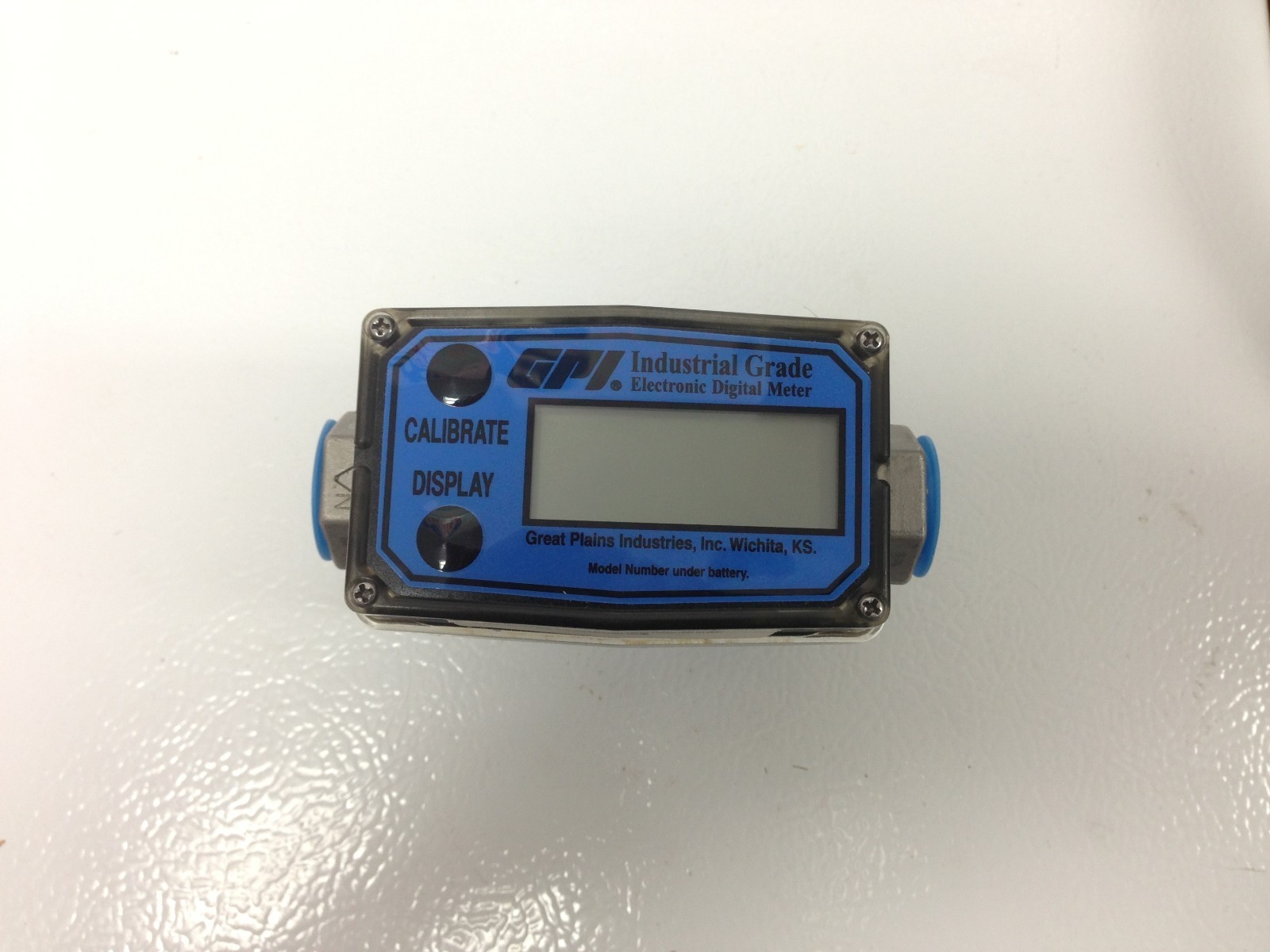

Posted: Sun Oct 13, 2013 4:04 pm
Motorrad came up with another good idea..:
so. Ive been thinking of a good way to test this without possibly hurting parts.
how about this.
2 5gal buckets of water. a clutch cover, with hoses hooked up, and a drill on the back side. time how long to move water from one bucket to the other?
can put a ball valve at one end to simulate restriction for testing also...
just trying to come up with a K.I.S.S method.
I think this is a great idea.
So I added the following:
Hey, that would be cool.... cheesy
I'm wondering.... Could you do basically the same thing but even more realistic by removing the inner clutch cover while leaving the hoses hooked up and using a flow meter in line somewhere? That way you could maintain a closed loop system with all the stock or modified restrictions...
Thoughts?
