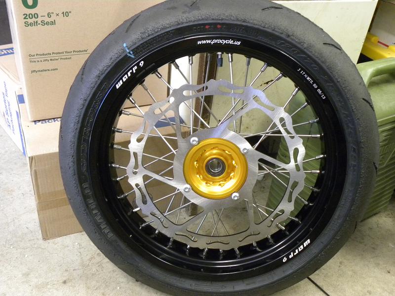

How about some Pirelli Diablo Supercorsa's.
Front 120/70 ZR17
Rear 160/60 ZR17
I know... The rear will rub...
I didn't want a 160 in the rear, I wanted a 150.
My tire guy said he couldn't get what I wanted in a 150... (Cheap but awesome, actually trade)
I measured it at 155mm.
I measured what is on my bike right now and it is very close.
I guess we'll see when I get it mounted.
Unfortunately it won't be till next week as too much is happening right now..

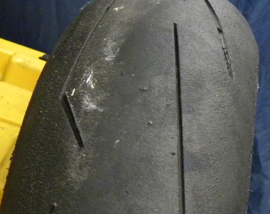

These were mounted on a bike that took a couple of laps.
Still tons of life left :-)

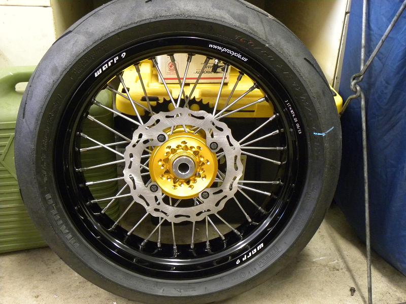

Started playing with the rear wheel fitment...
It's tight..... I'm going to switch to a non O-ring chain...

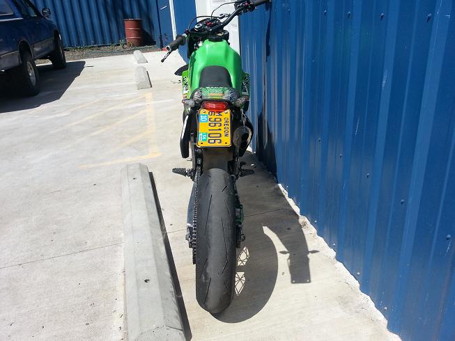

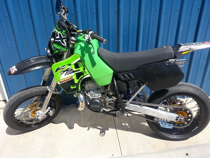

Ok, After getting the wheels on the bike I measured the highest part of the seat at 38.5".
The lowest part of the seat is at 35.5".
Taking it for my first ride with the new tires on it... :-o
Simply Ridiculous 8-)
