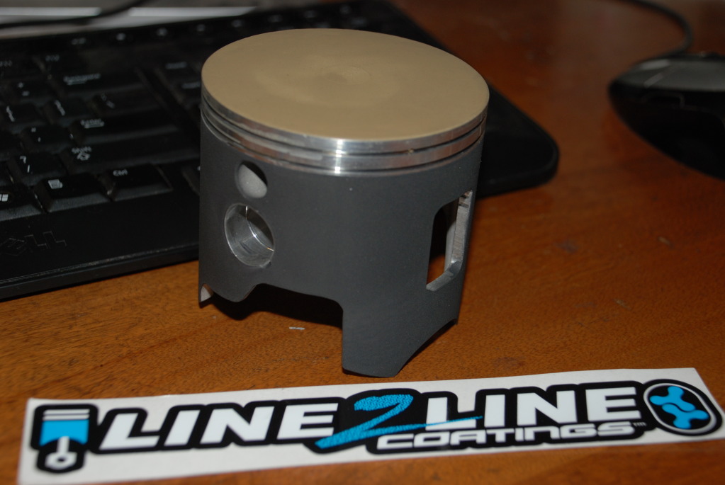

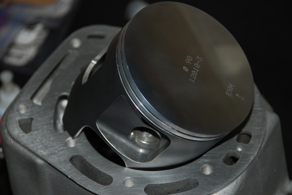

piston back from getting coating done..
skirt coat is .0035" thick.. for a .0005 (yes I said half a thou) piston to wall clearance...
way the coating works, is on its "break in" it clearances itself to the "perfect fit".. then LASTS..
I had a hard time believing them also, but my last piston proved it worked...
and also Ceramic coated crown... (Gold color) for that extra "Bling"
Motorrads Jeff Wards Engine build round 2 9-9999999-2.jpg (135.32 KiB) Viewed 7815 times

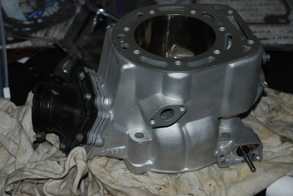

Got my Jug back..
just went to check ring gap..
undecided Hmm the rings arnt supposed to have a negative gap (overlap themeselfs)... undecided
So I think to myself.. Okay. this is better than the "Grand Canyon" rings they put in the last 5 ring sets I had...
so I break out my bore guage..
Hmm
87.75mm okay so they blew it by .25mm to start... THATS 10 f**kING THOU!
why cant any one do good work anymore!?
Especially with a name like ERIC GORR.. If they dick up somthing as simple as making a Hole a specific size.. (by 10 fing thou) makes ya wonder how bad they would dick up other stuff..

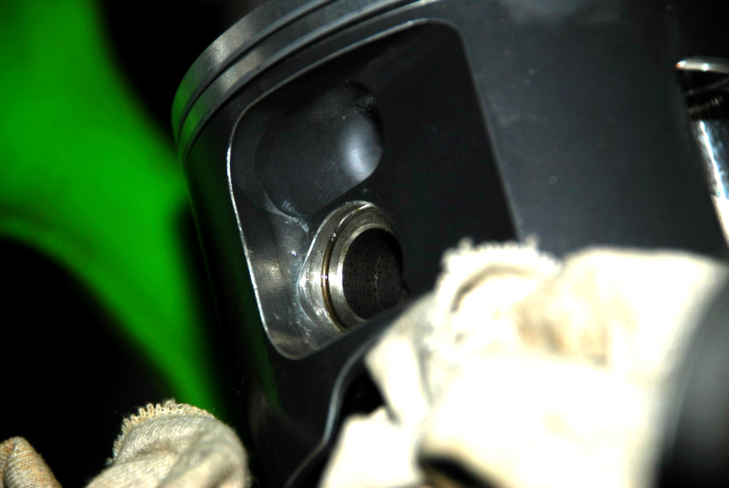

Got my DLC coated Titanium wrist pin back in the mail today 8-) evil evil
went to snap an pic for ya.. and camera is dead... will get a pic up as soon as camera is charged
Larry Wiechman
I don't want to be a buzz kill, but I have a hard time believing that a Ti wrist pin will coexist with a needle bearing, regardless of coatings.
It works in 4-strokes that have a bushing or other plain bearing in the small end of the rod.
Lots of surface area to spread the load in that design.
A caged needle bearing offers only line contact, resulting in extreme load/area ratios.
The rolling element bearings need a hard, stable surface to be compatible. DLC is hard, but titaniun is not.
Motorrad
I too.. think the same thing larry..
I had a long conversation with the company that did the coating (not naming names, incase it doesnt work out) ... but they are one of the main titanium wrist pin supplyers (DLC coated)...
they said they do alot for guys running needle bearing setup, "drag race and hill climb guys".. he said they arnt having problems, BUT are rebuilding motors very often... so problems may not show, like a high milage motor like mine..
so I... for the sake of science.. have decided to give it a shot..
I ... NEEDLES TO SAY.. will be tearing top end off frequently to keep an eye on things...
but.. Im still on Your side of the fence Larry... undecided Very sceptical...
he also told me the wall thickness etc We are using is WAY WAY overkill..
Few pics... Trying not to give away any trade secrets, while giving you all good pictures... grin
Im not sure what he does to the kips parts... but WOW! Mine looked like s**t before I sent them to him..
YES I ran the piston over the buffer.. not him.. as well as my usual skirt mods...

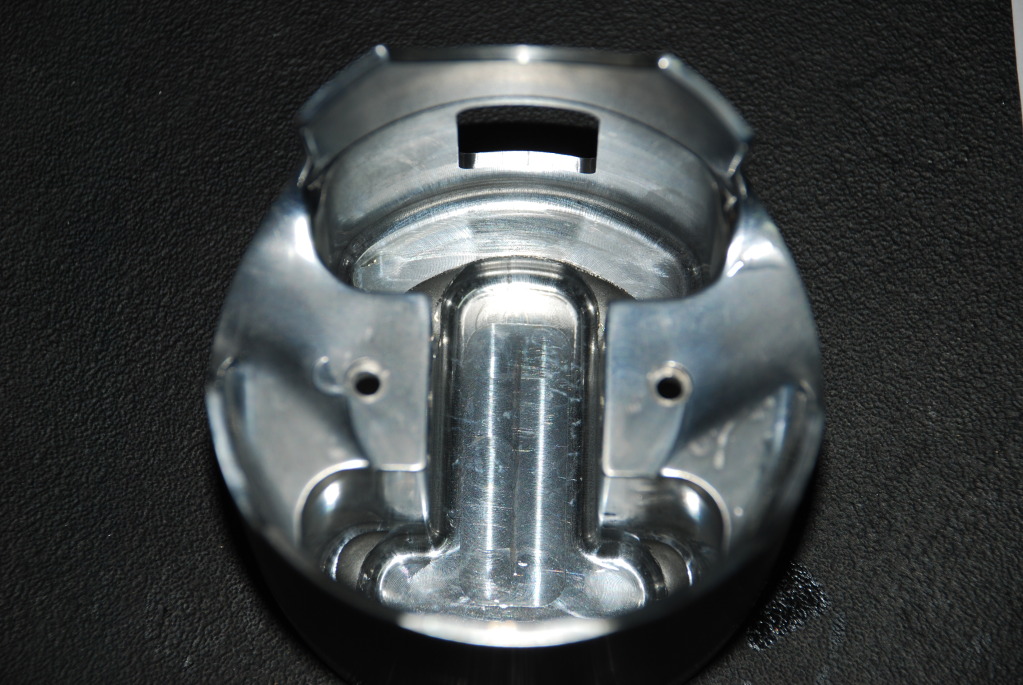

After some cutting... grinding... drilling.... (wossener comes with oil "slots" not oil holes... I decided to add oil holes as well grin
Motorrads Jeff Wards Engine build round 2 9-9999999-6.jpg (205.21 KiB) Viewed 7800 times
done cutting on everything..

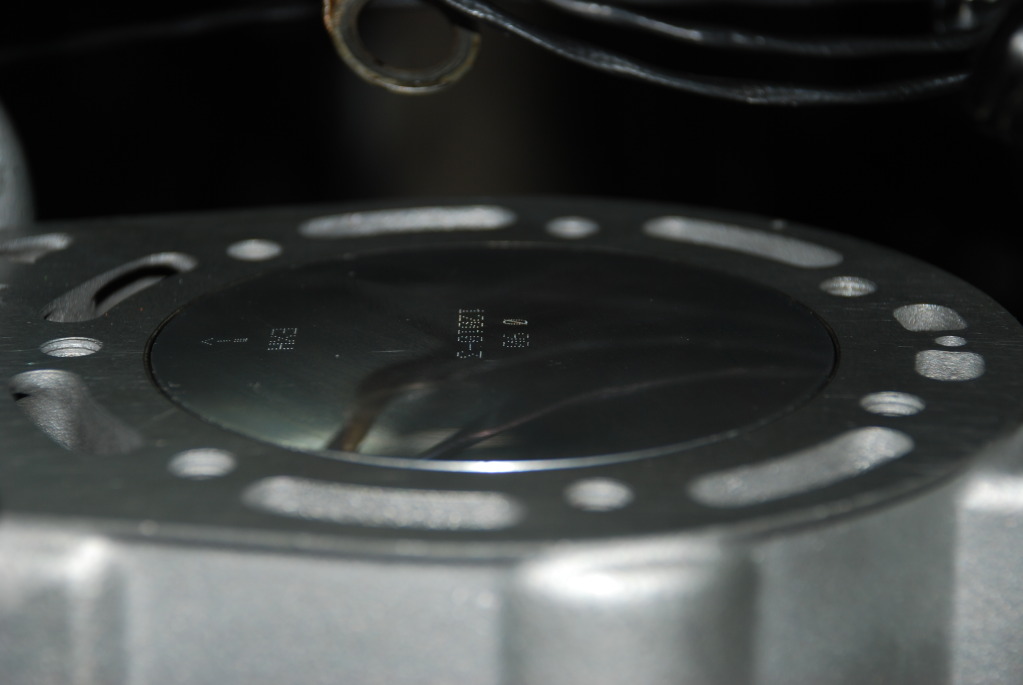

ZERO Deck Hight .... Ohhhh Yea.... always wanted to build a zero deck motor..
