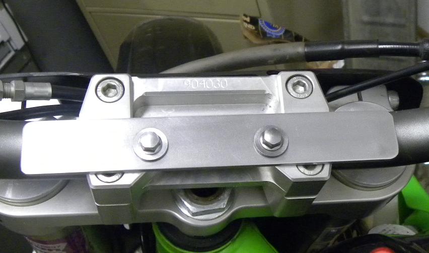

I made a simple mount out of a piece of 1/8" x 1" aluminum.
Drilled two holes and bolted it down.
temp gauges mount.JPG (51.59 KiB) Viewed 29719 times

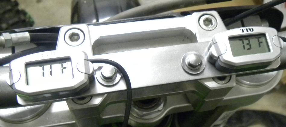

I used the peel and stick method to stick the gauges to the mount, only I did not use the tape that came with the gauges as it is too weak.
temp gauges mounted.JPG (49.77 KiB) Viewed 29719 times
I mounted these the same way I did on my K5SM, head temp on the left, water temp on the right.
It would be hard to mount the water temp on the left because they don't give you a lot of wire to work with.
Now I just need to finish the wiring and take this beast out to the dunes...

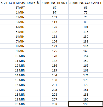

This is the first direct test of a relatively stock KX500 cooling system excluding the radiators.
They are some Chinese brand at about 30% more capacity then stock.
I am running 100% Engine Ice.
This is from start up so 20 minutes run time.
At 5 minutes I started wicking the throttle 2-3 times at 30 sec intervals.

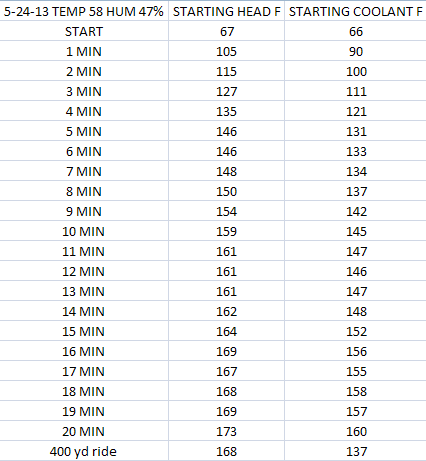

Posted: Fri May 24, 2013 10:01 pm
This is the first direct test of a completely stock KX500 cooling system with earlier black radiators.
I am running 50/50 Prestone.
This is from start up to 20 minutes run time.

Posted: Fri May 24, 2013 10:04 pm
The completely stock system heated up quicker but then stayed cooler....
Hmmm, I will have to try some Engine Ice in this system and see if it gets hotter.
If not, then I may be looking for another set of stock radiators :shock:

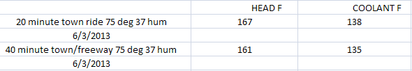

Posted: Mon Jun 03, 2013 10:52 pm
20 minute town ride 75 deg 37 hum Head 167 Water 138
40 minute town/freeway 75 deg 37 hum Head 161 Water 135
Super moto
TEMPS 2.PNG (5.04 KiB) Viewed 29637 times
Posted: Tue Jun 04, 2013 4:04 am
by Motorrad
Your numbers have me scratching my head
Posted: Tue Jun 04, 2013 4:37 am
Was it the starting temps?
I copied and pasted the header and forgot to edit it.
If it was something else, let me know...
