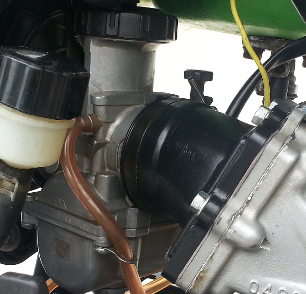

I just finished my reed and carb boot mods.
So..... it's time to bolt them on and add a 41mm carb for a top end boost.
Hopefully the weather will cooperate tomorrow so I can burn some knobs off :D
Today I installed my V-Force 2 reed at Hi-Tension setting and a PWK 41mm Pro Series Keihin carburetor.
Starting jetting:
Pilot: 55
Main: 168
Did I notice any difference?
Just a tiny tiny bit :o
No worries, it's very rich at the moment so I will need to figure the jetting out :)
41mm carburetor and v force 3 reed valve kx500.PNG (704.08 KiB) Viewed 12512 times
Ignore the yellow wire, that is for a later post ..... :lol:

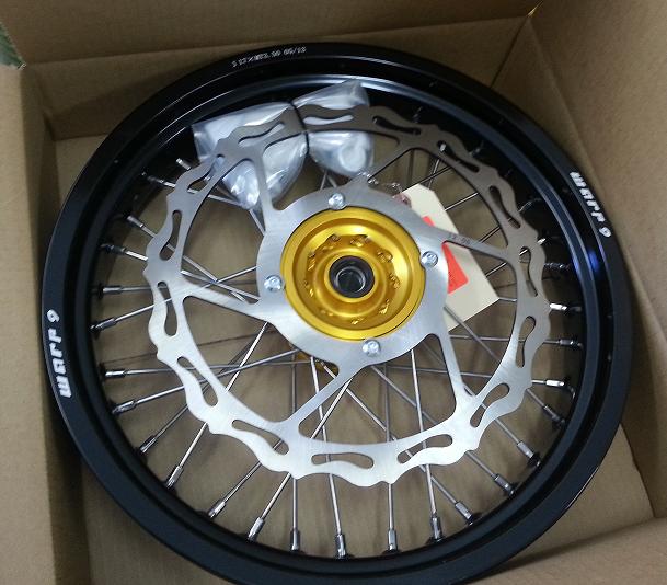

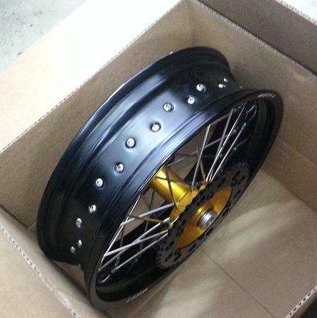

The wheels came in today.
Now it's time to get some rubber on these babies...
KX500 SUPERMOTO WARP 9 FRONT WHEEL.JPG (53.6 KiB) Viewed 12502 times
KX500 SUPERMOTO WARP 9 REAR WHEEL -2.JPG (28.91 KiB) Viewed 12502 times
